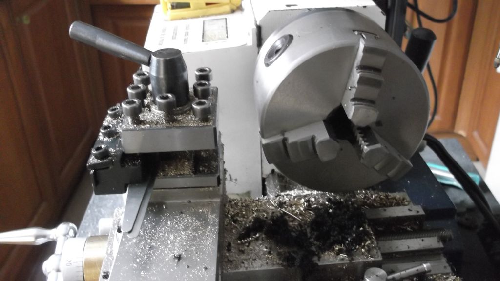

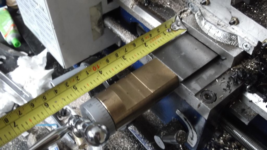

      I'll start things off~ my Mini Lathe has been fairly heavily modified & still ongoing.
      My absolute best mod was a cross slide extension. Now have 100mm travel.
      Not only can I turn up to nearly 6" dia stock without crazy toolpost manipulation, the toolpost neatly skirts the 100mm chuck for 'parking' whilst drilling etc with the tailstock.
      N.B. to date max dia turning 5" steel, boy was that frustrating, but 'm sure 6.9" Ali would be a breeze!
      Your mileage may vary, but for me #1 mod.

              You should upload some photos of your modifications, I'm mulling over ideas for my project mini lathe, I have a couple of ideas I don't think I've seen anyone else do, but these machines are so heavily modified by so many people it's quite possible someone somewhere has already done it.
              There's a young German lad with a channel called "we can do that better" who almost exclusively does videos on modifying his mini lathe, he's done a few nice additions well worth taking a look.

                                  cross slide ext 2.jpgPosted by Pete. on 03/03/2023 06:24:05:
                                  Well here's my take on the cross slide extension…. Used brass because it was early days, i didn't want to use Ali & my steel turning still looked like the machinists equivalent of a ploughed field! Hidden in there are two 10x15x4 bearings, bigger would be better but the retaining bolts get in the way rather.
