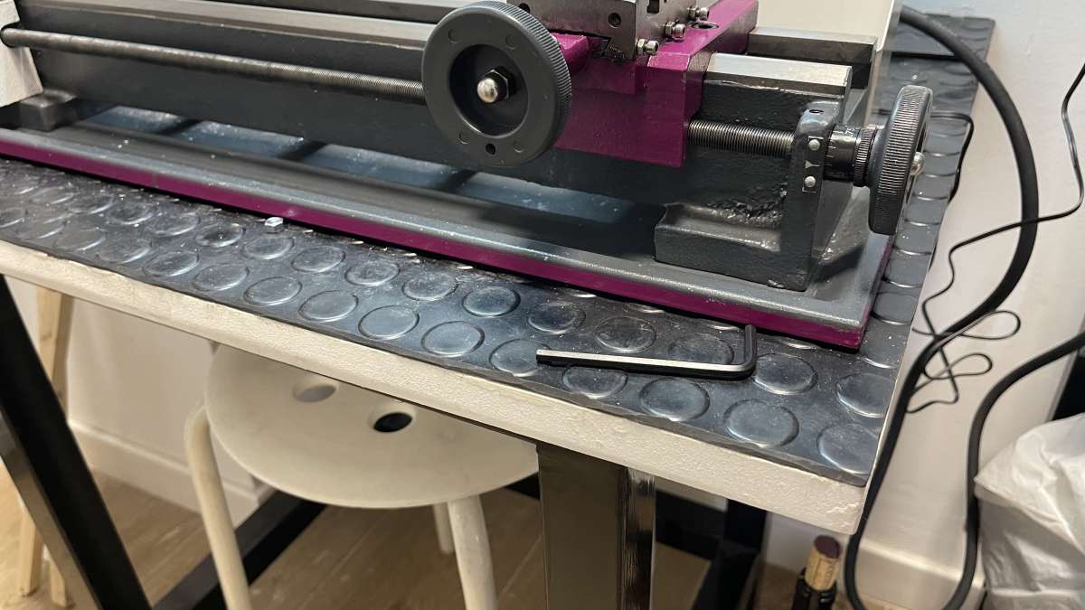

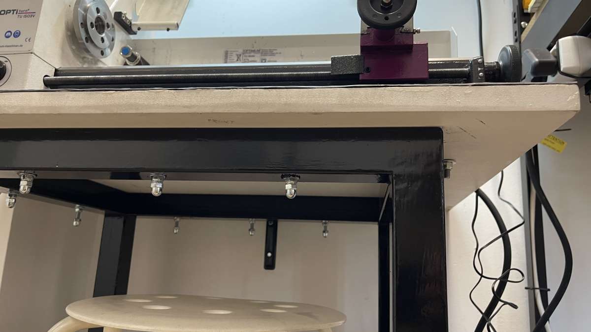

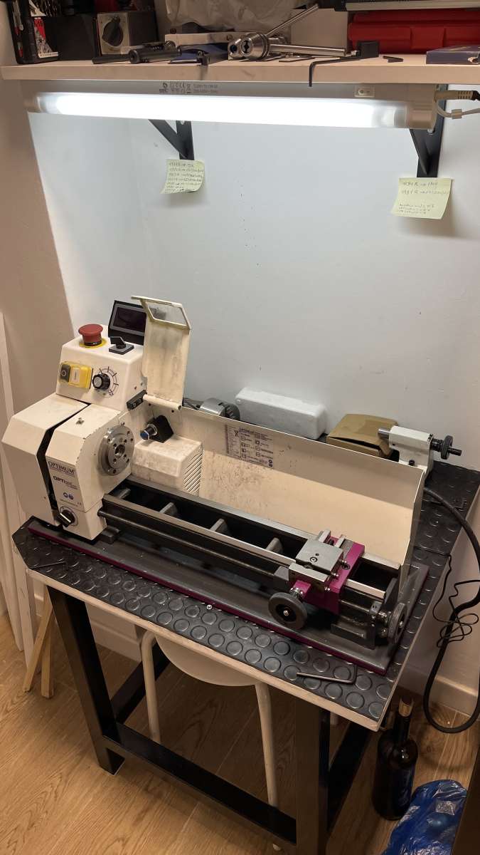

      Hi!

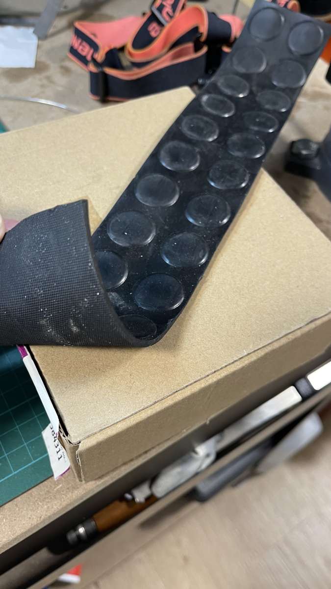

      I installed previously my Optimum 1503V mini lathe on a bench with a rubber mat between the surface of the bench and the base of my lathe.
      I read a time ago that it was good for get rid of vibrations but now I am really worry in case it could add some undesirable movements to the mini lathe.
      My question is: should I take it off of can I deal with it without having problems? (It would spend a time to remove it and I barely have it)
      Other question is that the wood that is on the iron bench is only 2,5 mm (1 inch) thick. Is it enough for a 23 kg lathe?
      Thanks in advance,
      Ruben

          The important thing about the bench is rigidity rather than strength.   23kg isn’t all that heavy, but a simple bench plenty strong enough to support that weight might wobble, side to side and front to back.    How the legs are supported matters more than the top’s thickness.
          My mini-lathe came with rubber feet, and I ran it plonked down on a simple wooden bench, rear and one side fixed to wall, with 2×4″ braced legs at the front.   As the top was only 12mm pine, I added a section of kitchen worktop as well, screwed down, about 38mm total.  It was fine.   I also used it a few times on an ordinary flimsy kitchen table;  that was OK too.
          The manual recommends bolting the lathe down for extra rigidity, but so far as I could tell doing so made no difference.  More convenient not to bolt it down, because then the lathe could be slid out of the way.
          Are you getting chatter?  If so, might be due to a wobbly bench, but more likely excessive tool or job overhang, or maybe a blunt tool or difficult material.
          PS.  Now I’ve seen the pictures, the bench looks satisfactory to me, though cross-bracing the sides and back would stiffen it up good and proper!

                The bench looks more than adequate for a lathe of that size. Given apparent welded construction and size of members it is probably stiff enough. If you did want to stiffen it up you could add a diaphram to the back and one or both sides. Basically a relatively thin sheet covering the retangular openings in the frame and firmly fastened to the box section by multiple blind rivets or threaded fasteners. This tould only be worth it if you can visibly wobble the top of the stand with manual force on the top.
                Rubber mat should be fine as long as the lathe mounting surfaces are covering multiple rubber disks.

                  At that size of lathe (5×10) you are fine with what you have. Just check the lathe is well supported by the rubber and not wobbling about on the edge of the raised area of rubber pimples (a totally flat sheet may be better).
                  As pointed out, if you can shake the bench about  by hand, you may want to stiffen, but only because it is more pleasant to work on a surface than is not shaking about beneath you. It will make little difference to the working of the lathe.
