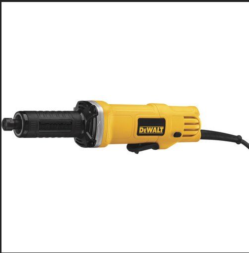

I got tired of burning out Dremel's.
They are only good for extremely light work.
I guess I burned out 3 of them.
I finally broke down and bought a tool-and-die grinder (photo below), and a carbide bit set.
It is rather a beast, and you have to really hang onto it, since it won't stop of you happen to snag it on something.
It works very well, but it is much larger and heavier than a dremel.
It really comes into its own when I use a 2" rotoloc sanding disc, followed by a 2" ceramic sponge.
The work you can do with it using the sanding disc and sponge is impressive.
It won't burn out even under heavy load.
Don't be fooled by the photo, it is big.
