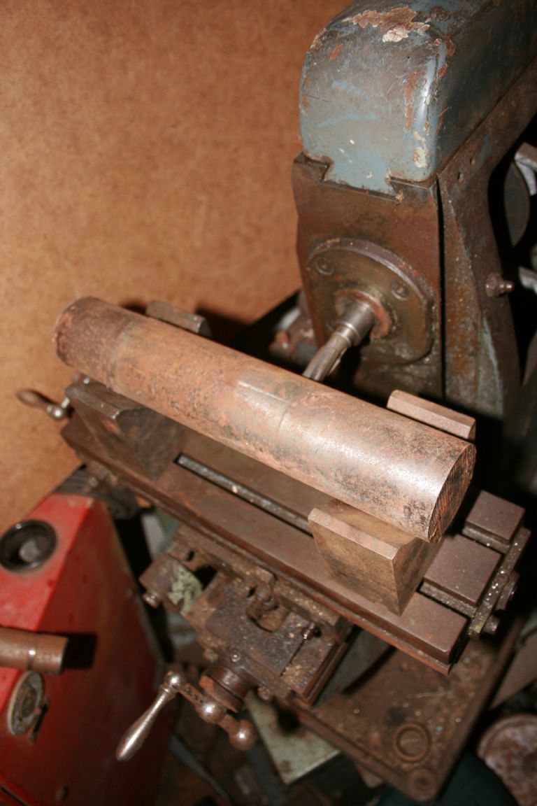

                            Hi, this paradox about end mills not been able to cut closed slots in a material has bewildered me. In a previous employment in the dept’ I was in, there was an old timer machinist. He never had any slot mills/drills and all the closed keyways in shafts that he cut were done with end mills of the finish size. I fitted a hugh amount of these shafts in my time, with keyways cut in this manner and never experenced any over size. The keyways were always clean and flat in the bottom, they were however cut on a horizontal mill with the shaft mounted so the keyway was cut on the side. The mill was a Parkinson No. 2. I’ve never tryed this approach myself, but with all that I’ve raed about not using end mills in this way, I wonder how this would have been achieved.
                            Regards Nick.

                                            Hi David, here is a photo of a mock up of the set up for milling keyways that the old timer machinist I refered to in a previous post used to use.
                                            Of couse he would have it clamped down. I can’t actualy try his method, because this machine is inoperatable at the present time.
                                            Regards Nick.

                                              just to emphasise, a normal end mill cannot plunge deep enough to cut a keyway due to the lack of cutting edges near the centre, it simply meets solid metal after a few thou.  Your friend must have used a plunge cutter with a cutting edge which extended to the centre.  They are available as specials, otherwise it was impossible.

                                                Hi Terry, this is the paradox, I’m understanding that is should not be possible and the reasons why. However, I never saw him use any thing else but an end mill when he cut a keyway with this set up and he did not have any slot drills or otherwise for cutting closed keyways. The only other cutters were the side and face cutters used on the spindle between the machine and the support arm. These of course leave the curve of the cutter at each end of the keyway, and are used over the top of the work piece. All of the cutters belonged to the firm we worked for of course, but they were of his choice.
                                                Regards Nick.
