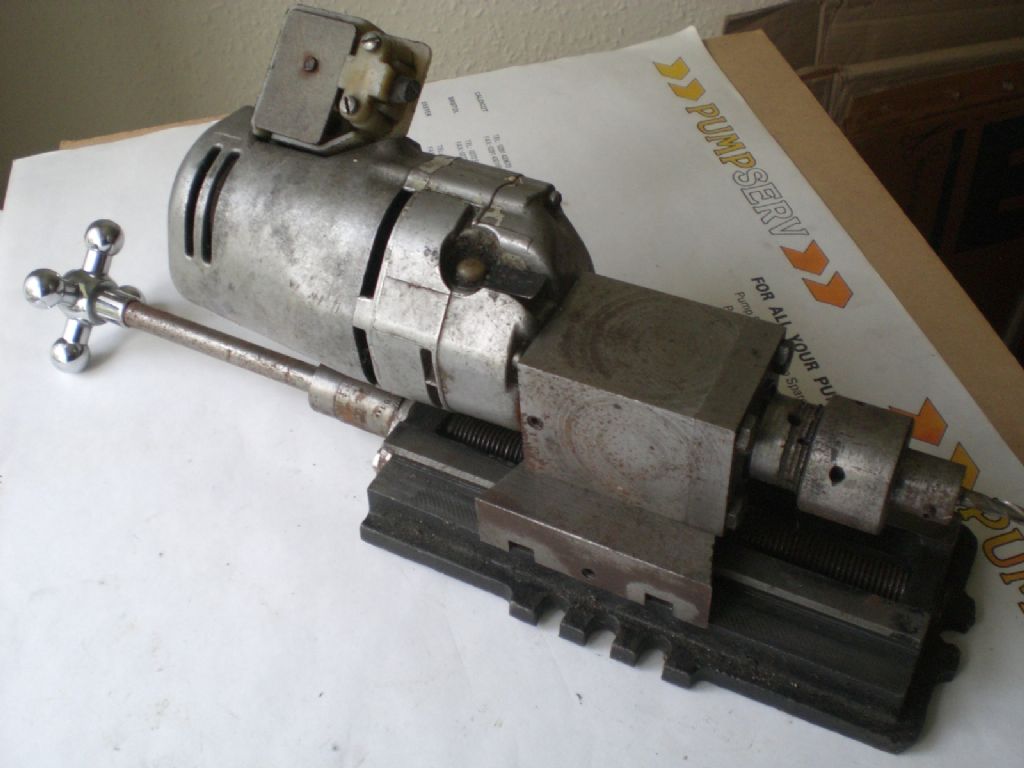

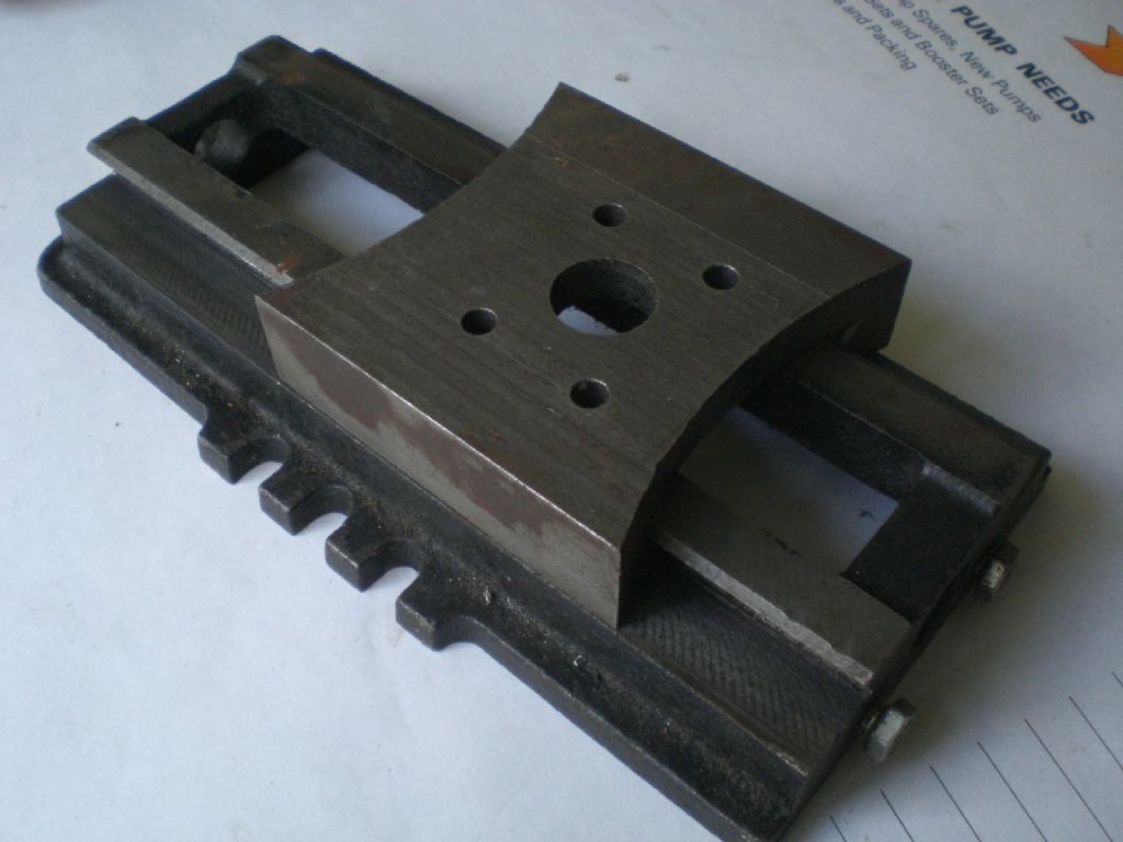

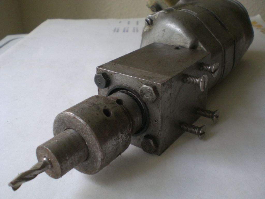

                                      Hi, years ago I made a milling head and fitted it to the base of a cross vice. Basically it was made from a motor off a worn out Black & Decker electric lawn mower and a two speed gearbox from a burnt out B/D electric pistol drill, the motor's single speed gearbox was exchanged with the two speed one and a block was made from a piece of 2" square BMS and a worn pump shaft, which had a 19mm collet on the driving end that a motor was fitted too. Some machine had to be done of course, but a taper roller bearing was fitted into the output end of the block with a ball bearing at the top and the pump shaft was fitted with a screw end matching the screw in the drill gearbox, which is shown assembled below.
                                      A new sliding piece was made to fit the base of the cross slide and the milling head was attached to it.
                                      A nut was made with an integral pin from a piece square 1" BMS with a 16mm cross thread, which fits into the big hole in the slide above and a screw was made from a piece of threaded rod and extended with a piece of 12mm round BMS and connecting bush. an old bath tap handle was used as a turn handle for adjustment of the slide and the whole assembly is shown below.
                                      A few more photos a be seen in DIY Milling Head
                                      It actually worked very well, but I did need to make a dedicated holder for those throw away type end/slot mills. If you found a good ole robust drilling machine for a song, maybe you could adapt something similar to fit onto, or replace its head. I actually used this to true up the portion of my round column Chester Champion milling machine, where the column is attached too, by bolting my it to an angle plate and hanging over the back of the table and then using X and Y to machine the portion afore mentioned and it made getting the column easier to true up to the table.
                                      Regards Nick.

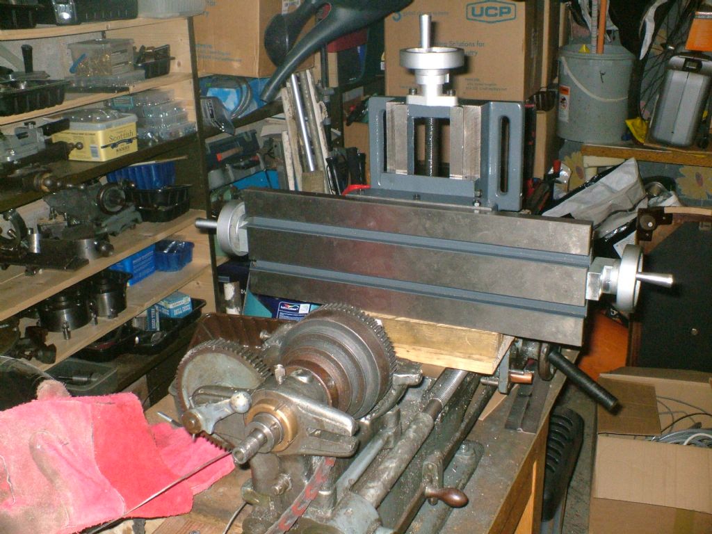

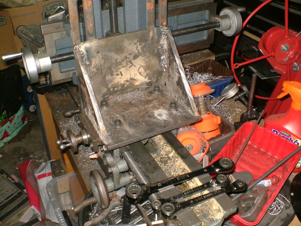

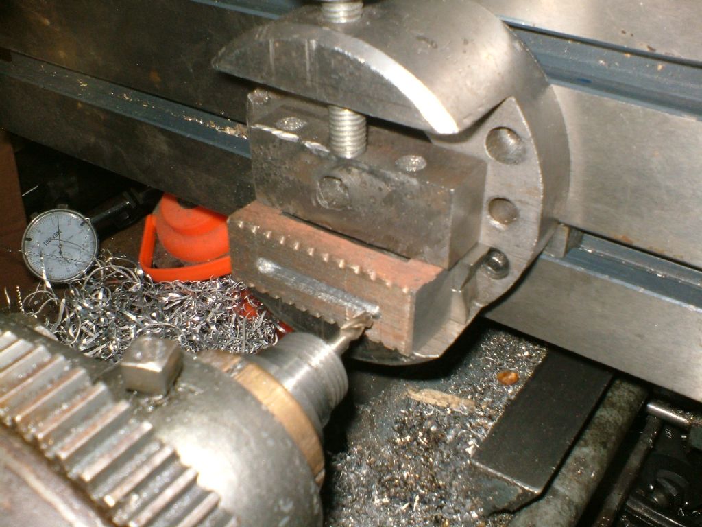

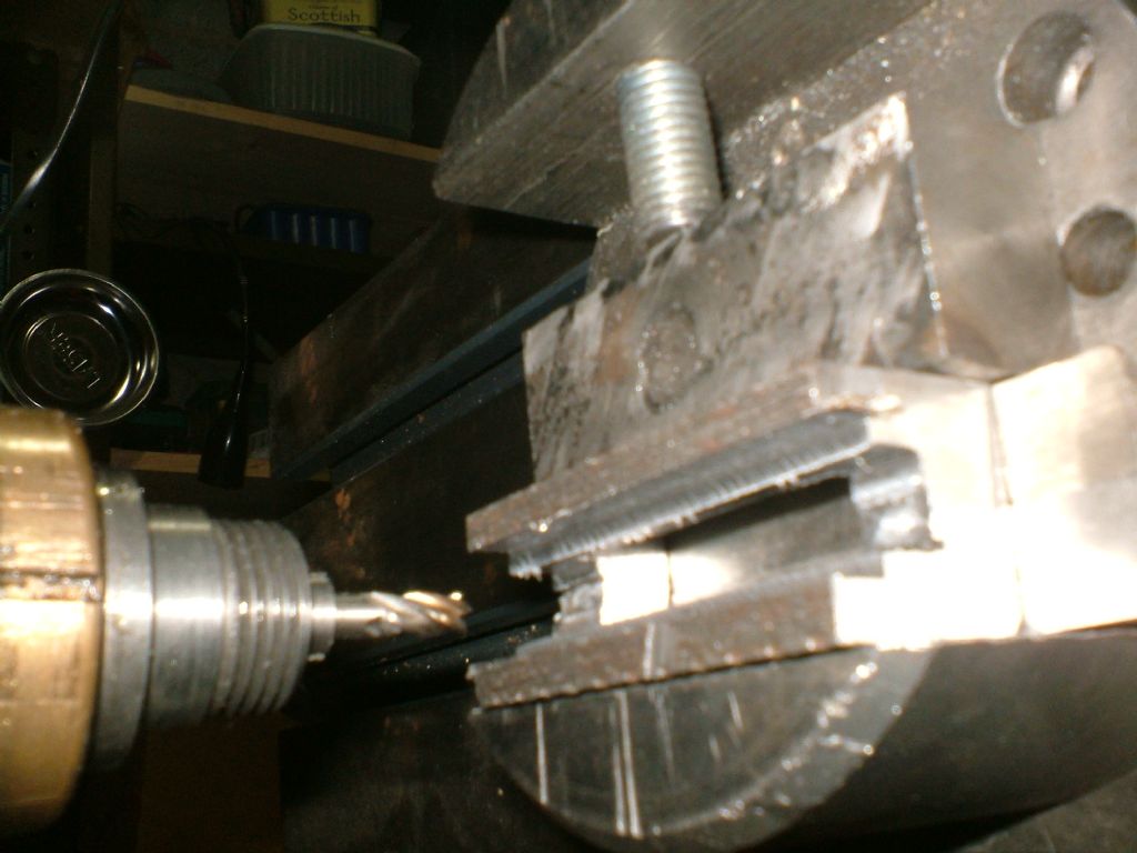

                                          Well I finally set things up right and had a go at it and it's brill
                                          I've been looking at various stuff because I have a budget available but it's all 100kg 200kg 300kg gear and I really don't want any more steel monsters to deal with so I got on with the final parts for a basic milling in the lathe setup
                                          The cross slide and carriage are basically a moveable knee while the head is fixed, keep them nipped up and keep an eye on them
                                          The support was 50quid of 10mm plate I cut up and welded and the table was 200 from ebay
                                          Another 30 for nose collets to 8mm which are essential for decent work (from previous experience)
                                          It just buzzes back and forwards through the work, I use a cordless drill as a slow power feed on the handle nut
                                          60kg for the lathe and 45kg for the milling setup, max cutter 8mm but I prefer 6mm because you can zip along
                                          will try to carve a vice out of a solid block after xmas, got family stuff for the xmas period to do

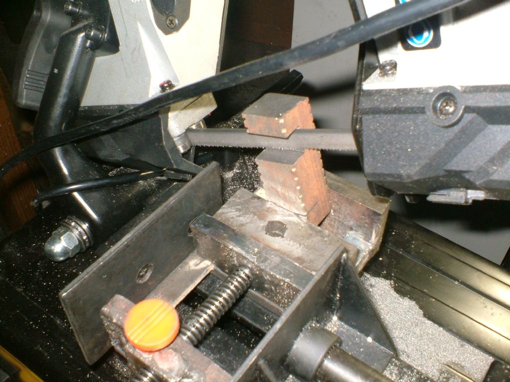

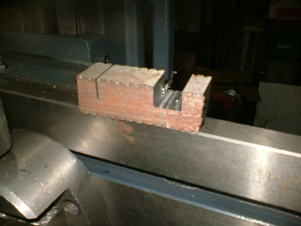

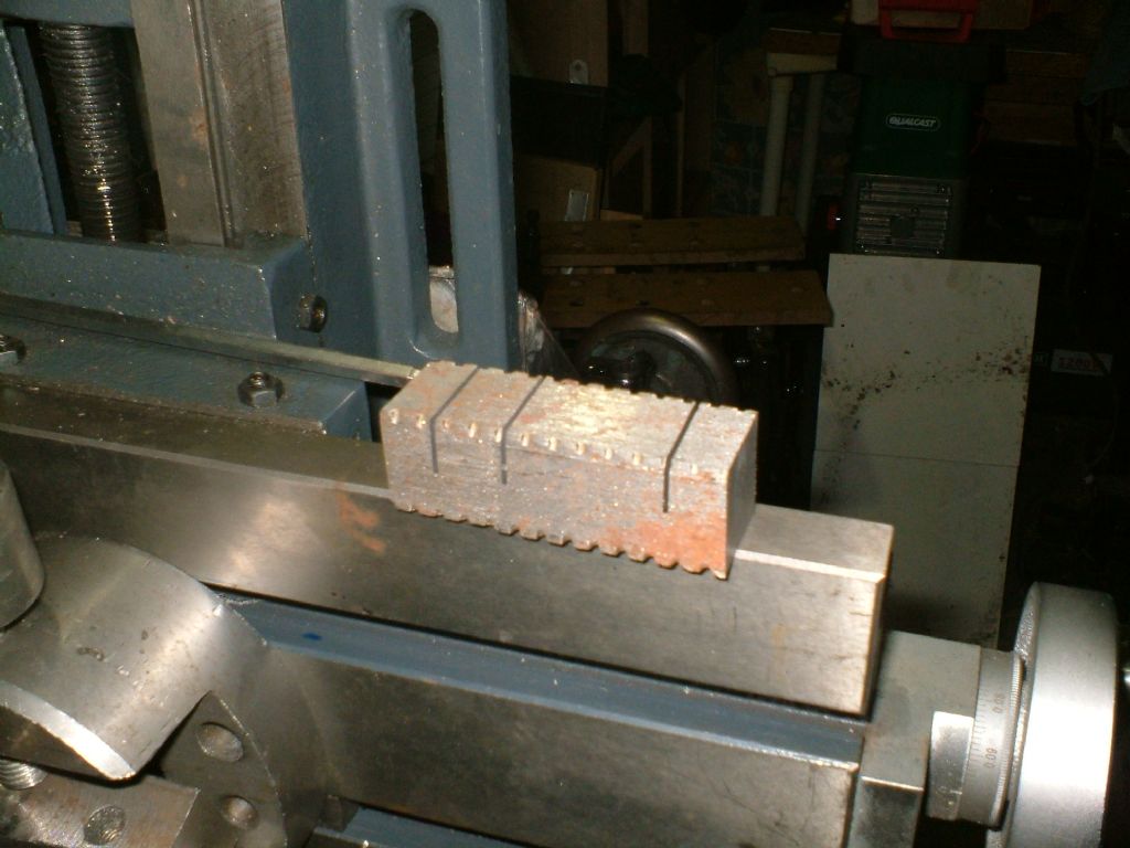

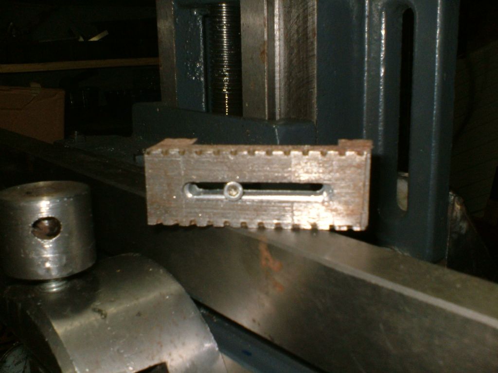

                                                Well I managed to get a bit done between the hoovering and cleaning for the in-laws
                                                cuts for the top
                                                milled out the slot
                                                stuck in the bandsaw
                                                main body out
                                                fancy slot bit, the 4mm was weird and broke but at a tenner for 10 I can't complain
                                                went 6/7mm to 5mm on the slot
                                                A 4mm hex can fit in… most of the way but there's some teeny high spots
                                                All in all I'm very chuffed so far
                                                Downside is I now need an endless supply of 6mm cutters a weekly bucket collection for the mountain of swarf these things can make and a motor that never wears out
