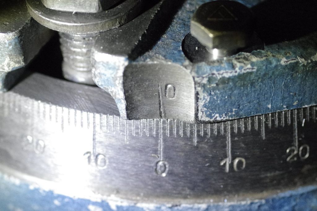

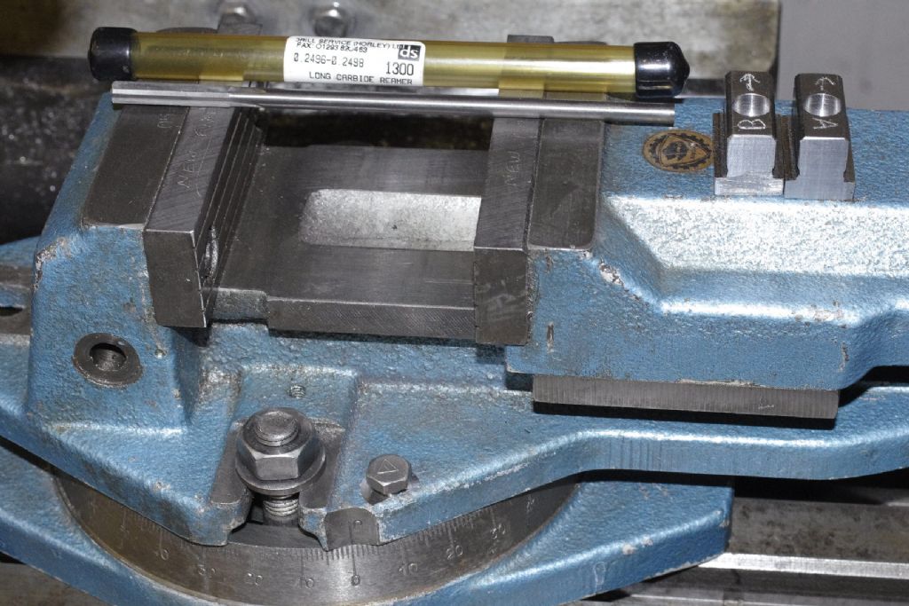

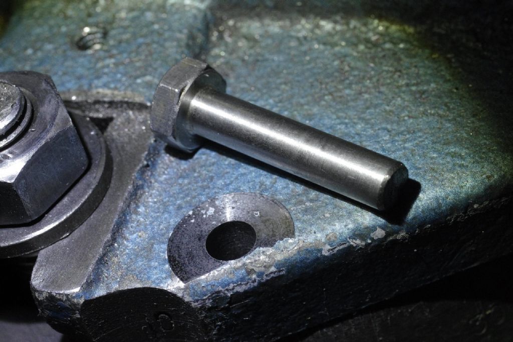

        _igp2921.jpg_igp2918.jpgJust to really wind up the haters of milling vise rotary bases, we have been modifying one of the Bison 100mm vise bases. The object was to set one of the 100mm's on its rotary base and make keys for it to fit the Tom Senior and the drill mill. Mike made the keys, four as they have to fit different width slots in the two mills. The base was lined up with the vise and clamped up and I tried the keys as made to find what the error was. It was only 0.004" across the entire width of the jaws. I had thoughts od pinning the zero position and found there was room to have a 1/4" pin. So I slackened off the bolts holding the halves together and adjusted for zero tir across the jaws and retightened. The alignment marks for the degrees had not noticably moved, so I drilled a 6mm hole and used a 0.2498" solid carbide machine reamer so that an aircraft bolt with a ground shank of 0.249" fitted. The pin holds the alignment within +0 -0.0005" across the 100mm jaw width. I then fitted the second set of keys and tried the alignment on the other mill and to my surprise it was exactly the same. No extra fettling needed.

        Edited By old mart on 23/04/2022 19:02:55

        #595584
        Steviegtr
          @steviegtr
          Great job Old mart. I did look at one of those Vises before choosing the one i did. I guess there are times when you want to tilt at a certain angle.
          The one i bought had an error in the Key slots under the vise. So i took a smidge off one key & now it's all good on the Senior.
          Steve.

            #595690
            Mark Rand
              @markrand96270
              When I rebuild the Beaver mill I didn't bother scraping the sheears of the T slots, so I don't trust them to be absolutely in line with the X axis. Thus, I always indicate the fixed jaw of the vice in whenever I put a vice on the machine. I'm not convinced that a dowel would give me any useful improvement when using a vice with the rotary base.
              #595692
              old mart
                @oldmart
                The mill drill tee slot which was appropriate for the 100mm Bison vises had a 0.007" error from one end to the other. It has a 500mm stroke, so the length is more and because it has a round column I was able to mill the entire rear sheer if that slot in three stages by swinging the head. The error along the entire length of that sheer is about 0.0005" from end to end. It helps when both Bison vises are used together for a long workpiece. I haven't bothered to check the other three slots for runout.
