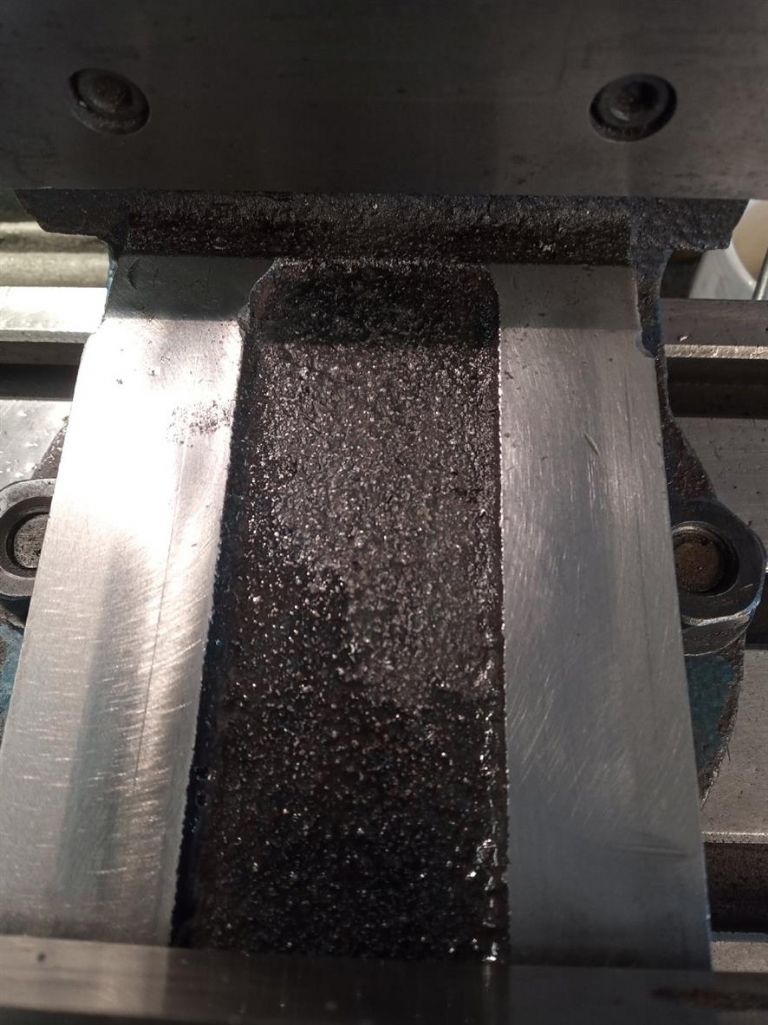

                    Hi Clive I can't agree more as stated earlier the vice is 28 years old and it was not expensive when I bought it and I have used it quite lot and done some decent stuff with it and had not many problems with at all. However this last project has been a right pain I did managed to a finish the parts but it was not easy with very little room for error due to the taper I did find some information on a machine vice they were stating 0.02 in 100mm which slightly better than what I have got . Jason information was very useful as it shows that the vice in the y direction can be better. so today I have stoned the working area of the vice base parallel in both x and y axis so these are parallel with the table which was tested with a 123 block sitting the base with jaws open and the block laying flat error was less than 0.01mm in x and y axis checking 3 inch long edge in both directions which gave a big improvement on what I had before in the Y axis no change in the X axis then checked It with the vice closed and the block tapped down and got almost the same result . I have been lucky as where the top jaw runs on the edge of this surface it was slight lower than middle part see photo which means I have not touched the area where the top jaw runs so if the taper is required to restrain the lift in the top jaw I have not touched it .

                        As far as I know putting a deliberate slope on the base of a vice isn't a way of restraining lift. More likely, I think, an inexpensive vice was accidentally machined with the slide and base not quite parallel. The slope causes a small problem when the jaws are close together, but worse when they're far apart.
                        So I think correcting the problem by stoning as Kim describes is the right answer. (If de-sloping required a lot of metal to be removed, I'd mill the vice.)
