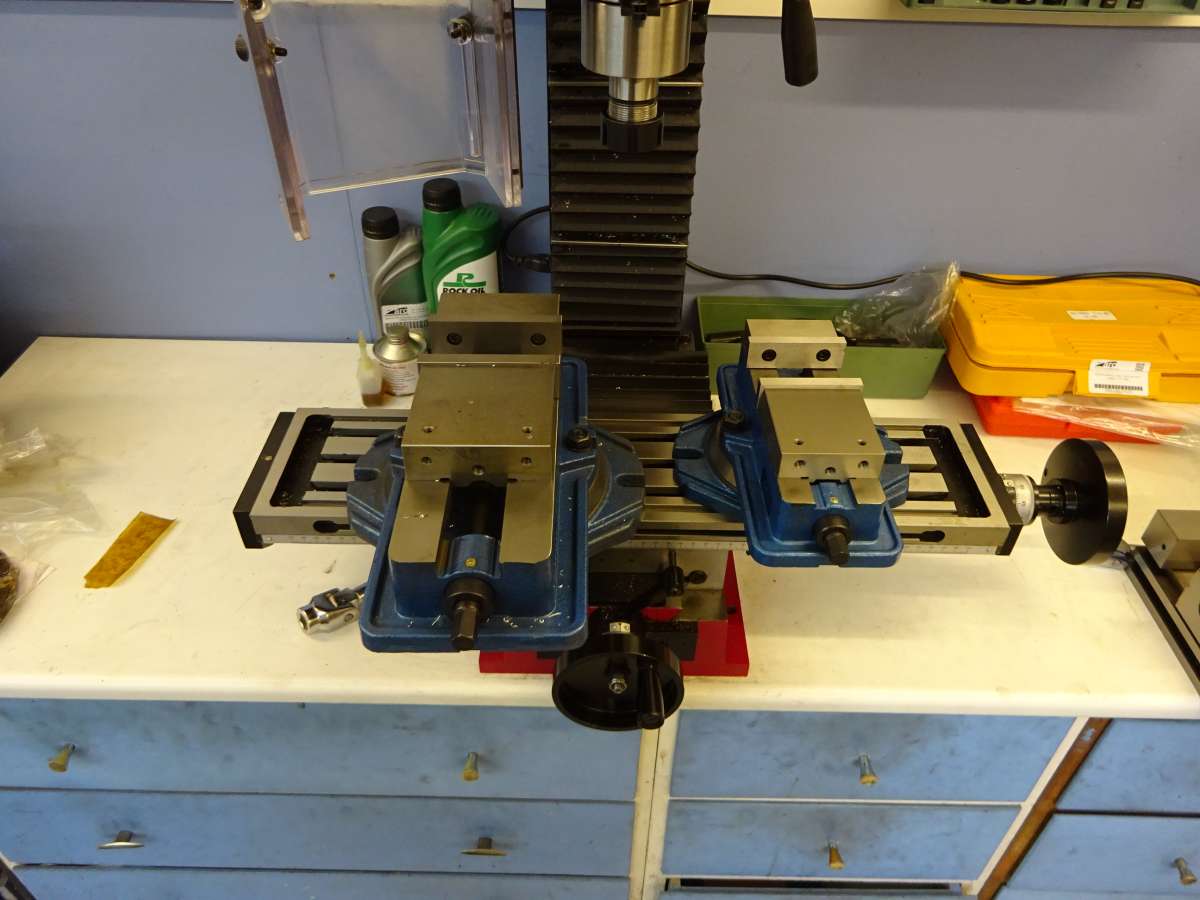

        I would go with an 80mm versatile, the size difference between the 80 and the 100 is a lot more than the 20mm difference in jaw width. You end up having to mount teh 100mm towards the front of the table if holding smallish items which means a lot of overhang which makes it hard to see the Y handwheel.
        Couple of photos of the 80 and 100 on the larger SX2.7 mill.
        DSC02244
        DSC02243
        Though you don’t need the swive base 99.9% of the time

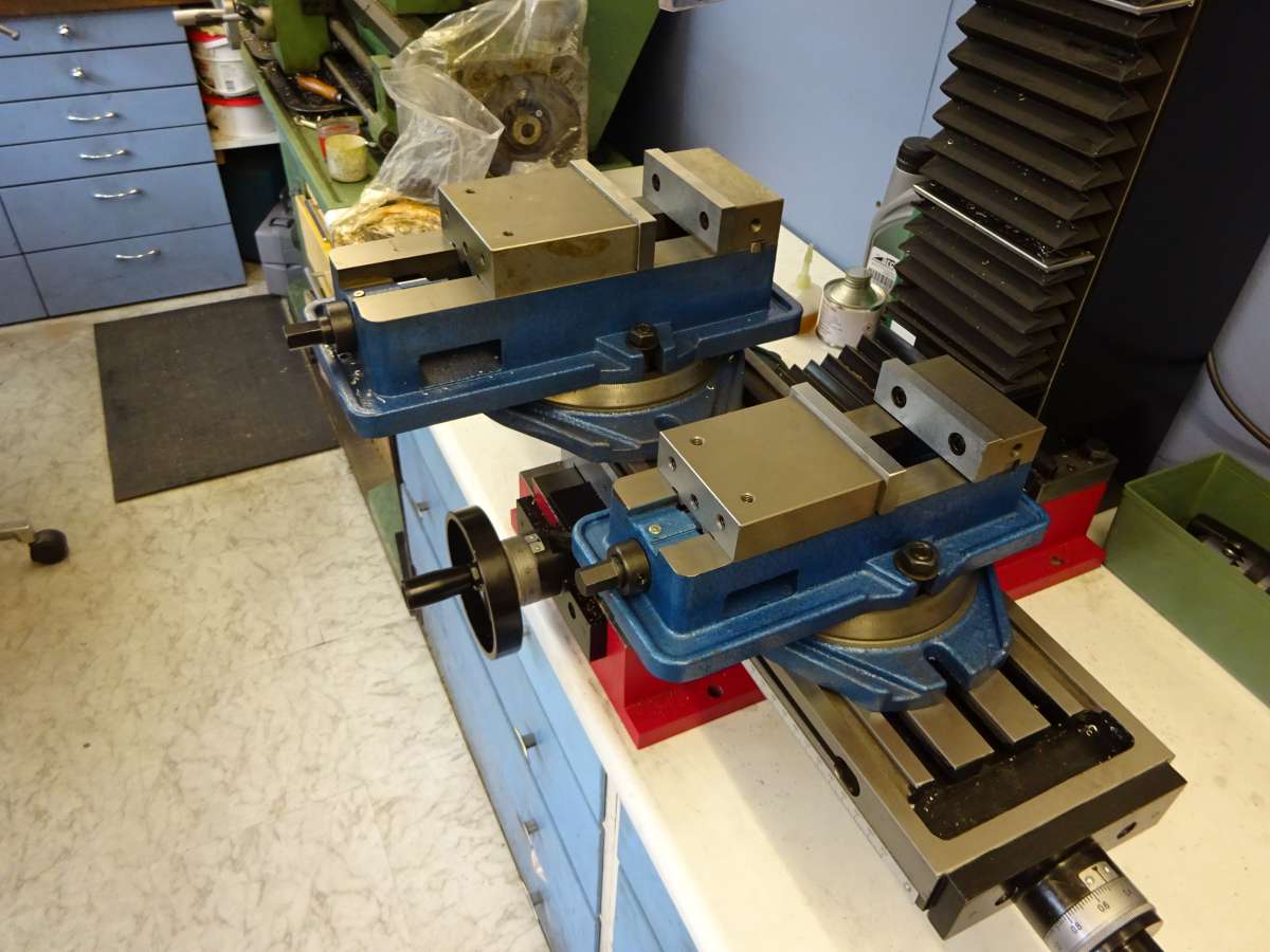

          I have an SX1LP which has the same size table as yours. I have an 80mm Arc Versatile Milling Vice, and a 70mm toolmakers vice (mine came from MSC when they had them on sale).
          The ARC vice overhangs the table quite considerably front and rear, and 90% of the time I use the toolmakers vice unless I need the flexibility of the jaws on the versatile one. Anything long that needs dealing with gets clamped directly to the table.
          I think a 100mm vice is going to be too big for the table. Rear overhang will probably cost you a lot of Y travel.
          Here is a photo of my two side by side on the table to give you some ideas, the versatile on the left is not clamped down just placed.
          Vice Images 20240928_155932[1]
          Edit – Jason types faster than me!

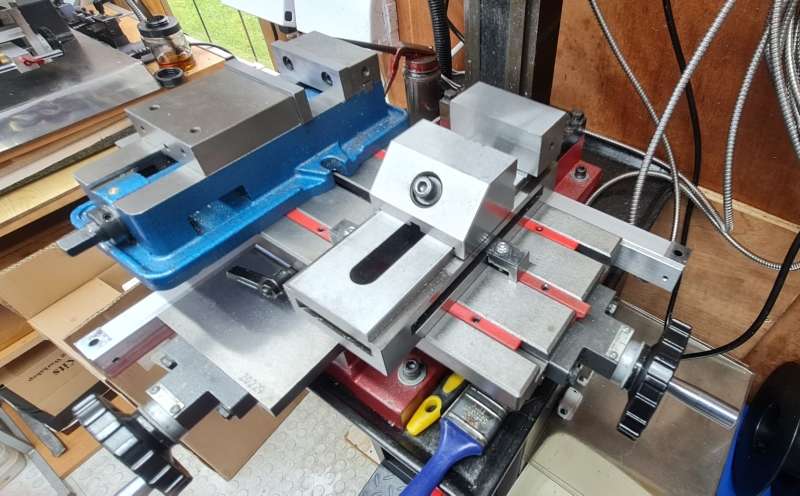

                          I have the 100mm kurt clone on my VMC, it’s pretty big even on that, and like Jason said, it kinda blocks the handwheel.
                          I bought a Warco DH1 to replace it but I haven’t had chance to test it yet.

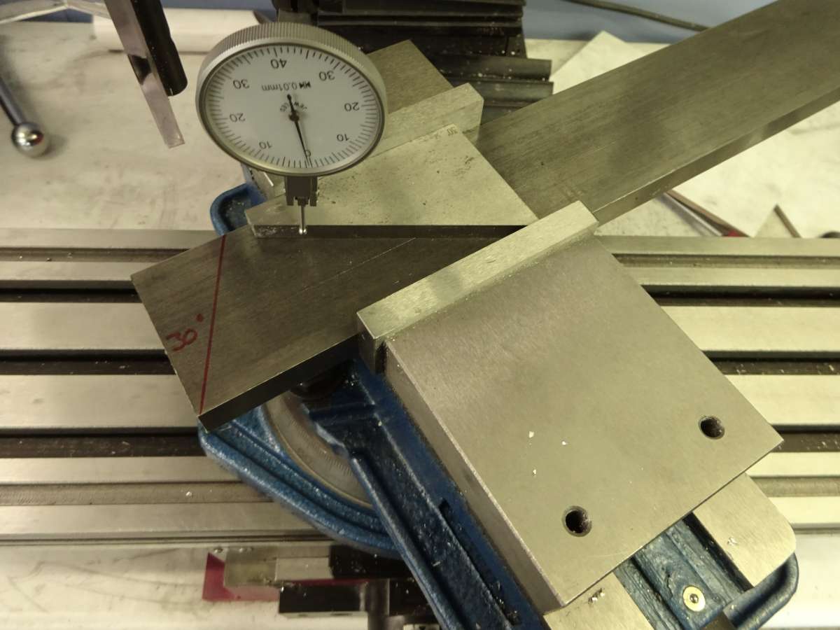

                                      #756788
                                        Setting a vice at an angle is not really any different to clocking the fixed jaw true, all you need is an angle gauge and DTI. Easier and less costly than a sine bar and box of slip gauges.
                                        Photo 136
                                        If you have a DRO there is no need to do the trig, just set the angle function and as you move one axis it will automatically give the change of teh other axis so you just need to use your dti again and make sure it reads the same for any two given zero,zero readings on the console.

                                            #756894
                                              No need to overthink things by adding a fence, just lay the angle gauge on the flat area behind the fixed jaw and as the jaw is parallel press the gauge against the back of the jaw. Job done.
                                              Well the photo and an explanation was in MEW, maybe you skipped over it as it was in my Beginners series, also appears in my book. Quite a few more examples of mounting work at angles with vices, angle plate, 2 angle plates, rotary tables,  etc.
                                              This explains using the DRO function fairly well
                                              #756953
                                              Tony Pratt 1
                                                @tonypratt1
                                                Jason,
                                                Thanks for the video and as the the old adage says ‘you are never too old to learn’!
                                                Confession time, although I bought up the idea of using trigonometry to set a vice jaw angle and indeed that is how I did it for many years on a trusty Bridgeport and old type DRO I never actually realised the mill I have now has an ‘incline’ feature, but I do now!
