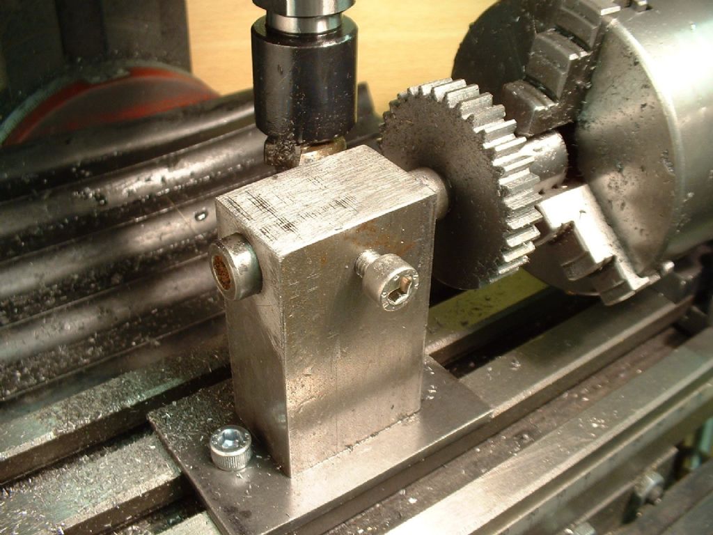

                            My dividing head  mounts my mini lathe chuck. The spindle and body were two huge lumps of cast iron from college engineering, and I ‘free hobbed’ the gear at a second attempt (number 1 had 61 teeth!) It looks a bit agricultural, but it does the job. I also made a boring head and a ER25 collet holder (which was in ME about 9 years ago).
                            I suggest putting your money into one or two solid vices, good milling cutters and standardising on one type of holder. You can make almost anything else, if you wish.
