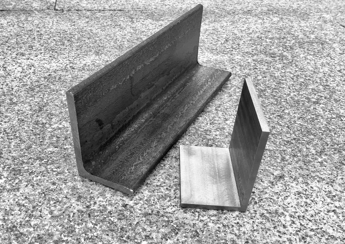

                              I originally decided to machine a pair of parts and then cut it in two for final shaping. After some more thought milling each component gives me more work holding options. I cut the angle roughly to length and cleaned up both ends. I then held it in the vice and fly cut the outer face of the long leg and without moving it cut the outer of the short leg with a long end mill. Next operation is to flip it over and cut the edges of both legs, again without moving it. After that I need to clean up the inner faces. I’m not sure whether to leave the fillet or not yet.
                              Edit: I didn’t bother touching the surface before milling and it cut just fine with both HSS and carbide tooling.

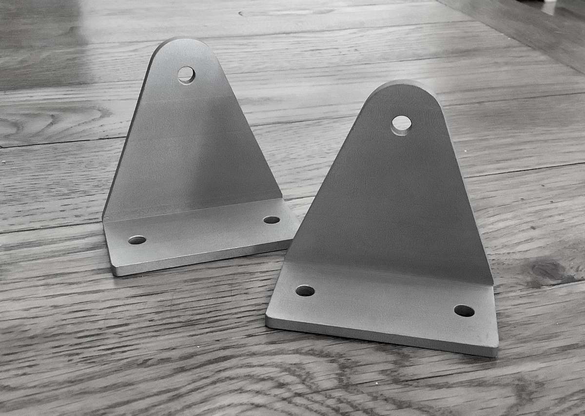

                                One down three to go. Once cleaned up I’ll size and shape them. Nothing fancy, I’ll probably just knock the corners off.

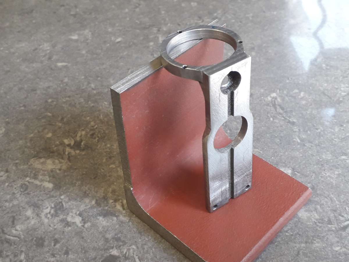

                                        I’ve made a few small angle plates to use for milling on the lathe or drilling in the drill press, made out of 4″ steel angle cut down to about 1.5 or 2 inches each side, so the web is good and thick. Machined the outside faces but not the inside. No problems with either cutters blunting or the angle distorting after machining.
                                        I got a bit carried away and scraped the surfaces in to a piece of plate glass so they were nice and flat. They seem to have stayed that way for years now.

                                                Two done. I ended up shaping them just in case leaving too much bulk interfered with movement between top and bottom brackets. I was just going to sandblast and wax as usual but I think I’ll blacken these. As I’m not slavishly making a direct copy, the size is,within reason, anything convenient. They ended up around 70 x 70 x 36 with a 4mm section.
