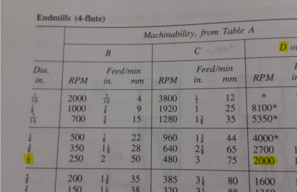

      Posted by JasonB on 24/10/2020 16:09:34:
      …. of Tubal Cain in Model Engineers Handbook he gives us 2000rpm for a 1/2" cutter in free cutting steel in which case 800rpm is a bit tamewink
      I think you have a misprint, TC gives 2000 rpm for a 1/16" cutter, not 1/2"
      #505715
        Duncan No misprint just you have misread it. Mine is what I said yes he gives 2000rpm for a 1/16th cutter but not in group "D" which is what he classes free cutting steel as, does not even offer a speed for a 1/16" cutter in that.
        Edited By JasonB on 07/11/2020 07:14:47
        #505727
          Posted by JasonB on 07/11/2020 07:13:33:
          That said … The asterisked footnote is worth reading
                    Ah yes I'd misread it, but note that TC says immediately below the table that 'for milling treat F.C steel as C, so he recommends 480 rpm. 2000 rpm on a 1/2" cutter is 262 ft/min, which is very high for even FC steel.
