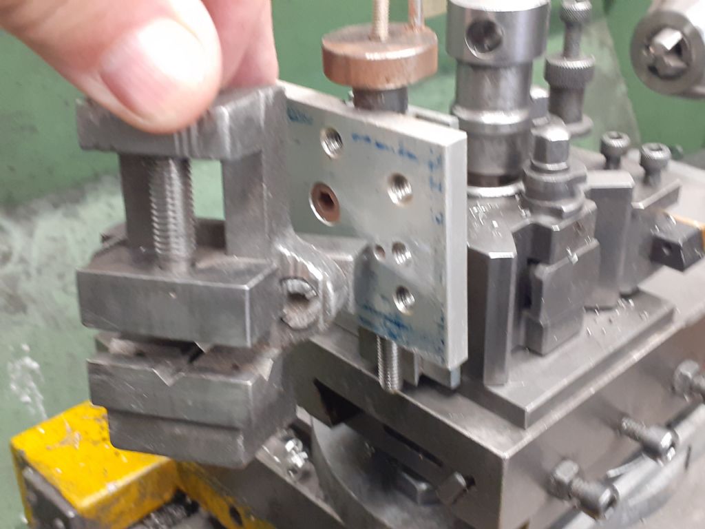

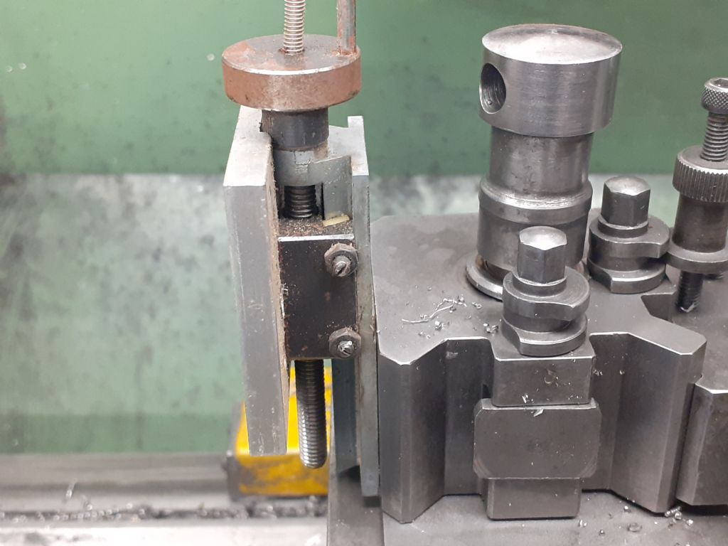

                                                    #515862
                                                      I dig this out from the bottom of a draw where it has sat for a good few years, it's a modified Unimat top slide that fits into a hole drilled tapped and counterbored in a spare side of my 00 Dickson QCTP and the little unimat vice that I can mount onto it. Good enough to do the milling for a Stuart Beam and Anthony Mount's Rectiliner engine so you don't need a big V.slide for most of the Stuart range. As they say it's not the tools in your workshop that matter, it's what you make in there.
