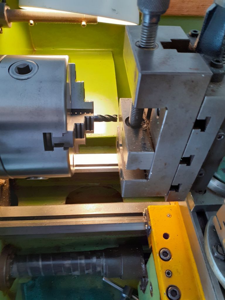

A little time to progress with this project today. Started by drilling out all the stud holes ready for Tapping, I started with a 4mm then a 6mm and then finally the 6.8mm that came with the 8mm Tap Set.

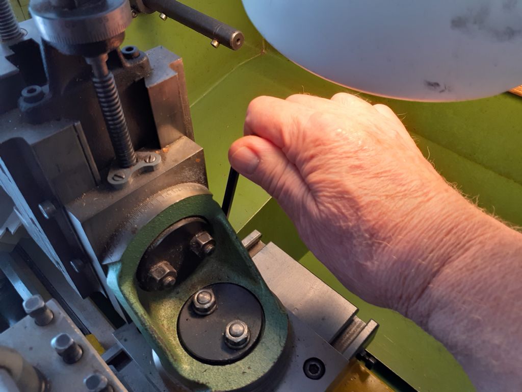

Then I tapped the first hole and checked the threaded bar.
Next I tapped the remaining 4 holes and marked out 5 pieces of threaded bar, each 50mm long.
I then put the angle plate in place and fitted the 5 studs, washers and nuts.

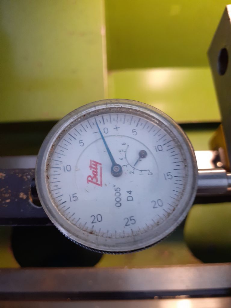

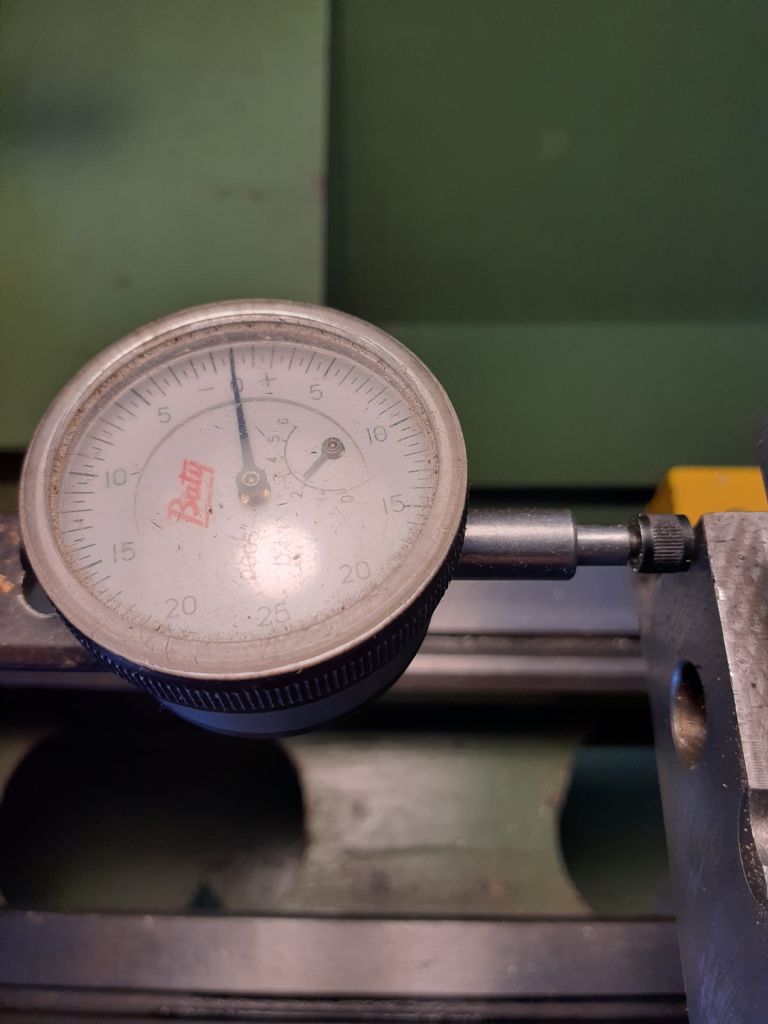

Once it was clamped in placed it was very rigid, however when grabbing and rocking the angle plate it showed a little movement in the cross slide?

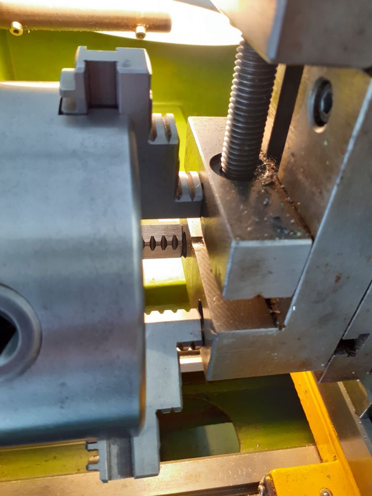

Eager to test it out I grabbed the only flat metal I had, some scrap square bar brass. I clamped it in place using a Soba Stepped Clamp Kit. Doing this highlighted the need for a better solution, anyway I cracked on.
The shot above was taken after I had successfully taken a small cut out of the lower centre of the bar with an 8mm End Mill.
So my first ever modification and my first ever milling operation
This was done in two passes, and you'll see where I went a little deeper in the middle.
