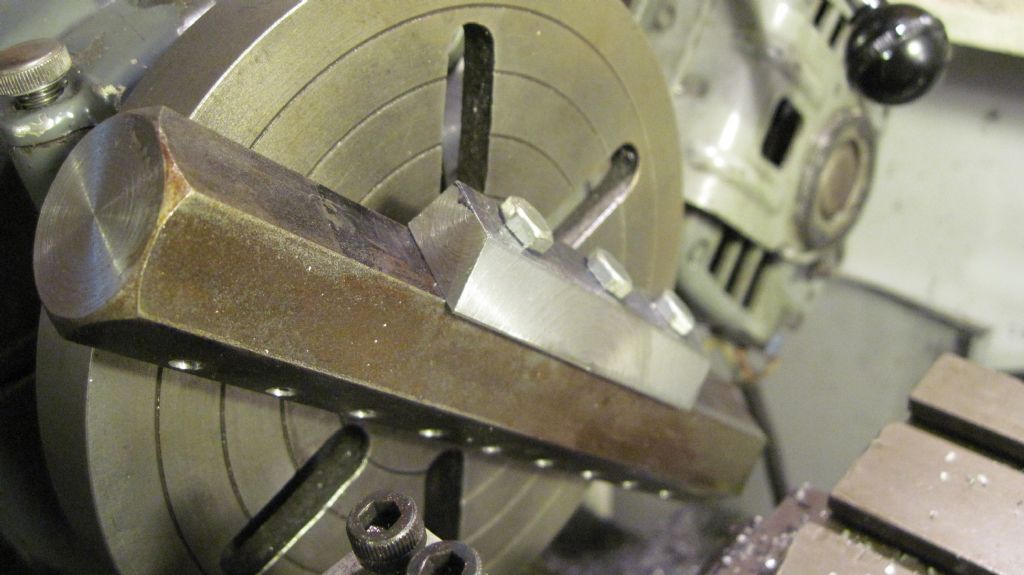

      I don't know the WM180 Bill but I started off milling in the lathe and still do so for some things when it suits my needs. What would I recommend?
      Well for a start the most rigid set-up you can achieve, which in my book means forgetting swivelling slides – nice idea but rarely essential. My heavy (Chinese) vertical slide attaches to my S7 cross-slide (via an adaptor plate) and if there is any give, it's in the cross-slide – not the slide. For some items that don't need vertical adjustment once set-up, a simple angel plate will often be sufficient. I have a very nice solid 'V' angle plate that I use. The work can be set to the required height by packing, screw-jacks or sometimes just by eye.
      The other thing you will need is a secure way to hold the cutter. The cheapest option is a single-size collet-holder but I'd get an ER chuck and use that. Mine are ER32 and they get used a lot for work-holding too.
      So if you don't have the money, space or real need for a mill, then there is usually a way to do the work on the lathe. It might not be as quick or as convenient but for some folk that's not a problem in practice.
      Ian,
      I will be opting for the simple approach using Angle plate DIY clamps and a home made adaptor plate, but if I do decide to get a vertical slide, I am struggling to find one the size you were referring to and they all seem to come with an angle plate fitted, which I won’t need. Any details in the one you had?

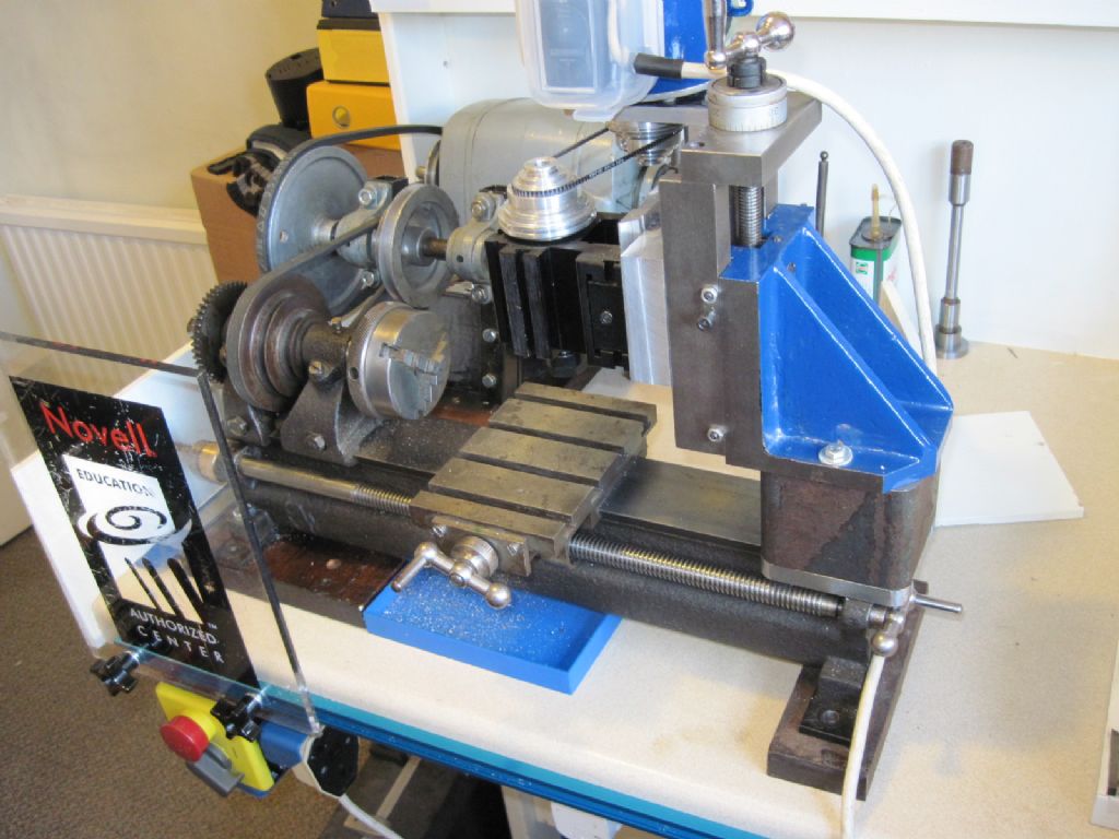

        Hello William,
        I've had a look for my vertical slide but cannot see anything exactly the same. I guess the Chinese factories tend to do one-off production runs and maybe this particular version has now been superceded.
        My table is 6.5" x 4" and has a vertical travel of about 3". It is very heavy. It also has vertical slots and came with vice 'jaws' that ran in them (and which always slip when tightened). However the slots do work OK to hold a small vice. The nearest I can find are the 5" x 4" slides that Arc Euro & Warco sell – although they are now about twice the price that I paid if I recall correctly. I remember lugging it back from a show but not the vendor I'm afraid.
        Here's another photo – It's being used on my EW to hold a Taig ER16 milling head – something I sometimes still do in the winter, when I'm staying inside.

          How is your milling 'stack' secured to the dovetail lathe bed?

            Hi Andy,
            I cut a length of bar with a matching angle in the Myford and cut it in half for gib pieces. It's very easy to do with a faceplate and some hex bar – just fly-cutting, no special cutter required.
            Gib Strip 5 - Oct 2012
            One piece is simply bolted to the bottom edge of the raising block but the other piece has slotted holes to allow some movement. Two small clamps on the side of the block tighten the sliding gib inwards and when everything is snugged up it's very solid.
            The set-up works fine for light milling of small parts and is just as easy/quick to set-up as the EW's vertical slide.

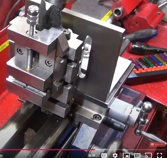

                    So, moving forward slowly with this (Busy completing a Robot entry for a competition).
                    I will be using…………………………video to fabricate a Milling Attachment on my Warco WM180 (thanks to Peter Baverstock for the link, but have a couple of questions.
                    I have removed the Compound Slide to reveal the stud that the Compound Slide can swivel on. On the lathe Steve shows the stud is 8mm, mine is only 6mm and the bolts are probably about 5mm.
                    If I use these to fix my base plate on which the Angle Plate will secure, will they be strong enough to hold everything for milling?

                                The V. slide is not going to be mounted to the compound slide mount, the compound fixings are used to mount a sub plate and then the V slide is fitted to an angle plate fixed to the subplate which puts it in the best position to get the most movement across the lathe as well as vertically downwards
