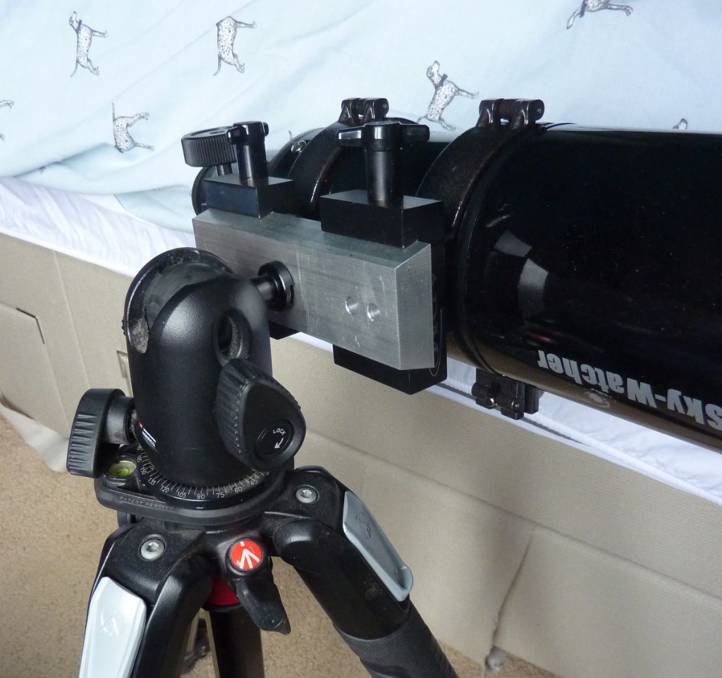

I thought it might be useful to write up my most recent job because it involved a lot of thinking and several different clamping arrangements. It is a 130mm long piece of dovetail bar to improve the attachment of my little 80mm telescope to my camera tripod. The dovetails are a 15 degree angle. Most of it was done on my 1930s Faircut lathe using my Tom Senior vertical slide. It would have been MUCH easier just to buy a short length of dovetail bar but in a fit of misguided enthusiasm last year I bought some 5/8 by 1 3/4 aluminium to make my own and then spent months agonizing over how to actually do the job.

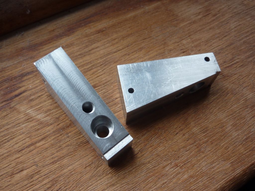

The first problem was the 15 degree angle. I have no tilting table and have never found one that I thought would be capable of useful work without also using up all of the available working space. Instead I decided to make two angle block fixtures that could attach using M6 Allen screws to the slots on the vertical slide.
They are made from the same bar stock. First I sawed a length off and then made a diagonal cut to achieve roughtly the right shape. A hacksaw is often much quicker than chewing metal off with a milling cutter.
Next the sawn ends needed to be tidied up. I did this on the vertical slide with the job overhanging the nearest edge and using the side of the cutter. I can't 100% remember but I think I used a steel strap over the job with a stud either side to engage with the 'T' nuts.
Next step was to drill the two 1/8 holes using XY coordinates to achieve an accurate 15 degrees. I could have done this on the vertical side but it has no dial so I used my little MF70 milling machine. The work was held down using step blocks and clamps… actually just one IIRC because there wasn't much room but I was only drilling so that was OK.
Then I milled the 15 degree faces. I attached a small vice (RDG Tools, no doubt from somewhere east of Suez) to the vertical slide, put 1/8 bar through the drilled holes so that the rods sat on the top of the vice jaws and clamped and milled both blocks together using the end of the 10mm cutter. Then remove them, mark and centre pop the middle of the 15 degree faces and return to the vice (still with the 1/8 bars), drill and tap M6. The final job was to mark out, drill and counterbore for the Allen screws (without the 15 degree tilt and overhanging the side of the vice to provide room for the drill to break through)

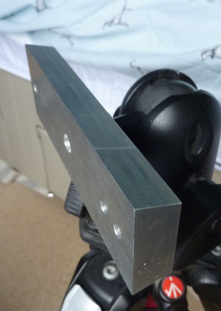

For the actual dovetails the first job was to mark and drill some M6 clearance holes – 1 3/4 will JUST fit in my vice on the slide. Then the angle blocks were attached to the slide, M6 studding screwed into the blocks and the embryo dovetail attached with nuts and washers. This was less than ideal because the dovetail bar prevented access to the Allen screws so it required some mucking about, clamping the blocks without fully tightening and then tapping them up or down to get the job level, checking level with a lever type DTI, then remove the job and tighten the screws… check again with the DTI to see if anything moved.
So now I could mill the angles using the side of the cutter on the top face. The big problem here is that even by winding the cross slide back (forward??) far anough to expose a short length of the cross slide dovetail at the rear I can get at most 4 1/2 inches of cross slide travel. I have a couple of 1 inch spacers that attach between the cross slide and the handwheel apron – those (and longer bolts) allow me to do the same trick in the other direction and get 5 1/2 inches of travel – theooretically enough for the job… if the job could be positioned to start and finish at exactly the limits… which it could not. I might have been able to arrange it if I had planned better but this is real life and that's not what happened.
My solution was to do each side in two operations, shifting the slide to another 'T' slot on the cross slide in between. This got the job done but there is a tiny step where the two cuts join – not an issue for what I needed but if I were making a dovetail whose main purpose was sliding then it would not be very good.
Job done. Telescope mounted. Naturally it has been cloudy and rainy ever since.
