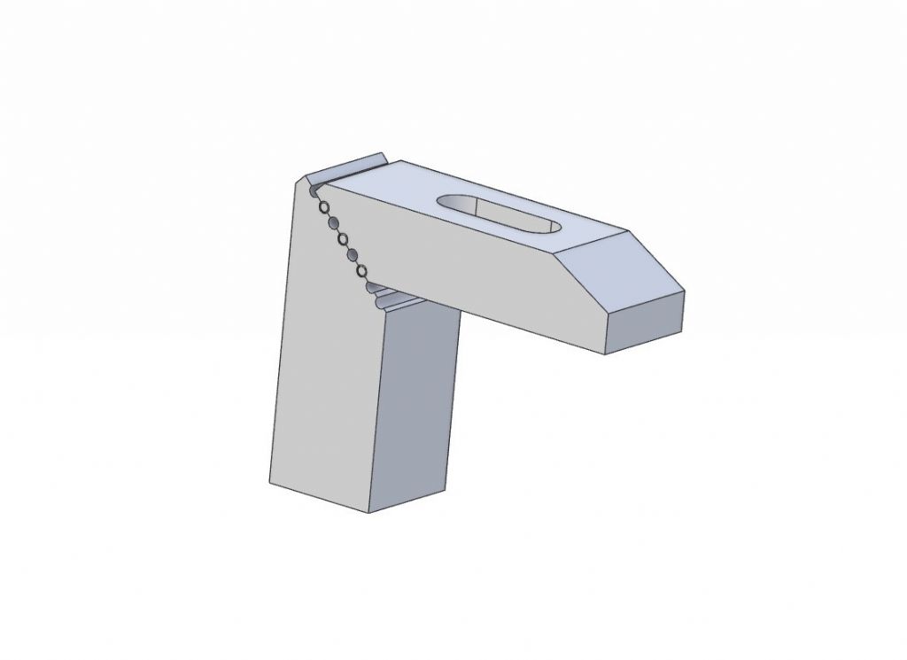

      Well, I like making tooling! So there. I read through this thread and had a little ponder…..
      A few minutes at the mouse and keyboard and I came up with this alternative to the usual "toothed" clamping system, which I think would be difficult to reproduce accurately in the home workshop. The idea is to drill a series of equally spaced holes (2mm dia. in my case) along a line at 45° to the major axis and then mill away half of the resulting holes. Make up the pillar and strap as shown and use silver steel rod or similar to lock the piece together. Varying the length to taste and you have a set of clamps that nobody else has got – OK, and probably don't want!
      clamping assembly
      The number of pins used is optional. I have 'used' three for simplicity.
      Just a thought.

      Bravo!
      I think I would glue the pins in to save workshop Esperanto.

              john Yes I’d glue in thoes pins, but in use does the clamping forces tend to push the vertical block back, and there’s not a lot of height adjustment compared to a stepped block this would  I think be worse when there’s a height difference between the packing height and work.  However an interesting solution.   Originally I used a system similar to tugs, but the stepped blocks are a lot better

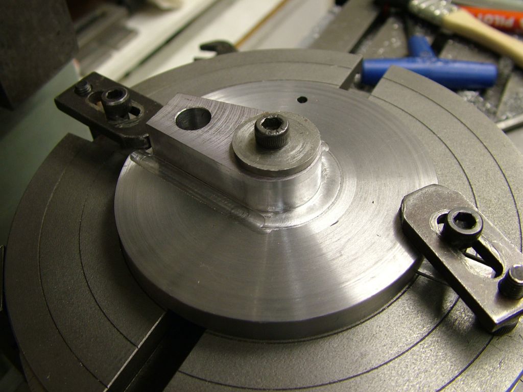

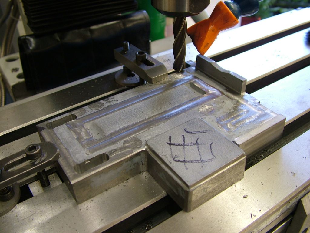

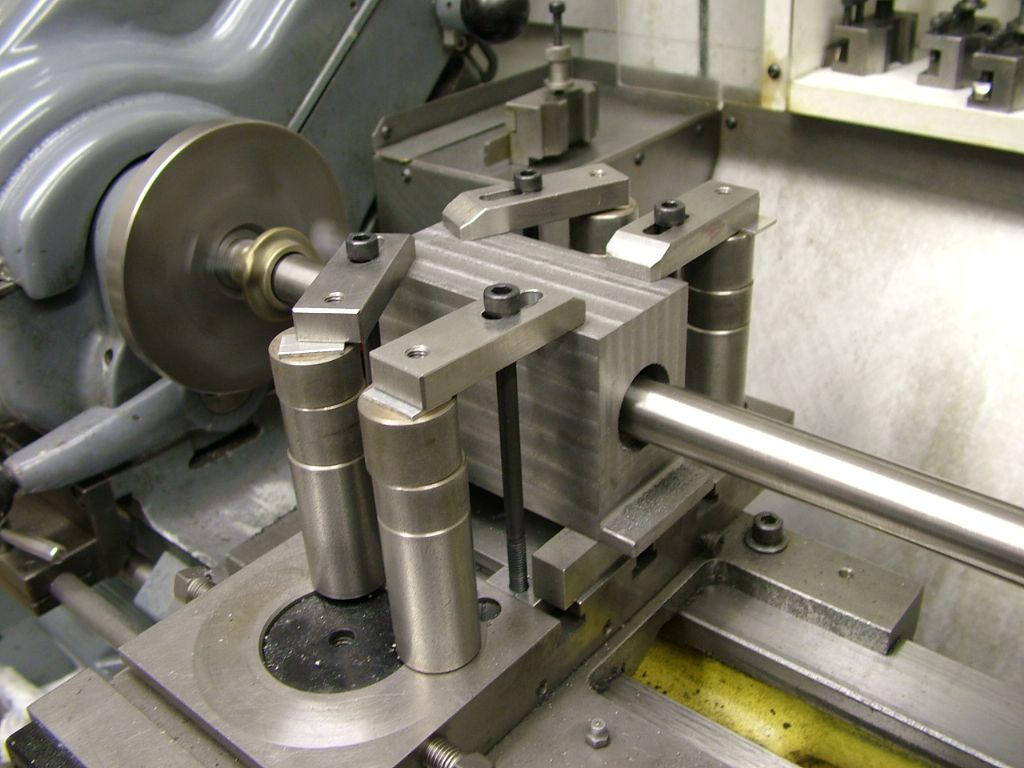

                    If you make your clamp bars with a tapped hole in one end – always assuming you don't consider making something for your self to use a waste of time – then the need for stepped clamping is more or less eradicated.
                    My collection of 6mm capheads range from 8mm long to about 120mm – anything longer I use studding. A reversed caphead in the clamp gives a good clamping supporting surface and is infinitely adjustable
                    I have a set of those Picador blocks that are shown above – I don't think they've seen the light of day for forty odd years – indeed the way they easily keep falling apart as you're trying to set them up and difficulties of holding them in place on a faceplate led me to the system I now use. If you have a stack of them a caphead dropped through them but short of the table keeps them in line.
                    It's always desirable to buy 'kit' – not least a clamp kit to mount beside the mill. Depending on what you are going to make of course but something based on the above is far more practical for the milling machine in question than spending on something that for the greater part will sit idle.
