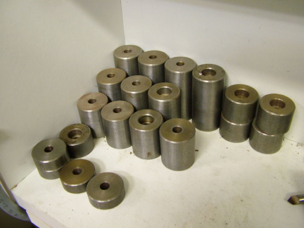

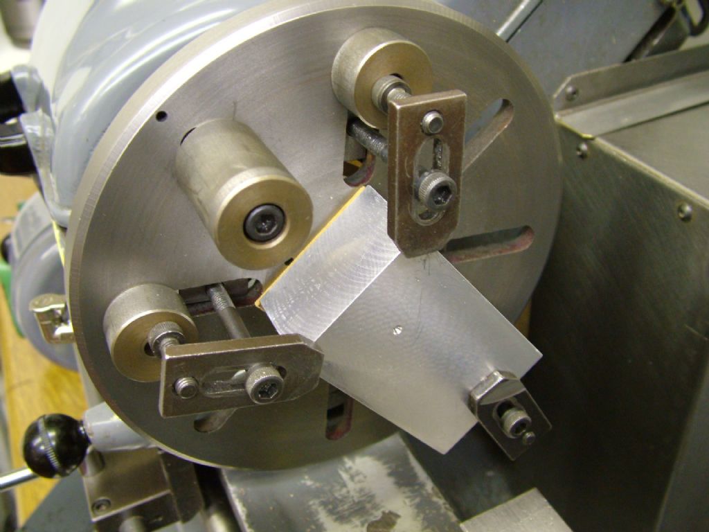

                                  Hi Bo'sun,
                                  Making your own Tee nuts and clamps is not an onerous task and you only need to make what you need 'now' I have used 6mm cap head bolts in varying lengths on both my mills from early on when I faced the same issue as yourself.
                                  I have a box of bolts – 4 of each length and tee nuts to suit both mills. Clamps are an accumulation but account for very little time and are quite small in comparison to the commercial sets. Packing blocks are varying lengths of 1" diameter bar drilled throughdscf4097.jpg 6.5 and counterbored for the caphead – they are used on the faceplate at times and the sunken caphead is very beneficial.
                                  They've done me well for many years but it's just a suggestion. Yes it may take time from modelling but it's time well spent and once done are done and you will have a custom product to suit your own personal needs
                                  Regards – Tug

                                          Rotagrip used to do individual bits for clamp sets at ME shows but they were "industrial standard" items made of tough steel and quite expensive.
                                          Harold Hall's, and also Tug's, clamp systems are easier to make than copies of the commercial step type clamp.

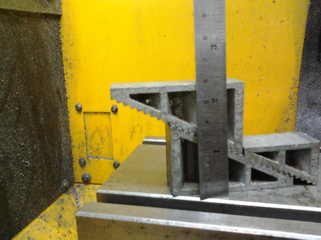

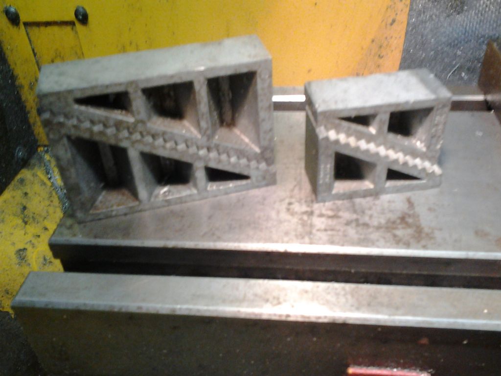

                                                    I've used these Picador cast alloy step blocks for 40 years when packing needed.
                                                    See they are still being sold on ebay, 1 used set on there ATM £15 +pp or new at £25 +pp

                                                      ‘New’ I don’t think they have been made for years😀
                                                      Tony
