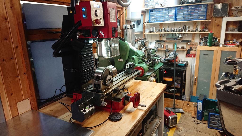

                              Posted by old mart on 25/01/2022 12:16:10:
                              An excellent choice for a benchtop, with a higher than average spec.
                              But your benchtop looks a bit flimsy and may vibrate. If you pull it forward to give your knuckle some respite on that Y axis handle you will keep knocking it. So I suggest finding a heavy (council spec) 3×2 paving slab to raise it up and give you a solid base.
                              #582381
                              Die Hardenedbedway
                                @diehardenedbedway41166
                                Yes. Im going to put it on some risers and bolt through. The bench is solid enough I think. Its on 20mm ply on top of a hard wood top of around 15mm. The bench is then fixed to batons along the shed. Its not super unmovable but good enough for me I recon.
