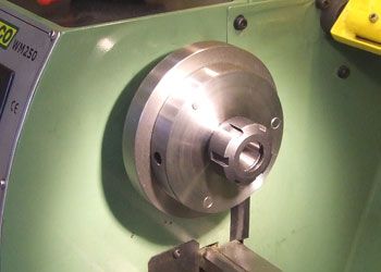

                As suggested by Nick above a good solution would be to fit a collet chuck. This avoids the need for a drawbar and gives the additional benefit of extra work holding capabilities.
                This is an ER25 collet chuck fitted to my WM250. ER32 is another option which will afford wider work holding range. More info at *** Journeymans Workshop***
                The lathe 3-jaw is not designed to hold milling cutters and will likely work it's way loose during milling operations damaging work, chuck or both.
