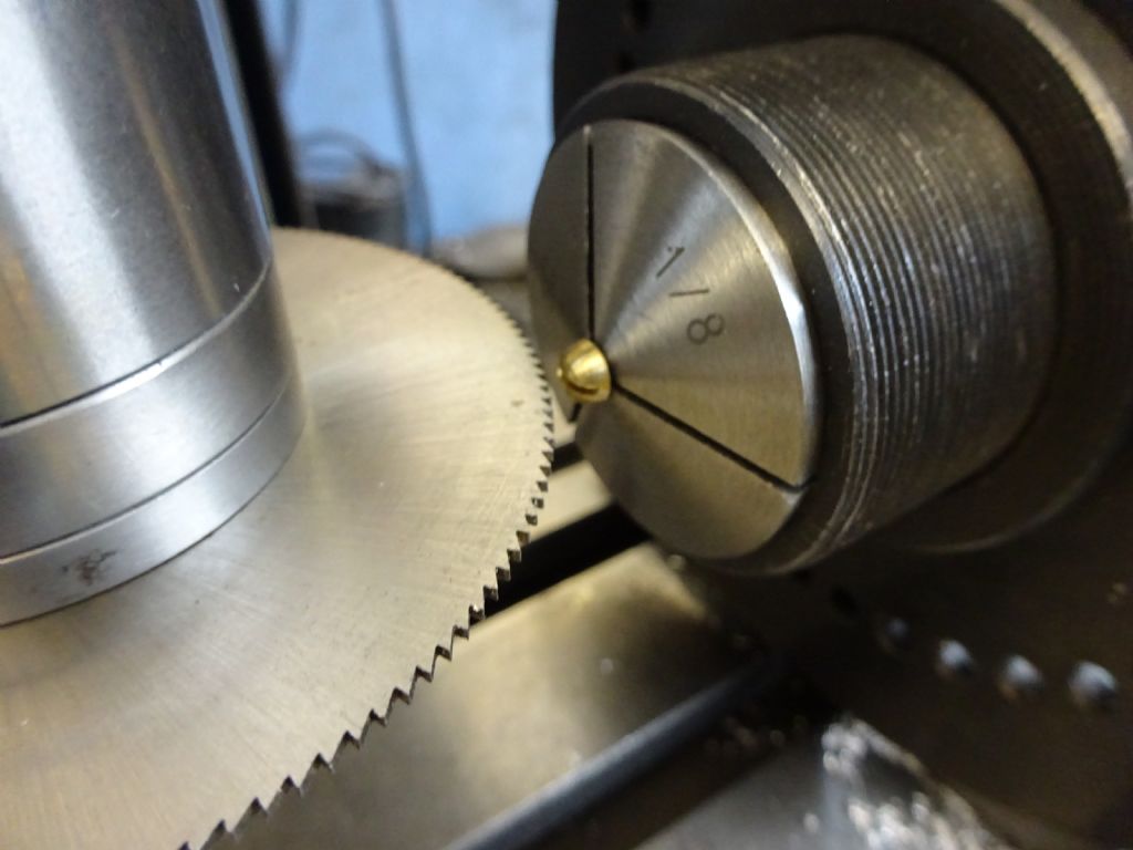

                      Slitting saw blades, what makes them coarse, fine or extra fine..?
                      I have 2 x 80mm blades, a 1.0mm and a 1.5mm and both of them have 32 teeth and are listed as "fine". I have a job coming up that needs a 3.0mm blade and I have found one with a different supplier and it is also listed as fine but it is 75 teeth..? Obviously there are two ways of looking at it, if the 32T is fine then the 75T must be extra fine and if the 75T is fine then the 32T is coarse. A bit confusing but I guess at the end of the day its a case of choose what you think best suits the job.
                      Ron
                      #416197
                      Andrew Johnston
                        @andrewjohnston13878
                        There's no definitive definition. In this picture I would regard all the slittling saws as coarse apart from the one bottom right:
                        The size of gullet is the important factor. A fine tooth slitting saw is ok for slotting a screw head. But if you want to take a 1/2" or more depth of cut with a slitting saw you need a large gullet for the swarf, and hence fewer teeth for a given diameter.
                        Andrew
                        Edited By Andrew Johnston on 26/06/2019 14:00:36

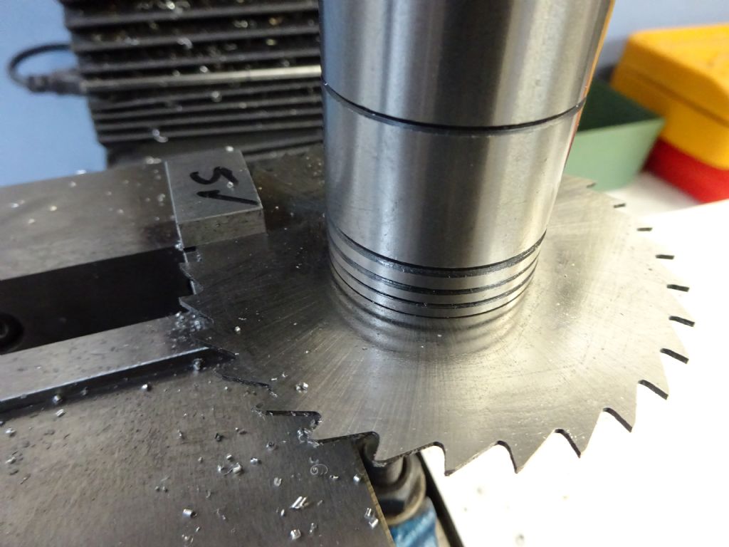

                          #416203
                            Hope this is also OK one here but I would say our usual supplier has them wrongly listed as fine.devil
                            I would say your 32T ones at that diameter are generally regarded as coarse and 75T on a similar diameter as fine. You don't see many medium ones about.
                            Probably better to look at it as tpi rather than number of teeth 32T on a 25mm dlabe would be considerably finer than the same number on an 80mm blade so much like using a hacksaw you would select a finer tpi if sawing thin sheet or thin wall tube than you would if hacking your way through a 50mm solid bar so for cuts in thin material of where the depth is shallow a fine blade is best like when slotting a screw head.
                            But a coarse one is better if slicing through thicker section material especially something like aluminium where you can use a highter chip (tooth) load that means more swarf to fill the gullet.
                            Seem to remember seeing those photos in an article I read not that long ago that said the same sort of thing
