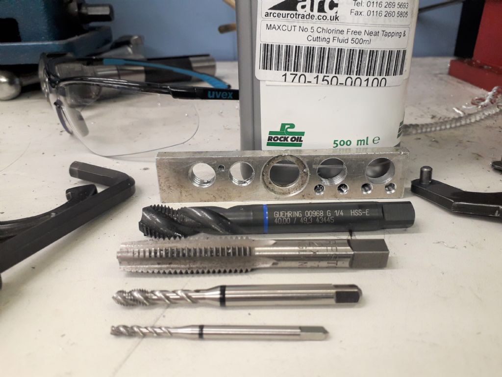

                            Well I had a little play with the tapping function today and was pleasantly surprised, the mill had the power to drive some quite large taps and the whole thing was quite relaxed at reasonable speeds. I know Ketan likes to do everything at 5000rpm since he got his grubbies on the SX3.5DZP but I started off with the following.
                            3 holes drilled 4.2mm and tapped M5 x 0.8 @ 100rpm, spiral flute tap
                            1 hole drilled 15/32" and tapped 1/4" BSP @ 100rpm, spiral flute tap ( one hole I did not mean to drill)
                            2 Hole drilled 10.3mm and tapped M12 x 1.75 @ 100rpm, hand taper tap
                            1 hole Drilled 2.5 and tapped M3 x 0.5 @ 120rpm, spiral flute tap
                            Material probably 6062 aluminium 6mm thick and a splash of Rock-oil Maxcut No5 tapping fluid.
                            As per my earlier post the only tap that seemed to bog down a bit was the M12 taper tap though the machine did seem to pulse the power and it showed no sign of stalling.
