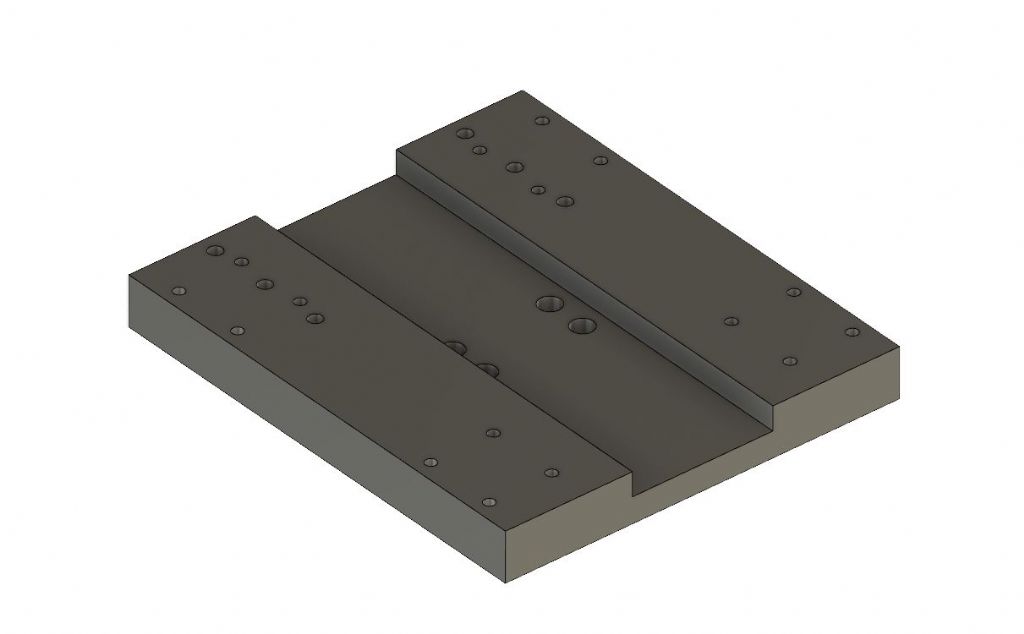

              I've attached a picture of the of the piece with the 70 x 13mm channel I'm going to cut (as well as trimming the edges of the rough/plate sawn aluminium pieces). This is the thickest piece I'll have to edge-cut at 25mm deep.

                the 12mm should be fine for doing round the edges if you do as I said above and let it overhang the bottom of your plate so you are using the flutes closest to the shank.
                For the groove work down on say 3 full cutter width passes and then start cutting sideways full depth maybe 2.5-3mm at a pass depending on how the tool sounds.
                The other option to get faster removal rates is to use a carbide cutter for ali which can be run faster so faster feed and ARC do them in standard length, give a good finish too.

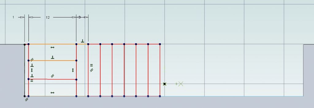

                  I do apologise though, I'm not sure I understand the procedure – are those 3 full cutter width passes next to each other and in the middle or to one side of the groove? I'd originally considered cutting the groove edges first accurately and then just working across the remaining at 2/3rds of the cutter diameter at a depth of cut that sounded OK.
                  #377596
                    I would do the three full width (of the cutter) passes just clear of the edge to take you down to the 13mm depth then a 13mm high by 1mm deep finishing pass to define one edge of your slot and then a series of 13mm high cuts working your way across the work until you get to the other side.
                            That's brilliant Jason, thank you!

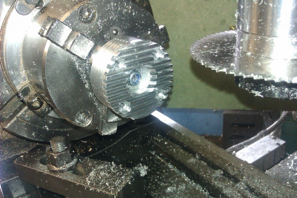

                                    The way I tend to do it is to touch the blade onto the top of the work, add a fag paper if you want and zero Z. Then feed down by half diameter or thickness of the work plus half the thickness of the blade for round work. For a cut that is a set distance down then touch off again and zero then feed down half blade plus distance to ctr of slot.
                                    If you get it right you can do things like thiswink

                                            Thanks Jason – that's simpler than the way I was trying to achieve the same thing. Fewer chances of making a mistake, I'll give it a try.
                                            If only 'getting it right' were easy I would be doing things like that. As it is I'm a time-served maladroit who deserves sympathy. Fellow members – please send cash until I feel better!

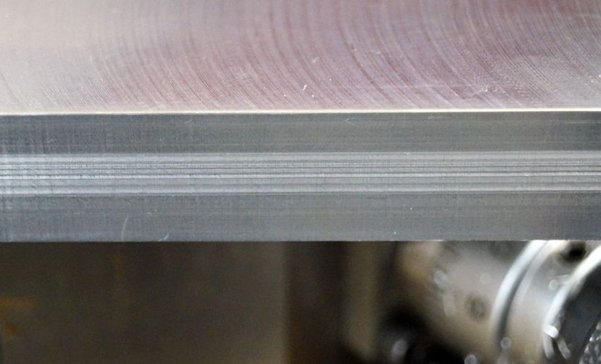

                                              I,m guessing that the band on the side of the plate is telling me that a section of the end mill has lost its edge..?
                                              #383894
                                                Or as you seem to be cutting dry you may have some metal stuck to the cutting edge. Try a little paraffin or WD40
                                                Was it the same one you milled the hornplates with as the width of the affected area looks about the same which may have just taken the edge off slightly.

                                                  Thats its Jason you dont miss much, yes thinking about it, it is the tool I used on the hornplates which were sandwiched together and the width of the band fits.
