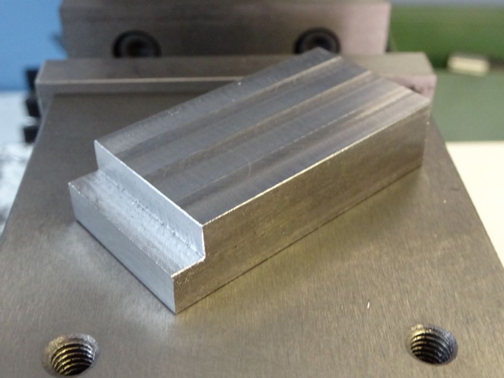

                                  With the next issue of MEW about to hit the virtual door mats of those with a digital subscription here are the videos that show the SX2.7 from ARC being used for some basic cuts with a 4-flute cutter. I used a piece of EN3 steel for these rather than the 6062 aluminium used for the magazine photos, 10mm 4-flute cutter from a budget range as that may be more representative of what a beginner may buy. Cut dry for a clearer view buy would suggest a small amount of something like this to give a better finish and prolong the life of the cutter. If you click "Youtube " along the bottom it will show at a larger size or the icon bottom right for full screen.
                                  Also not all the text was deleted from last months title so no marking out in part 6.
                                  I hope Neil did not have to reach for the sick bag too much but using a tripod would have been a problem as I needed to show different parts of the machine, also cranking one handed with the camera in the other does not bode well for steady shots.
                                  This is the finished steel test piece.
                                  Edited By JasonB on 03/08/2018 07:53:55
