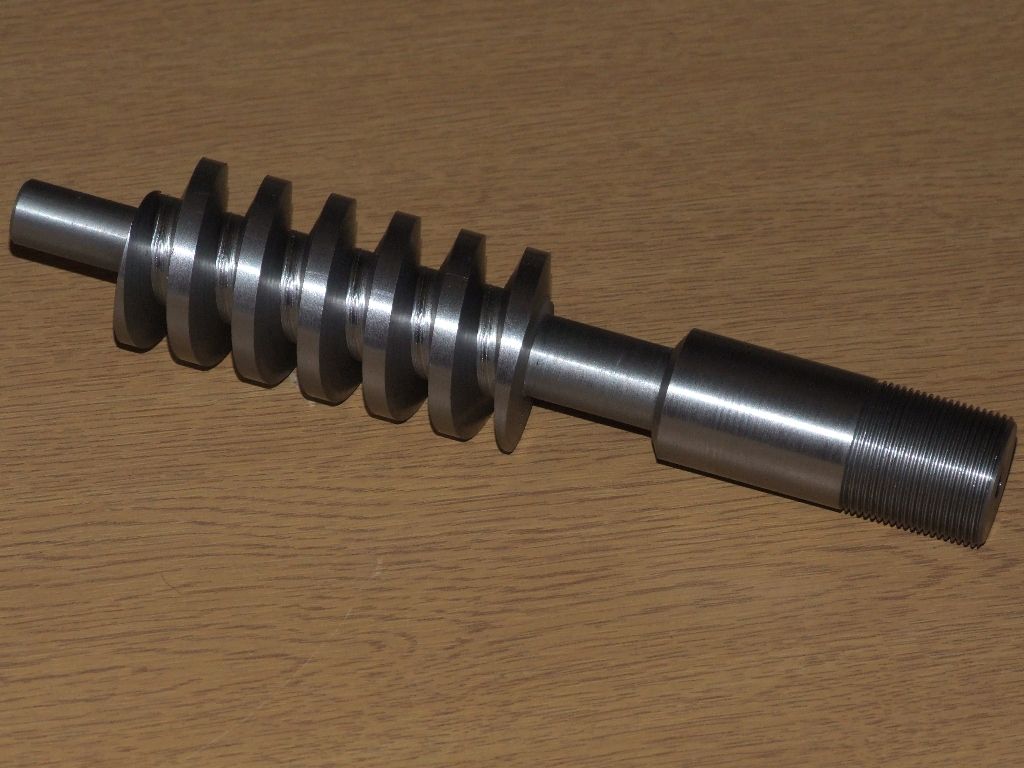

                            Don't even think about using a die. The thread should be screwcut for the reasons given by Jason. I use full form insert tooling to get the correct profile. The 1" diameter 20tpi Whitworth thread on this embryo worm wheel was screwcut to fit a large size Clarkson chuck:
                            Andrew

                                Me and Andrew were thinking fully cut . If you are set up on the lathe it's only another pass or two to get a finished thread with an FF insert and it's more likely to handle a harder material.
                                You will get a lot of change out of the £50 the die costs by the time you have subtracted the cost of an insert.

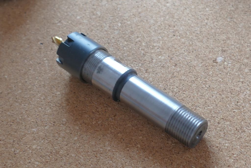

                                    I have cut a lot of these threads, I use a brazed carbide single point tool that I ground to 55°. Things I have threaded to suit my Vertex Posilock include Little Hoggers, Ø16 insert mill, Ø10 insert mill, ER16 parallel shank collet holder, edge finder. DTI holder.
                                    I set the item up in a collet or 4 jaw (clocked near the jaws) depending on diameter being held and clock the free end to ensure it is running as true as possible then centre drill the end before cutting the thread with the end supported. Some items need a plug in the end first to centre drill. You can check the thread is free running in the target collet and polishing it a bit with Scotchbrite before removing it. As the earlier post by Keith stated slightly undersize gives a better result, you need to be able to screw items in and out with fingers when they are in use.
