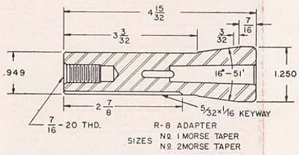

              Looking at r8 collets, they seem to only have 1" of thread in them or less so if you have more drawbar than that sticking out the top before engaging any threads then you have your problem. I can't find any that have 40mm of thread due to the collet slots running up close, so it could be the short slots are too stiff to grip properly.
              #543306
                Posted by Dave Halford on 05/05/2021 12:40:30:
                Looking at r8 collets, they seem to only have 1" of thread in them or less […]
                Although showing a Morse socket, not a collet … Post #10 here: **LINK**
                https://www.practicalmachinist.com/vb/bridgeport-and-hardinge-mills-and-lathes/problem-new-r8-tooling-threaded-rod-192636/
                … is a useful reference.

                  I like the drawbar to hold at 2 diameters, 7/8" deep in the tooling, and since the museums Tom Senior R8 spindle does not have the internal pin, all the tooling gets a 7/16 UNF tap run down it, the threads cleaned and lubricated with moly grease. That maximises the drawbar holding power. As well as not holding properly, an undersize tool in an R8 collet will cause the whole thing to close up more than it should and be pulled deeper into the spindle. That risks bottoming out the drawbar as well.
