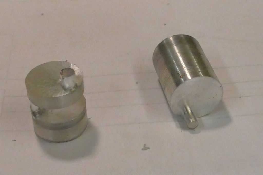

              Here are the test pieces from my Gcode. They are machined from a slug from a Rotabroach cutter which I saved for uses such as this and are 20mm diameter (roughly) and 25mm long.
              Pins are 5mm diameter on a PCD of 14mm. Offset from one to the other is 120 degrees. Cutter was 1/4" 2 flute.
              The pause from one pin to the next in the video is due having to edit the code for the offset of 120 then manually move the x axis then reset the a axis to zero to avoid a long reverse rotation to zero plus offset before running the code again.
              Martin C

                Thanks for that Martin, certainly seems to do the job and the machine sounds a lot happier than Geoff's one. I like the small movement in Y each time the depth of cut is increased which saves the cutter plunging into the work and the two finishing passes look to leave a less barrel shaped pin. Easy to see the shape that the end of the cutter leaves at about 3.10 into the video where it makes the first pass on the second pin.
                I was thinking that another way the barrel shaped pin could be reduced is to use a cutter that has a diameter less than the gap between webs say a 6mm cutter for a 10mm gap which would need two runs through with a 4mm movement in X for each pin.
