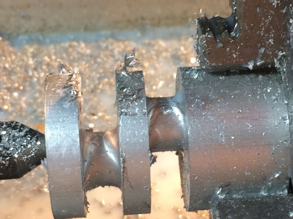

        iam working a midget engine and wanted to rough out the journal on the cnc mill i wrote a program but Jason B sent me link for program all i had to do was enter the stock dia the throw of the journal and dia of journal
        if anyone is interested in the program iam sure Jason will post the link
        iam very impressed very easy to set up
        Geoff
        #450407
          That is better than the usual thump, thump, thump of turning from the solid. I wonder if a flat ended ctr cutting bit would work better than the rounded one you were using as the cutting speed at the edge of the tool should be faster.
          For those interested the program is one the late John S wrote and used to demo the Sieg CNC machines at shows. Works straight out of the box for machines like the Sieg that have their 4th axis on the right but needs a slight tweak if it is on the left.

            that would make life simple…if only I ever dared to fit my 4th axis. Why not go the whole way and cut to size with a flat tool? Surely a good finish is possible? My cnc computer got filled with dust and went pop earlier in the week so had to drill 300 holes by hand, awful job! Time to build a decent enclosure for the pc and driver box so it doesnt happen again. Theyre great when they work!
            #450418
            geoff adams
              @geoffadams14047
              the cutter is an 8mm flat slot drill i think its the video gives the impression its a rad cutter

                    Anonymous
                      Posted by fizzy on 02/02/2020 17:28:52:
                      Standard endmills and slotdrills are not flat on the end. They're slightly hollow ground, so you end up with a barrel shaped crankpin not a cylindrical one. The problem can be ameliorated, but not eliminated, by offsetting the cutter.

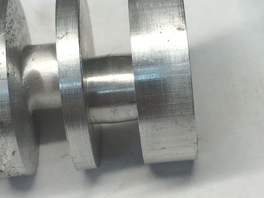

                                  Emgee, Yes, that is the one Geoff used.
                                  Old Mart, no the middle of the pin is slightly raised due to the shape of the end teeth of a typical cutter as already mentioned by Andrew as the cutter always stays directly above the pin's ctr line by moving in the Y axis.

                                    No, Jason, if the cutter stayed above the pin centre line the centre of the pin would be larger. Clearly the cutter centreline was offset as the machining marks confirm, making the pin smaller in the centre.
                                    #450609
                                      I agree that the one Geoff has shown does appear to have fillets in the internal corners which suggests something is off, which is why I thought a ball nose cutter was being used.

                                            geoff adams
                                              @geoffadams14047
                                              Morning all from the replies it seems that i have the y axis off creating a fillet in the corner
                                              the a axis is left on the mill all the time i will check the set up this morning. mach 3 does lose it self, i relied on it remembering the y offset
                                              anyway off to specsaves this morning to pick up new glasses that might help will let you all know how i get after resetting and checking the setup and running another test piece
                                              thanks Geoff

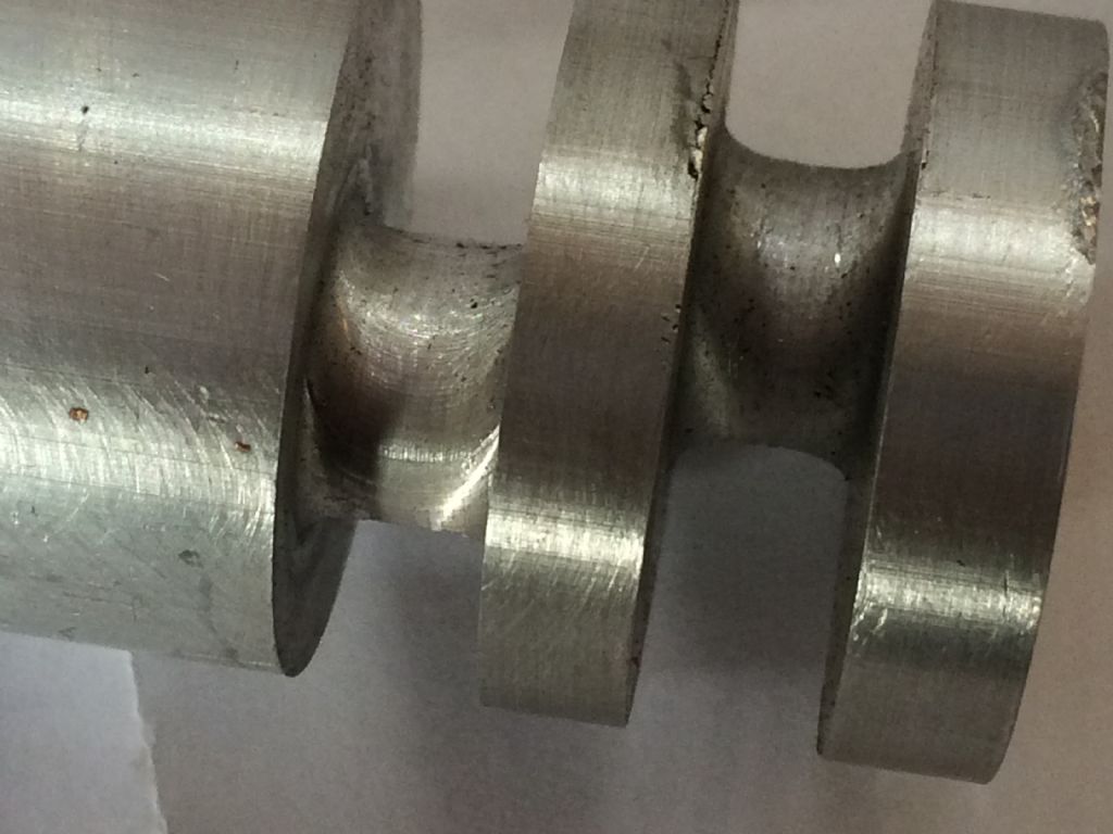

                                                img_1054.jpgchecked all settings bit of a blonde moment when setting the y axis used edge finder as 4 mm dia should be 5 mm so .5 mm off center now no fillets but it looks to me that the journal has a slight rad ?? any help please
                                                Geoff
                                                #450701
                                                Baz
                                                  @baz89810
                                                  Hi Geoff, crankpin will be barrel shaped due to your milling cutter being hollow ground by a couple of degrees, you could grind milling cutter truly flat across the bottom or I think you can do another pass around the journals but with Y axis offset by just under half the cutter diameter, this should just flatten off the high spots.

                                                  old mart
                                                    @oldmart
                                                    Now you are seeing the cone shape because the end cutting mill leaves a surface higher in the centre. You could get the journal truely cylindrical with an infinite number of passes, each offset by an infinitely small ammount. You will only get the journals parallel if the tool has a flat end. The end product is a roughed out crankshaft ready to be finished turned , or ground.

                                                    Anonymous
                                                      Even with a flat bottomed cutter you don't get an exactly cylindrical pin. Assuming a finite number of flutes on the cutter you end up with a series of facets that are on a helix. On a practical note the centre of the cutter will be operating at a very small surface speed, so it is likely that the surface finish will vary across the pin.
                                                      Andrew
