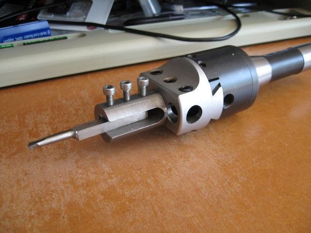

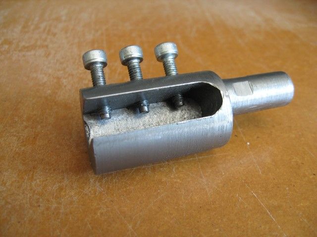

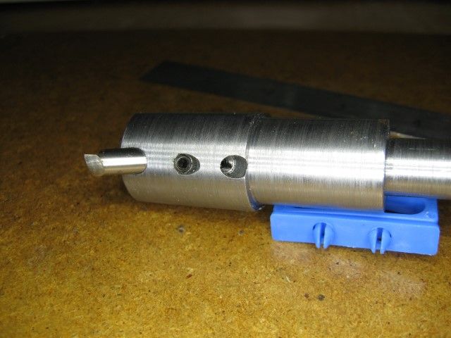

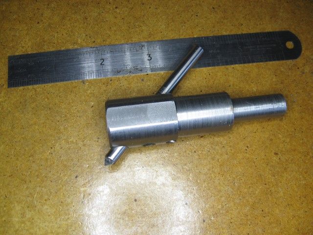

                Hi Tim,
                Here are two holders I made to allow the use of round and square HSS tools in the boring head.
                HSS tools could be ground to cut on the outside of a cylinder with the boring head rotating in the normal direction to avoid it unscrewing from the arbor.
                Les.
