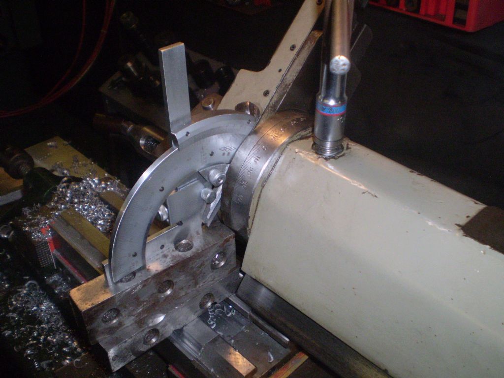

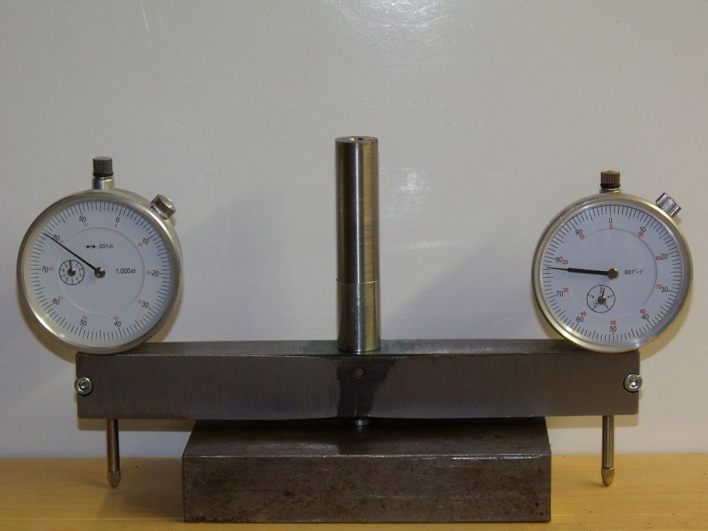

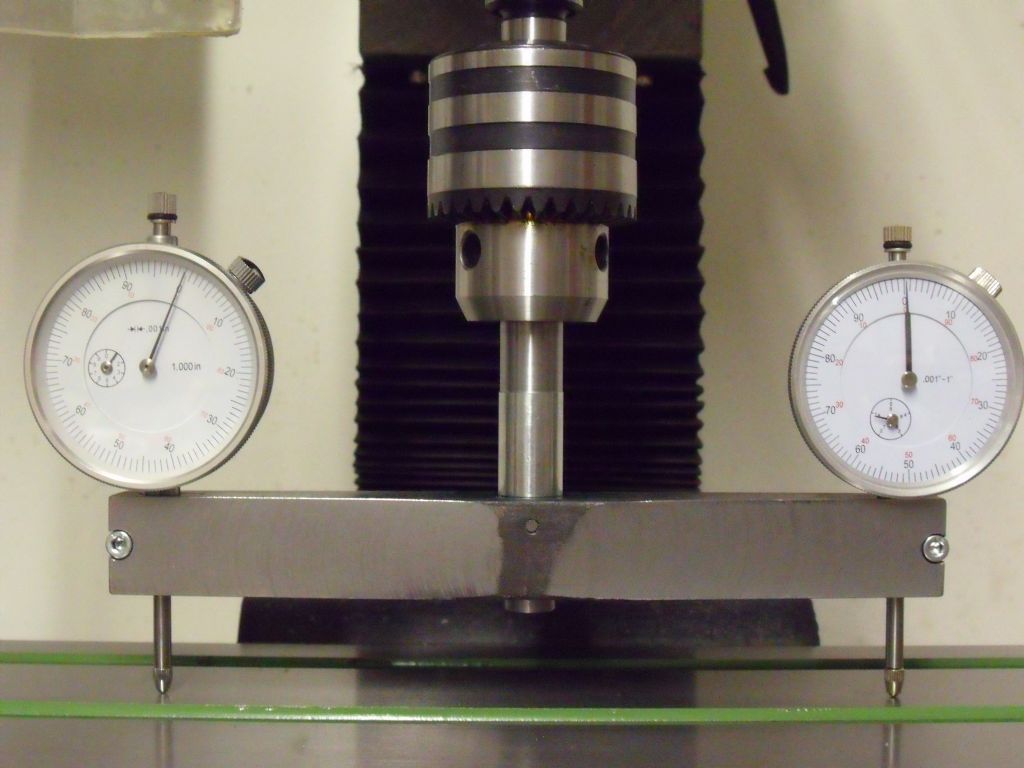

                Hi Lee, Guys,
                Two things here, first it is almost impossible to accurately set the head at an angle of 45 degrees, which you will find out when you come to mate it up with the face that it is supposed to fit.
                Second when you come to re-tram the head you will find that as soon as you tighten the securing bolts the head will move slightly. I've spent hours tramming the head on my mill and whilst it is now nearly spot on you will find that the tram moves as soon as you tighten the head locks. Not only that but the tram will change with the position of the head on the column.
                I even went as far as making a tramming tool that gets me spot on ! Until I tighten something up.
                Edited to add pictures
                Here its just sat on a steel block.  Since this picture the dial gauges have been changed for a pair of 0.01 mm identical ones.
                This picture shows it in use. The out of tram is quite obvious, nearly 5 thou.  Using this tool I can get 1/2 a thou sometimes.
                Edited By John Baron on 21/05/2020 10:17:42

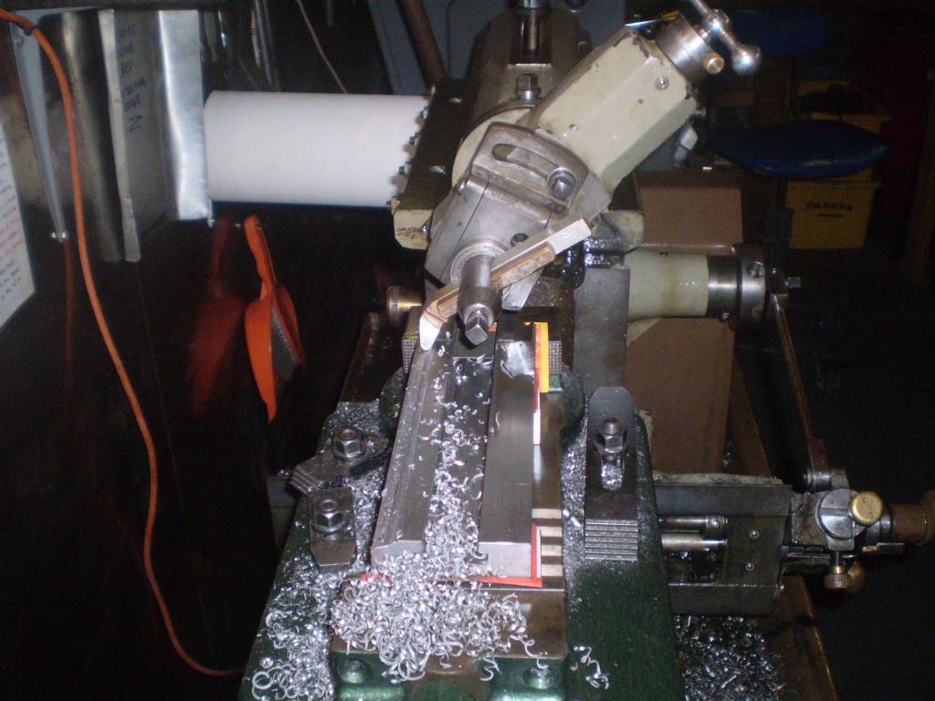

                    Actually its quite easy. Scribe lines to represent the centre line and "V" edges and work to those.

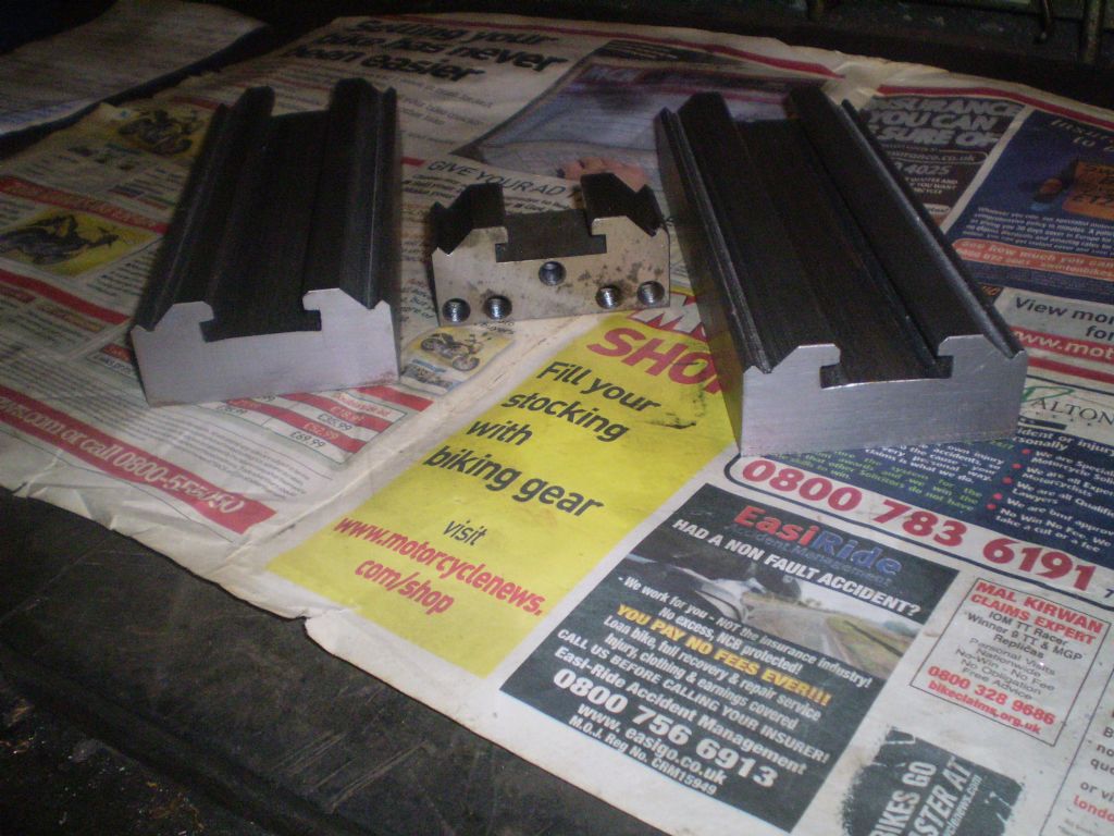

                    thaiguzzi
                      @thaiguzzi
                      Posted by Michael Gilligan on 21/05/2020 08:10:26:
                      Go for it, Lee …
                      ‘though it’s interesting to ponder how much simpler it would be to cut the vees on a shaper.
                      #473509
                      Lee Jones 6
                        @leejones6
                        Show off. laugh
                        Don't suppose you want to make me some, do you? smile p
                        Edited By Lee Jones 6 on 21/05/2020 10:51:14

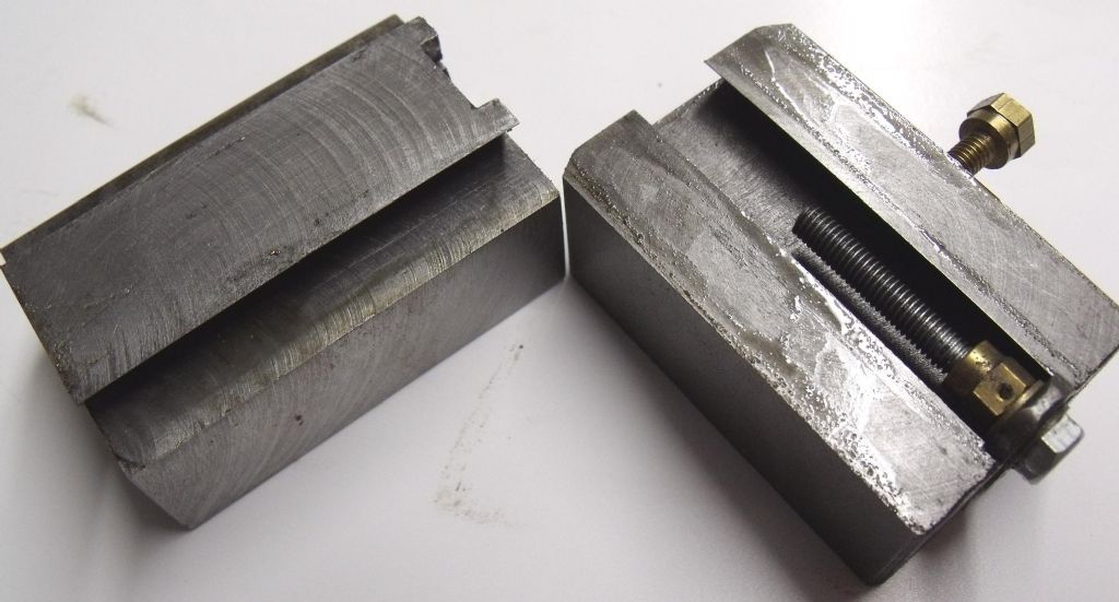

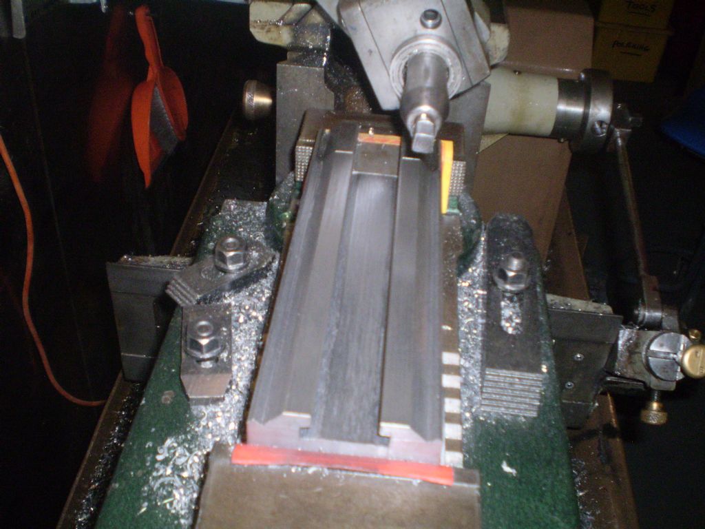

                        #473513

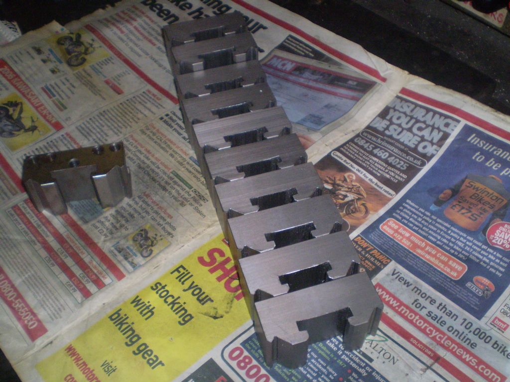

                        thaiguzzi
                          @thaiguzzi
                          Posted by Lee Jones 6 on 21/05/2020 10:50:32:
                          Show off. laugh
                          That was a block of steel to make 5.
                          No probs in making some more, but the postage back to Blighty could sting a bit…..
                          #473515
                          Lee Jones 6
                            @leejones6
                            That's my plan, although I'm limited to 4 at a time with my set-up.
                            It's okay, I was only jesting.
                            My plan is to make say 4 or 8 of my own and buy some from knock-offs when they come back in stock.
                            Yours look amazing by the way.  Are they T1s or T2s?
                            Edited By Lee Jones 6 on 21/05/2020 11:00:48

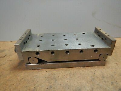

                                      #473526
                                      Lee Jones 6
                                        @leejones6
                                        This is what I have in my head.
                                        In what way would you use the DRO to build the sine plate?
                                          Actually fairly easy to get the head to 45 degrees using a sine bar set to that angle & a DTI, basically you 'tram ' the sine bar.
                                          All heads will move when the bolts are tightened so you have to allow for that movement so when the bolts are tightened up fully they move the head into the correct position.
                                          Tony

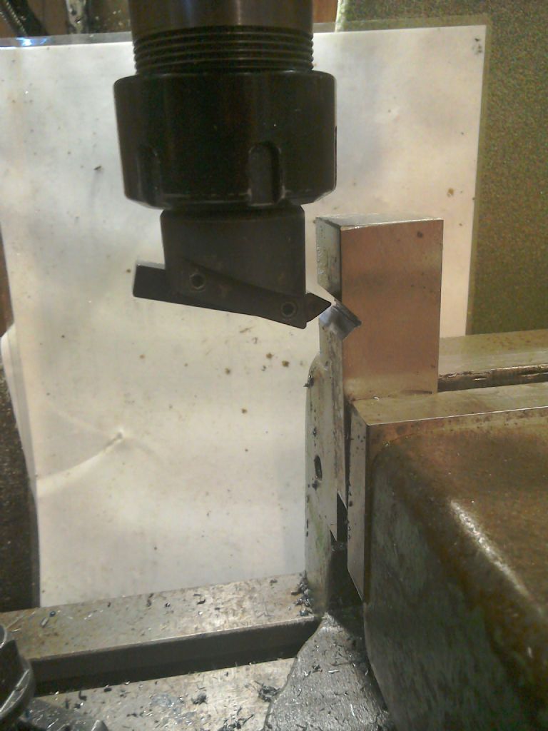

                                                #473577
                                                John Baron
                                                  @johnbaron31275
                                                  Hello Martin, Guys,
                                                  That is basically how I cut the dovetails for this slide.

                                                    Clive Foster
                                                      @clivefoster55965
                                                      Lee
                                                      Got it in one!
                                                      The point about using a DRO is that it makes it pretty much routine to get the spacing of the two rods and the ledges they butt up against correct to any practical level of accuracy. Its equally easy to make the riser block required for whatever angle you want to sufficient accuracy.
                                                      Equally getting a nice regular pattern for the tapped holes is almost trivial. Consider locating dowel fittings to get the fence square or make the fence L section so the working part is above the table and trim it dead square in situ.
                                                      Plenty of variations on the theme to get the best balance between what material you have on hand, what machining facilities you have and what you plan to do. I'd probably make flat bottom Vee carriers for the rods with bolt holes to fix to the table or riser. Rods sticking out about 1" each side for clamps. Except for very shallow ones risers are probably most convenient to handle if made with tapped holes in top and bottom. Top ones take the Vee trough for the rod, bottom ones hold a plate extending either past the ends or to one side drilled so it can be bolted to the table. Shallow ones would need the fixing plate and riser made in one.
                                                      I'd make the riser in situ. Start with some stock a bit too deep, fit bolt holes, fix to base, bolt on machine table and cut it exact to size. Fit Vee troughs and sine plate and get to work.
                                                      Or you could make a complete unit on its own baseplate like the one in your picture. Invert it to bolt the riser on. Simply clamping the rods to a flat top ought to be satisfactory. Especially if you use the proper sine plate layout with deep ledges. Although I'd go for shallow ledges and a Vee trough but realistically its 6 of one half a dozen of the other.
                                                      Being a lazy type I'd probably base the device around a drilled and tapped 1/2" thick alloy breadboard from optical suppliers like Thor Labs **LINK** . The smaller ones aren't too silly spendy but double density versions might be a little too much. Something in the 8" x 8" to 10" x12", 200 x 200 mm to 250 x 300 mm might suit. The anodising is tough. Some stiffening underneath would be desirable for most jobs. Glued on strips perhaps.
                                                      The drilled and tapped breadboards are roughly comparable in price to 1" aluminium tooling plate or ordinary 25 mm steel plate so its not an unreasonable way to go about things.
                                                      So DIY "all new" you are in a similar price range to an import 4" tilt and swivel vice or a bit more than a swivel 6" vice. Much, much less if your finder-fu is good on used and handy scrap.
                                                      Its what I would do if starting out saving maybe £3,000 on stuff I'd most likely no longer need to have. Probably half of which I've not exploited. My finder-fu is usually pretty good too.
                                                      With a bit of creativity in the fence line, think limitless vice and carved in situ style, a device like this can make a larger machine vice unnecessary. If one piece style you can take it to the bench for preliminary set up too, of-times on a smaller mill the head gets in the way.
                                                      Clive
