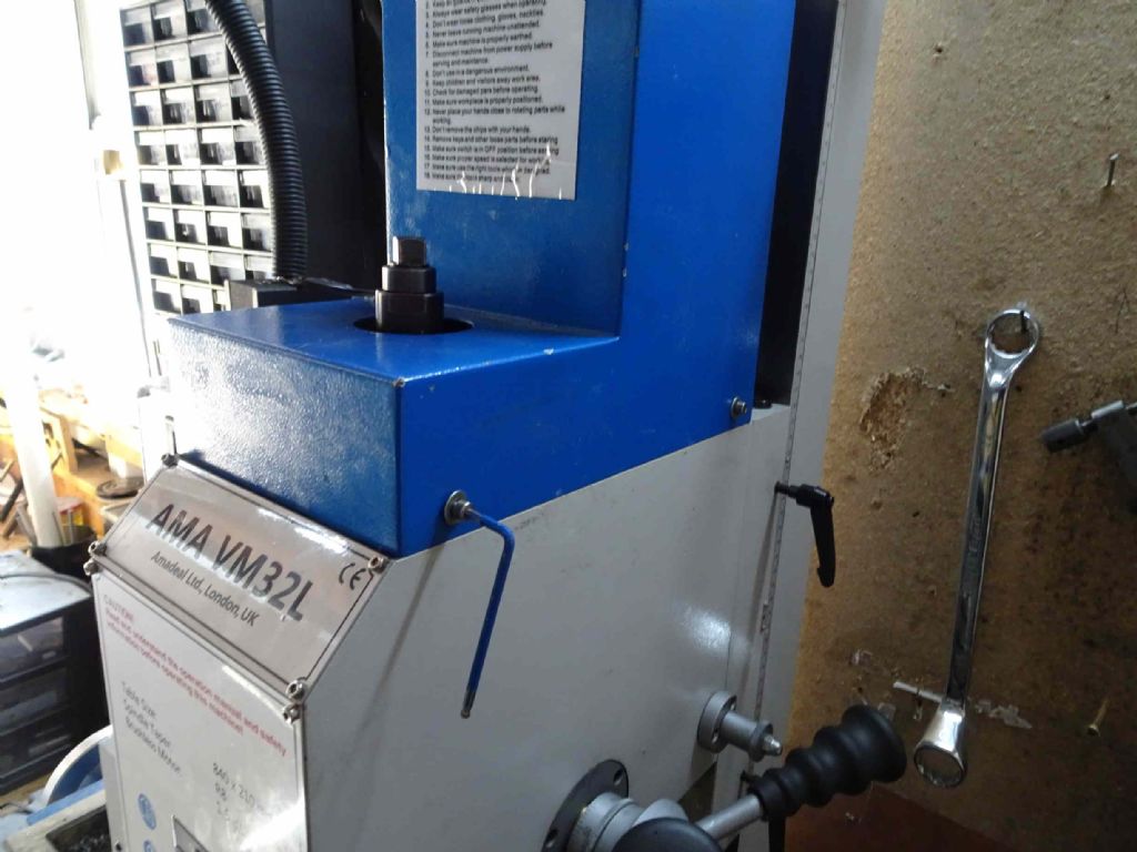

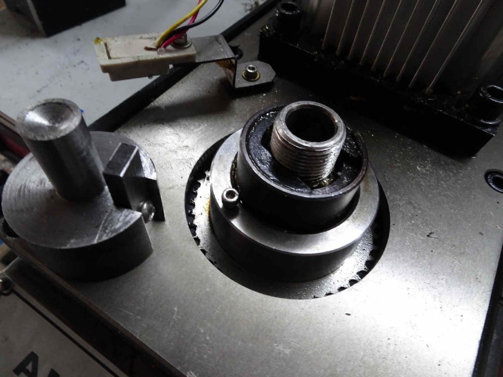

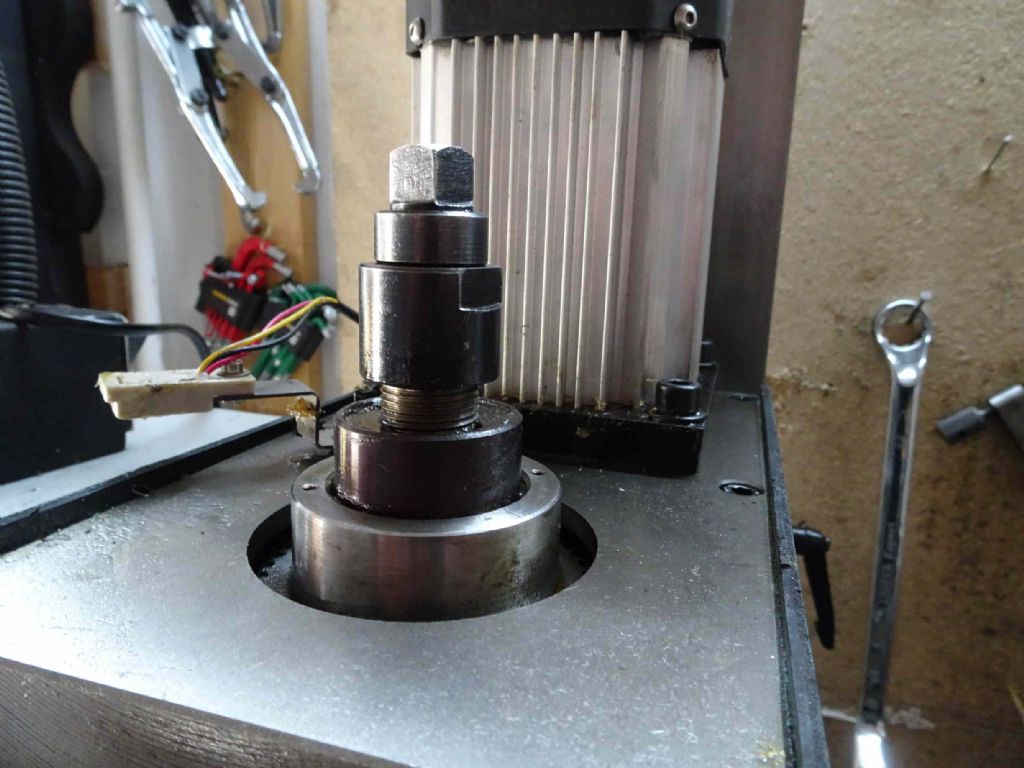

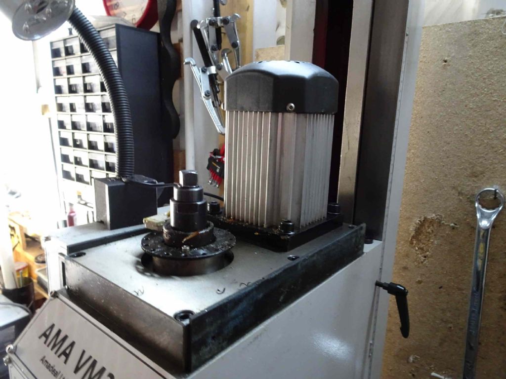

                                  Hi, all.
                                  I've actually used two bars and some round toolbit, all of which give deviations. However it's worth double checking. I did check for roundness with calipers when I got it, but have not so far tested to see if it is bent.
                                  Today I started taking the spindle out, but rapidly got stuck.
                                  First the top cover
                                  Inside looks like this
                                  Remove the drawbar and the 'retainer cup'
                                  Then I got stuck
                                  So there's a thing which looks a bit like a circlip (part 201 a 'position washer) but with the straight sides.- sorry not a particulary good picture. it will move about 10 degrees and then stops. I made the thing on the left because I thought it unscrews and needed a bit of help (I've learnt about bearings and hammers). However, it doesn
                                  That was me having a thought and a quick trip out to the shed. In the diagram there's a spring under the assembly and I wondered if I could push the bush down and release the position washer that way. It turns out I can indeed push the bush down, however, I am now showered and about to embark on the barbeque (who knows when we'll get the chance again) and the wine, so not a good time to start messing with dirty machines again.
                                  I will report back tomorrow all being well.

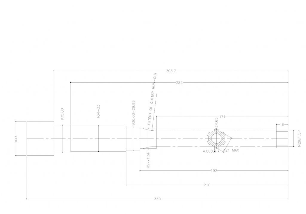

                                    #471366
                                    Graham Meek
                                      @grahammeek88282
                                      I eventually found the rough sketch I made of the defective spindle which was eventually salvaged. Just in case anyone finds themselves in a similar position and need to make a new spindle I have uploaded a rather poor Jpg drawing.
                                      If there is a requirement for a better image of this drawing then I can furnish a PDF. If there is a method to make this available to the Forum, this would save a lot of exchanges of emails. Perhaps Neil or Jason can help here?
                                      Regards
                                      Gray,
                                      #471376
                                        Hi Gray,
                                        If you email me a PDF I can make it available on the forum.
                                        Thanks

                                                #471490
                                                  Gray has kindly sent me the PDF of his R8 spindle drawing. To make it easier to upload I've shortened the name but it is here:
                                                  Graham Meek's Cracked R8 Spindle Drawing
                                                  Thanks Gray!
                                                  Edited By Neil Wyatt on 13/05/2020 19:02:31
                                                  #471493
                                                    Thank you both … Gray & Neil
                                                    I remain slightly bewildered however … as I was hoping to see a section showing the thin wall and any stress raisers in the defective original.
                                                    Just for ‘academic interest’
