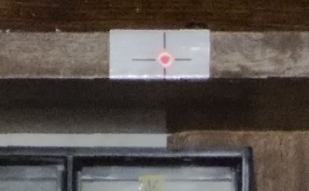

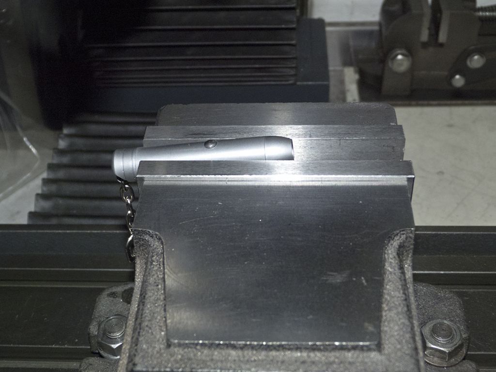

                                Fowlers Fury
                                  @fowlersfury
                                  Drifting off-topic a little to lining up the milling vice……
                                  I'm with Clive F's 4th para "Personally I'm not great lover of keyed vices…. etc"
                                  Easiest & quickest way I've found is to lightly grip a (dedicated) laser pointer in the vice jaws, wind out the table to its stop, rotate vice until laser lines up with mark on workshop wall and then tighten down.
                                  (To accurately position the mark on the wall the first time, needs an accurate parallel in the vice and a dti).
                                  #355941

                                    #355948
                                    Fowlers Fury
                                      @fowlersfury
                                      NDIY ~ "How far away is your wall?"
                                      Answer:- governed by my old-age myopia sad. I need to be able to see the 'target'.
                                      It's about 10' from the mill but obviously the farther away the better in terms of accuracy. Here's 2 images, the 2nd (poor quality one) shows the 'target' on edge of a shelf. I found that a piece of that self-adhesive aluminium foil was best. The laser pointer was a cheap, red beam one but has a tough alloy body. In use you have to remember to ensure the table is 'wound out' fully of course or it'll give rise to erroneous settings.

                                        #355962
                                        Anonymous
                                          My machine vice is normally placed roughly in the middle of the table. A rotary base isn't an option on my make of vice, and I wouldn't have one if it was. Neither do I use keys, although the vice has slots machined for them. The vice gets moved across three milling machines and the T-slots vary by a few thou from machine to machine, so not accurate enough for me. I prefer to indicate with a DTI on the back of the fixed jaw to ensure it is parallel with the table movement. I'm happy if I get better than a few tenths (0.01mm) over the 6" jaw width.
                                          On the odd occasion the vice temporarily needs to share the 48" table on the vertical mill with something else, in which case it is placed at one end. But I don't leave dividing heads and rotary tables on one end of the table if they're not being used. Having a 100lb plus dividing head hanging off one end of the table makes it darn hard work winding the handle, and is a sure way to wear the feed screws and dovetails. It might even bend the table. Rumour has it that the original Bridgeport mechanical table feed gearbox was so heavy it could put a permanent set in the table.
                                          Andrew
                                          #355964
                                          Fowlers Fury
                                            @fowlersfury
                                            Re. Ian P's posting
                                            I claim no originality for the method, just my adaption of a published way to ensure a mill head was reset to a predetermined position.When critical work is undertaken then I have often checked vice jaw alignment with parallel and 'finger' dti. The laser spot was always on target. The method takes no account of ambient temperature effects on the mill table & vice. But I offer it only as a not-so-rough and ready method of quick alignment which is certainly capable of improvement.
                                            How does this idea work?
                                            That once set accurately, the laser will reposition the vice jaws parallel to the X axis.
                                            When you wind the table out what does it stop against?
                                            <> The table on my mill comes to a "dead hard stop" when wound out so no uncertainty.
                                            How do you know the laser beam axis is truly parallel or concentric to its outer casing?
                                            <> I don't but since it's always placed in the vice jaws at the same position as it was when the vice was initially set accurately with parallel and dti, I don't see it as an issue.
                                            How rigid is the wall or the machine mounting, say its a wooden floor or flimsy shed.
                                            <> FWIW – concrete floor, double thickness brick walls, mill on a steel framed bench.
                                            Edited By Fowlers Fury on 30/05/2018 22:36:17
