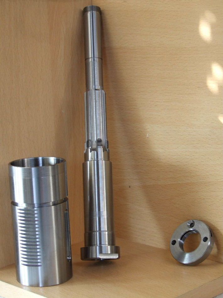

                                                  As regards making a new spindle the socket would be the last thing to do in my book. There is always a very good chance with the amount of material being removed that the new spindle will distort due to the locked up stresses in the bar stock. Far better to rough out and finish machine such an item.
                                                  This is how I made the spindle below,
                                                  Regards
