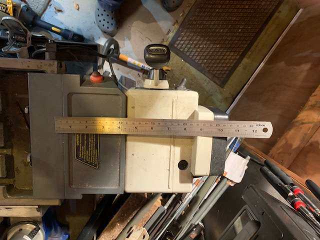

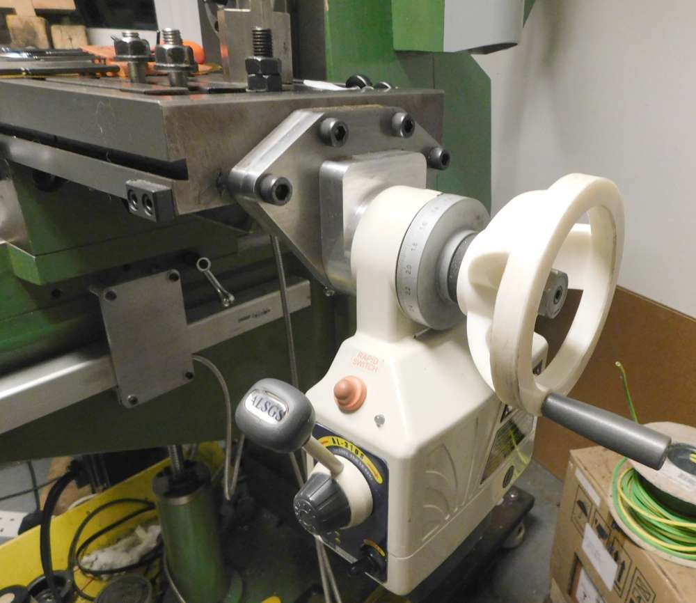

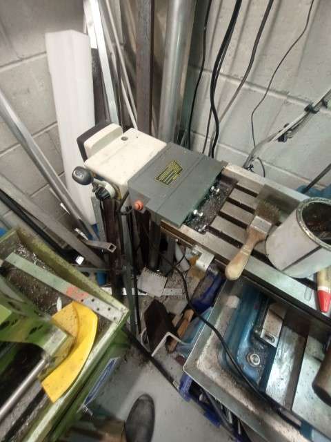

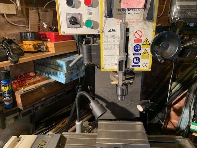

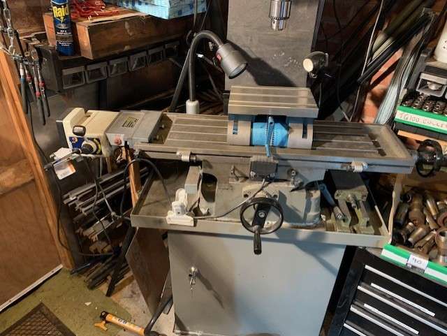

                            Hi Taff, I typed out a long message and it got lost during the photo insert grr!!! Will try again. As you can see I have attached a few photographs of my mill with the unit fitted. It’s an ALSGS purchased from Axminster in 2020. One of the photo’s has a rule to give you some indication of the overhang. The entry door to the left was remounted to open out as I thought I may need to open the door at times if the table was fully extended to the left. As it happens I have never had to open the door for milling. Regarding a DRO I purchased a three axis DRO and to be honest I have never used the Z axis reading. I purchased a digital caliper and mounted it as shown. This gets used a lot during milling. So if I were you my first priority would be to buy a two axis DRO before a power feed. The DRO is so much more useful and convenient, makes milling a pleasure.
                            Mill power feed 1Mill power feed 2Mill power feed 3Mill power feed 4Mill power feed 5

                                Alan, That is some extremely good info, thank you for taking the time to post it. It has made very clear the actual size of the unit, Not quite as protruding as I expected. Really appreciate it. 👍

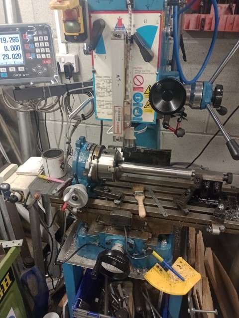

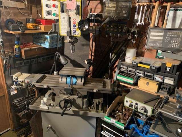

                                                peterhod
                                                  @peterhod
                                                  Hi
                                                  I joined the forum as I saw been following your posts about your mill for a while. I have the RF40 mill drill the round column version of your mill. Same table and head.
                                                  I have one of those cheap horizontal drive units and it’s good. I was dubious about the mounting myself and just put it on so that I could use it to make a better mounting. 9 years later it’s still working fine. It has plenty of power I use a 50mm face  carbide face mill in mine. The only problem with mine is that it doesn’t feed slowly enough for small cutters but ok down to 6mm, maybe I’m expecting to much.
                                                  Here is my machine with 3 axis DRO.
                                                  IMG_20250108_181449491_MFNR (Small)
                                                  IMG_20241212_192215935_MFNR (Small)
