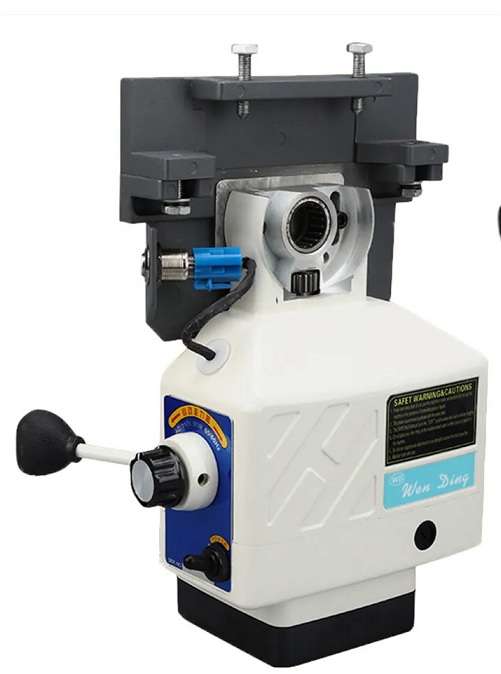

      Morning all..!
      I am wondering if anyone has one of these generic chinese horizontal power feed units (with the suspect looking mount!).
      Horizontal_Powerfeed
      If so how well does it work, how well does the manual feed work with it connected (how stiff it is etc)? Does it really stick out as much as it appears to?
      I was going to build a power feed out of a decent (ish!) 24v worm gear motor (wiper motor type with keyway) that can be engaged / disengaged as required.
      The reason for the question really is I can get the above ready made unit for about £140 which by the time I buy a motor, PS, PWM, materials etc and a fair amount of time to do the job makes the  ready made unit possibly a better option
      – however –
      The above unit is listed as about 300mm long (with or without the mount?) so sticks out a fair bit (and weighs 6kg!!) and I’m short of room where as a home built unit I could probably limit it to no more than 100 – 150mm  more than the current hand wheel and would add much less weight to the end of the table.
      Any thoughts greatly appreciated 🍻

        It may help others who have used similar units, if you quote the make and model of that specimen. At the size given, it is probably intended for Bridgeport turret-mills and larger.
        #774672
        Taf_Pembs
          @taf_pembs
          Well pointed out Nigel, I forgot to put the link in.
          This is the horizontally mounted Power feed intended for the RF45 type mill table rather than the vertically mounted type suited to the Bridgeport style mill.
          It is essentially the same type as the Chester supplied unit.
          https://www.ebay.co.uk/itm/135175196171?

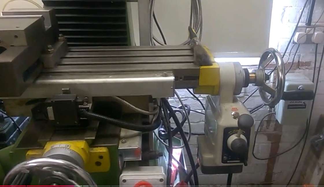

                Taaf_Pembs (and Hollowpoint)  I bought a Warco VMC mill when I returned to the UK in 2015 and ordered the X-axis power feed at the same time. It was LOT cheaper then, but as Nigel has said, it was a 110V unit requiring a transformer – also supplied by Warco. It was an Align unit – like this one so more spendy that the one Taf_Pembs linked to. As you can see from the picture below, I suspect that the 30cm dimension referred to the height, not the protrusion beyond the end of the table.
                X-axis power feed
                The power transformer is the wall-mounted box on the right.  I would agree with all the points raised by Nigel.  Having said that, it was a worthwhile addition to the mill.  If I ever bought another mill, it would be the second accessory to add, after a 3-axis DRO.

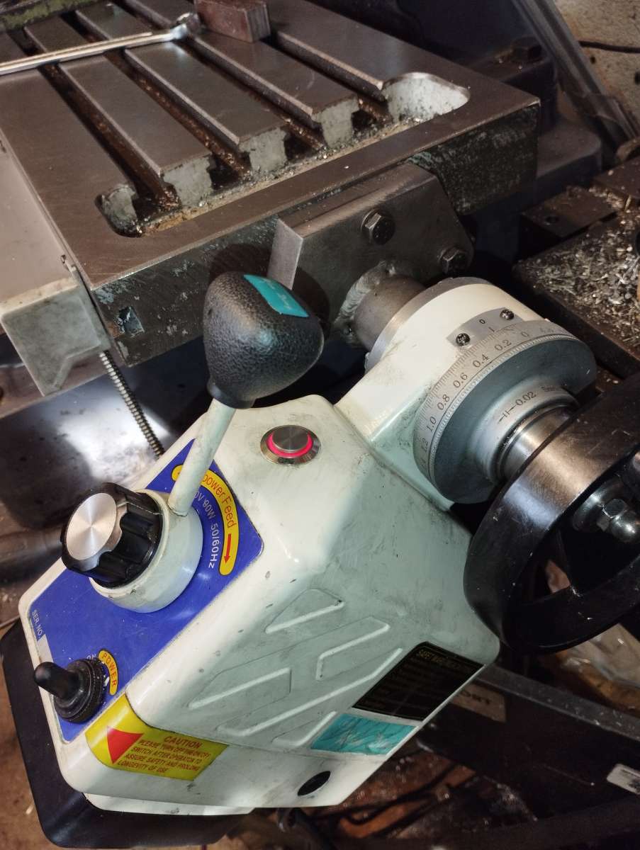

                  I have one of these, apparently mine is a genuine Align unit (the original maker) supplied modified with the black adapter as you show for mill/drill fitment. It did not take long to determine that the supplied adapter was more or less useless. It was impossible to maintain correct mesh with the gear that you need to fit to the leadscrew due to the screws moving on the draw in the table pockets.
                  I made up an aluminium block mounted on the table end bearing housing. Here is a photo. The wing nut allows the power feed unit to be removed, and the hand wheel can then be refitted  but in practice never necessary. If you think more detail would be helpful, I can try to take a couple more photos when I have time.
                  To answer your questions, as now fitted to my mill/drill, the Align unit works very well considering. The main three position lever operates a dog clutch so that the mid position disconnects from the lead screw, and the remaining hand wheel is only slightly stiffer. To compensate, there is a fast slew button. The feed has a well chosen and surprisingly wide speed range. There is a slight cyclical speed variation that seems due to the large plastic gear in the unit, but replacing it did not change the effect. It does not seem to cause significant problems such as patterning.
                  It does stick out as a long way but I am used to it. And the weight does not seem to trouble the table operation. Overall, a good asset, and I would buy another if the current one failed.
                  Photo 12

                    Now that Malcolm has posted that photo of his installation, it explains the weird attachment block.  I wouldn’t fit it in that orientation, particularly on a hobby-sized machine. I’d be worried that the weight of it might cause the table to flex.  I therefore withdraw my recommendation of the power feed.

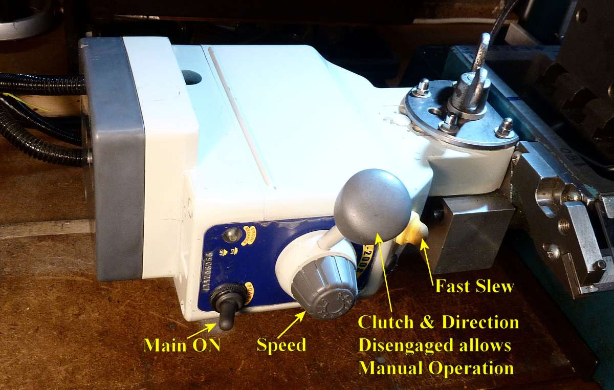

                      Yes, there are quite a few variants, the one I linked to is the 220v version so no probs there and 450in/lbs torque so in the higher region for this type (that is claimed mind!).
                      John, for the mill I have (Chester SuperLux / RF45 clone)  it is a horizontal mount, they do seem to stick out a fair bit and you loose the hand wheel (not that that is much of an issue).
                      Horizontal_Powerfeed_2
                      (Pic grabbed form a google image search)

                          Thanks for that Malcolm, perfect info cheers!
                          I do like how you have mounted it, really didn’t like the look of the bracket it is supplied with.
                          I think with the space I am limited to (way tooo much stuff in the workshop!!) I might have go down the route of making a slimmer one, it would fit until I needed to travel the table to the left then I would probably run into the main work bench!
