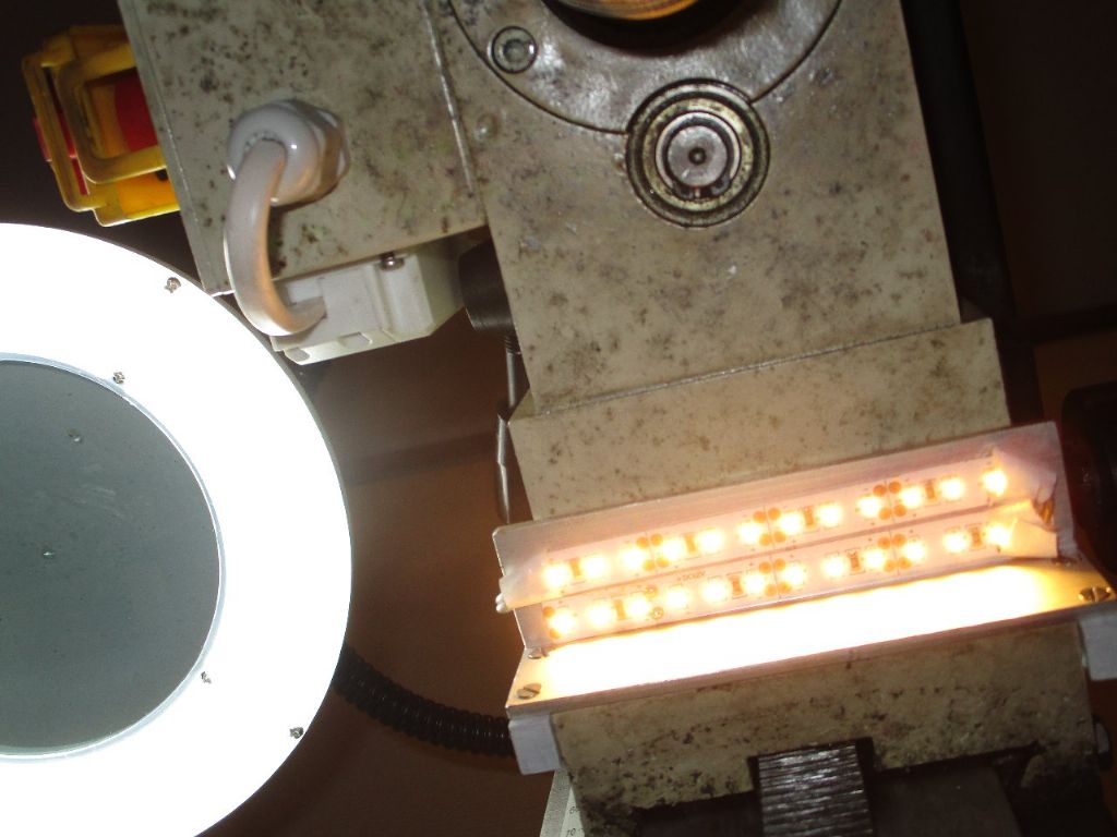

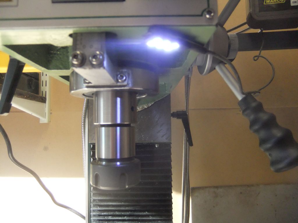

                A friend installed some Led strip lights on my Mini Mill that works well, I also use a LED based Anglepoise lamp.
                 The photo is taken with the lens pointing upwards towards the milling machine head.
                Thor
                Edited By Thor 🇳🇴 on 10/02/2022 10:46:18

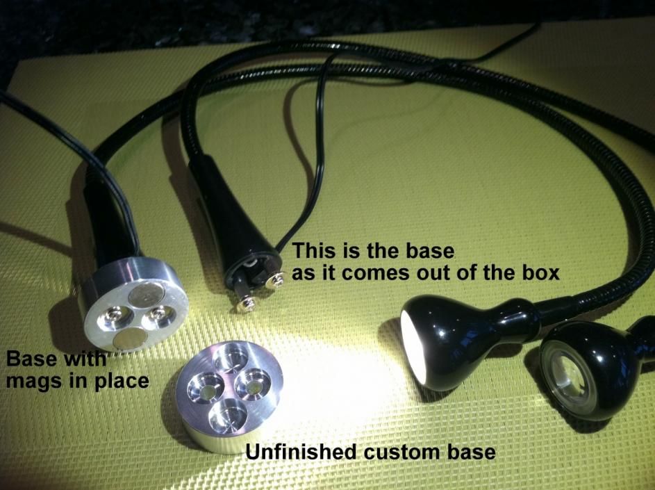

                      I bought several of the Jansjo flexible neck lights from IKEA and made a magnetic base for each. Have one on the drill press, band saw, mill, and lathe. I do want a ring light for the mill and drill press though.

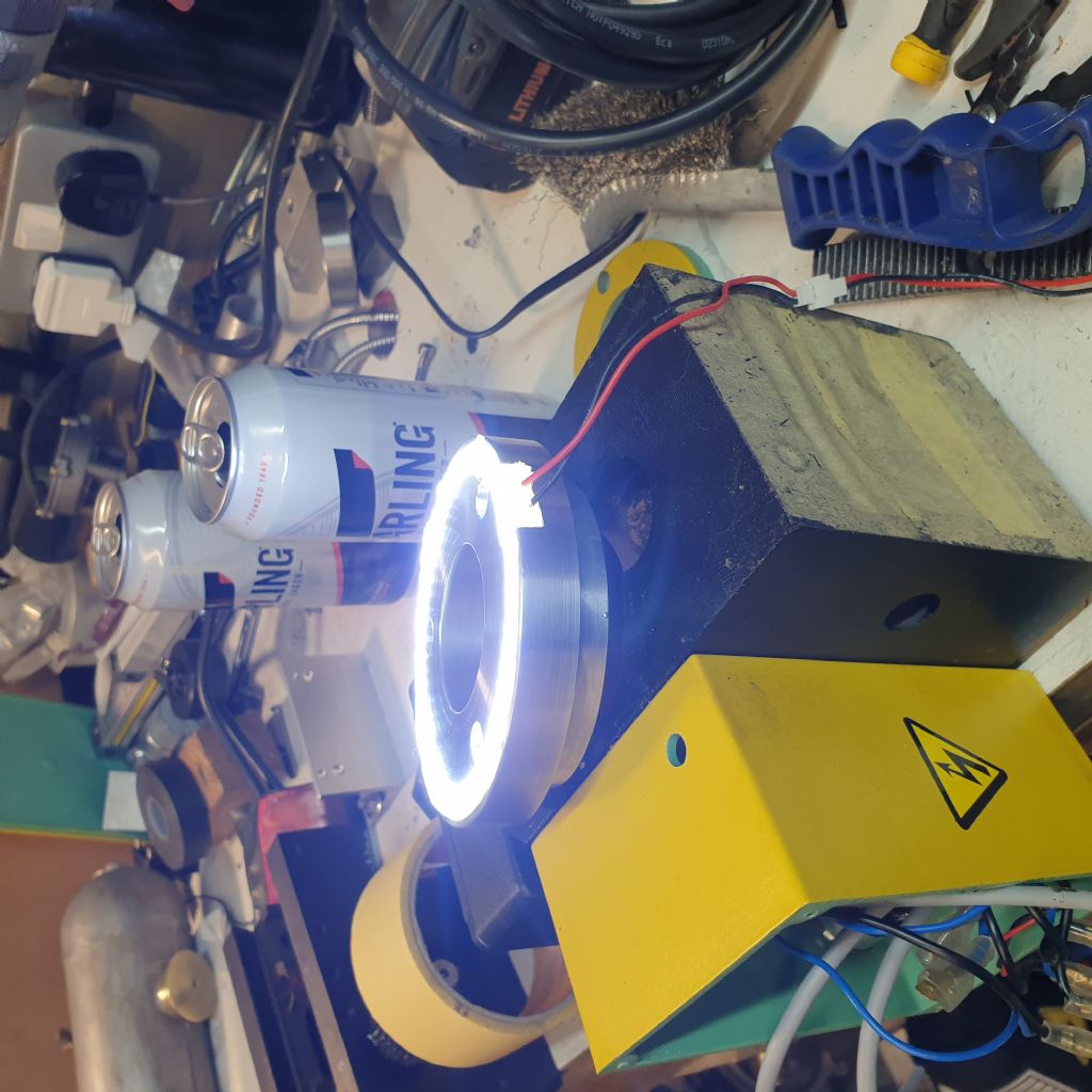

                          Hi I just done mine and is pretty good.
                          90mm angel eyes from ebay dirt cheap but needs 12v supply 20220124_164441.jpg

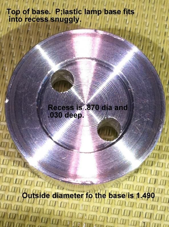

                                      If interested, here's what I used to make my Jansjo bases:

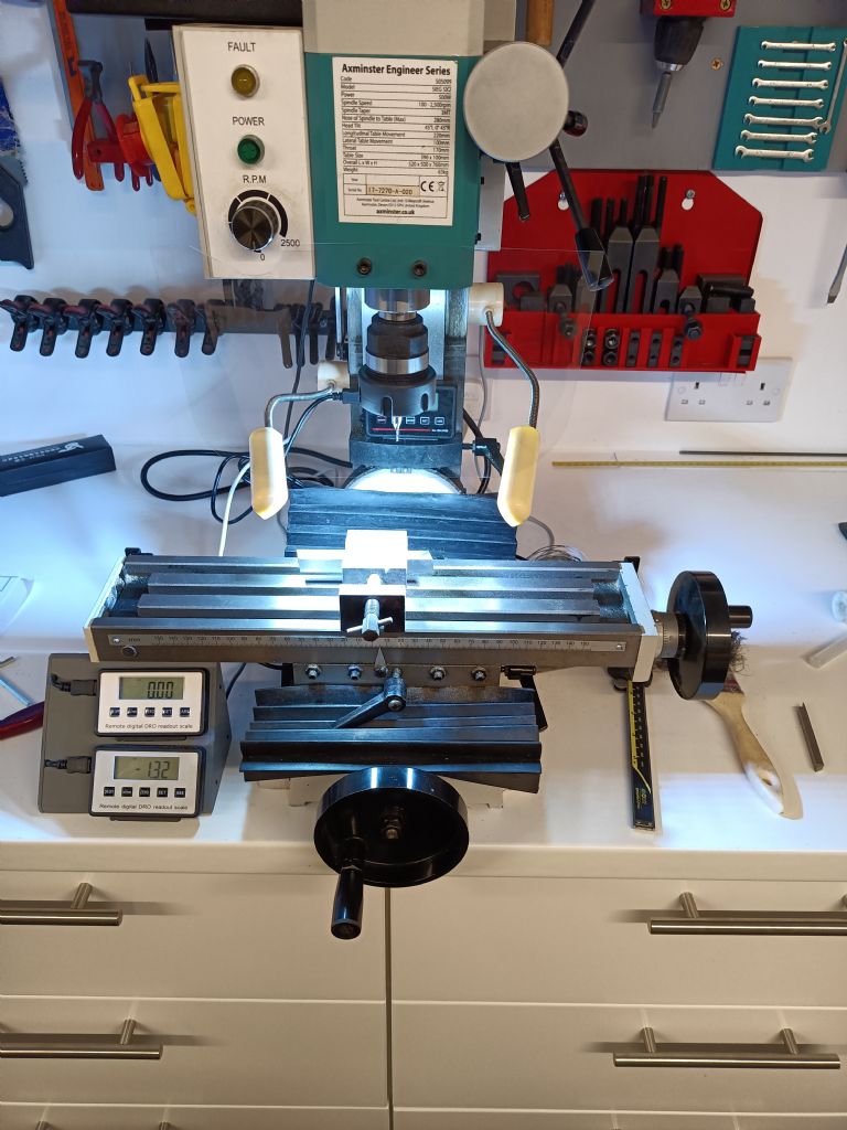

                                          I started with a proper angle-poise machine light on the mill and found glare and shadows to be a problem. Rather than fix this with local light, I painted the ceiling white and installed six 60W fluorescent daylight tubes (3 twins with diffusers). This arrangement floods the whole workshop with light and all but eliminates shadows on workbench, mill and lathe.
                                          Being mounted on the ceiling means they're out of the way of splashes and can't be touched. Most sewing machine and similar lamps aren't intended for workshop use, and whilst safe enough in a dry domestic setting I don't trust them on concrete floors or near well-earthed machines, swarf and liquids.
                                          I think LED striplights would be even better…

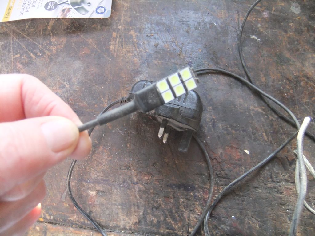

                                            Sometimes you can just kick yourself I suddenly had a thought (I know dangerous at our age) in the workshop I have a small LED light with a magnet to attach it where I can see into the middle of hollow forms.
                                            So I will give this a go when I need it as when the sun is out like today a light is not needed but when the light outside is not so good is when a light source is needed.
                                            Anyway THIS is what I have and no I have never used it on the end of a tool while the lathe is running but only just to see inside for the finish.
                                            This is how much light it puts out only stuck there for the photo.
