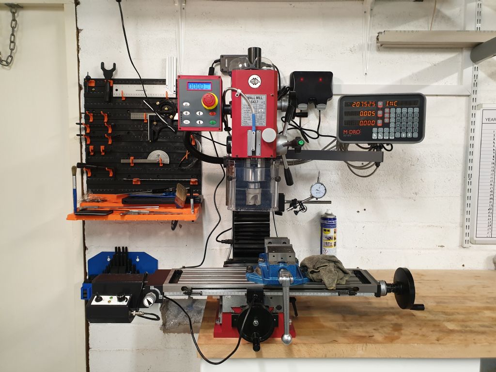

                                        20190403_191605.jpgDunno how well that comes out, but the Z axis isn't that hard to do on the 2.7,
                                        Minor bodge to get the mag reader in place where the stock battery operated DI was mounted then it reads on the main DRO display.
                                        only fine quill feed. (It won't register moving the head up or down)
                                        If you want more photo's just PM me and I'll send any you want.

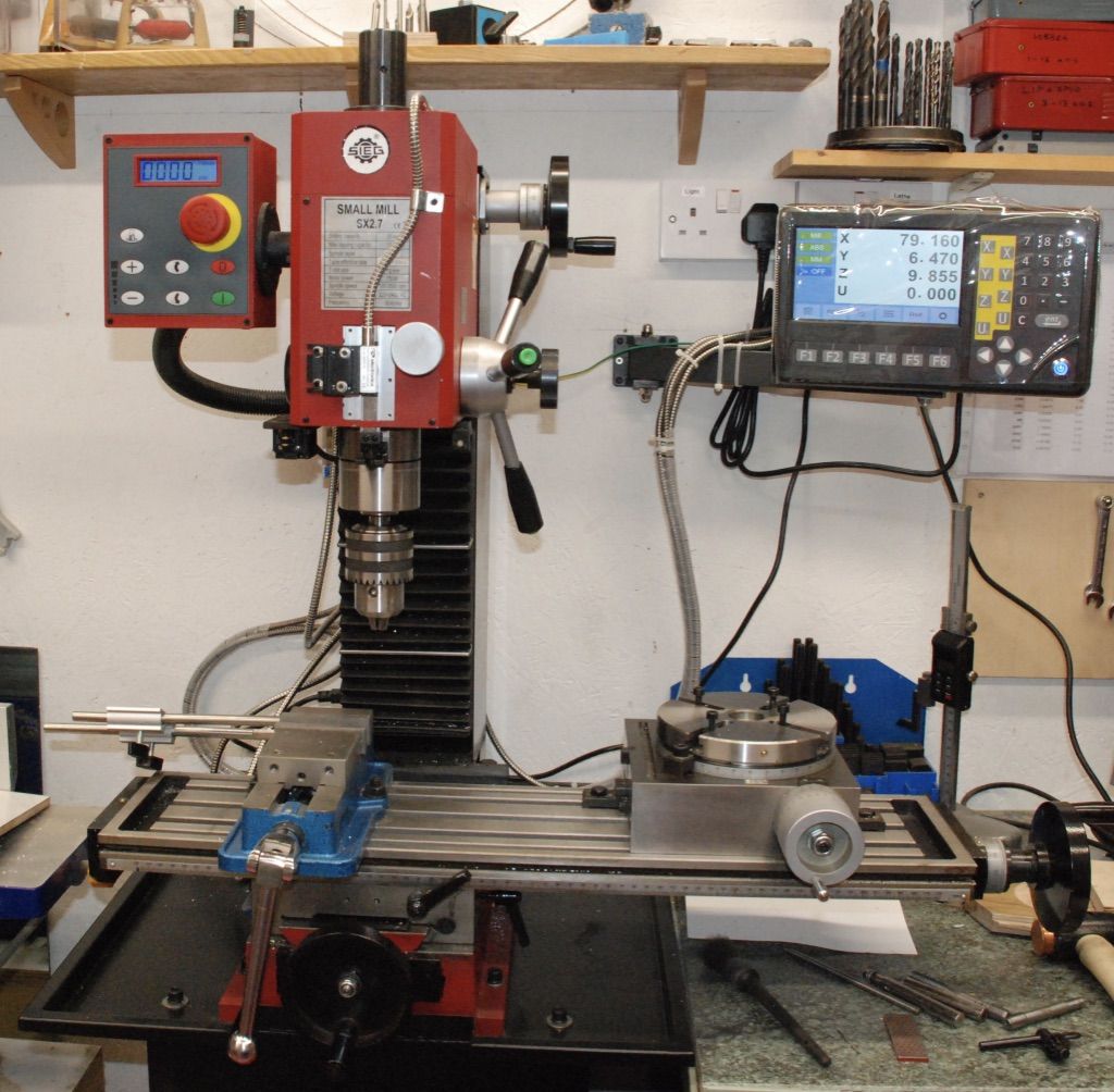

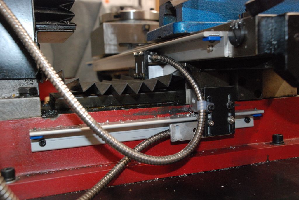

                                            Following on from my question back in June, thought I'd update the post with what I ended up doing in case it helps anyone else.
                                            The mill is a Sieg SX2.7L and I fitted a 4 axis DRO from EMS with scales on X,Y,Z and the Quill (U) to replace the Sieg digital scale which I found a little difficult to read. The Z axis can be displayed as 2 separate values or set to add them together as a single value. Not the cheapest solution but very happy with the result.
                                            There are more photos in my DRO album.

                                                David, I'm more than happy with the results, perhaps the only change I'd make would be mounting the reader heads. I used scraps of aluminium instead of buying some decent blocks. But I can always change those. I went with EMS as they had a four axis DRO available and price very similar to other suppliers.
                                                The tips from Jason, Clive and others have changed the way I work and I now leave the quill locked off when milling and put the cut on with Z hand wheel. Still learning and picking up lots advice from this forum.
