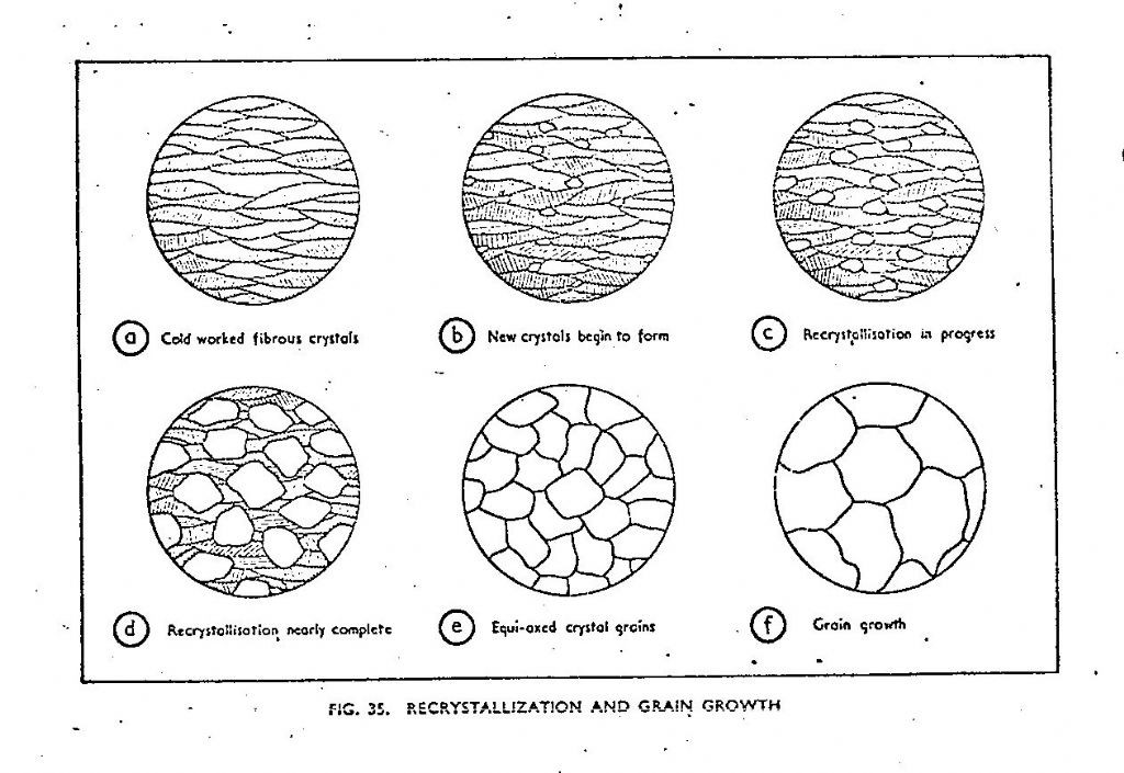

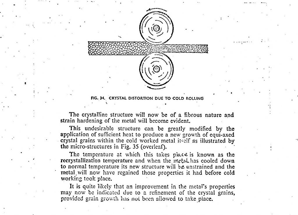

                  Hi Martin, if you are using bright mild steel, it is most likely to have been cold rolled, which alters the grain structure and causes stresses in the metals outer edges. This will happen to any grade or quality of steel, and can be cured by heat treatment at the correct temperature, which should be done uniformly and ideally in a temperature controlled furnace, and then cooled slowly but not excessively slow.
                  The temperature will be between 400-700 C depending on a few parameters Recrystallization Temperature of Steel. As JasonB has said, taking a little off each side at a time, will help stop bending. Hot rolled (Blue/Black) steel doesn't normally suffer form this problem though.
                  Regards Nick.
