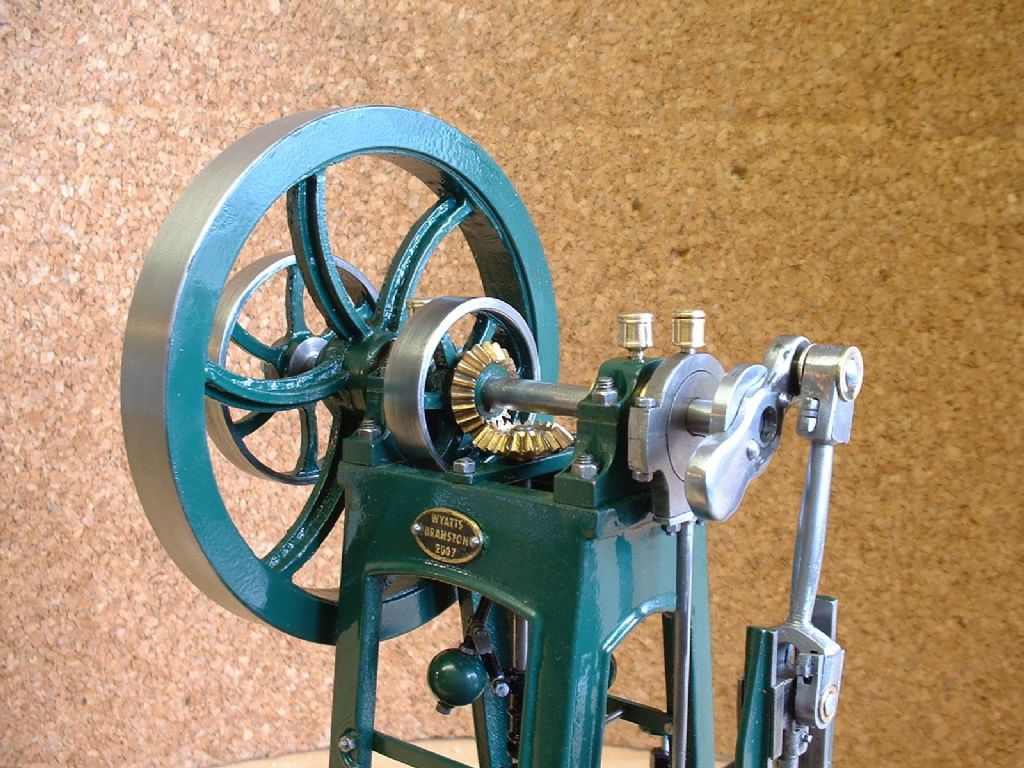

                                    Sub Mandrel
                                      @submandrel
                                      Hi Richard,
                                      I have managed to do tapered spokes, curved and ‘angled’ ones.  The patterns for the flywheel and pulleys on this model were made in aluminium on a rotary table:
                                      I also made the main gear for my crane this way:
