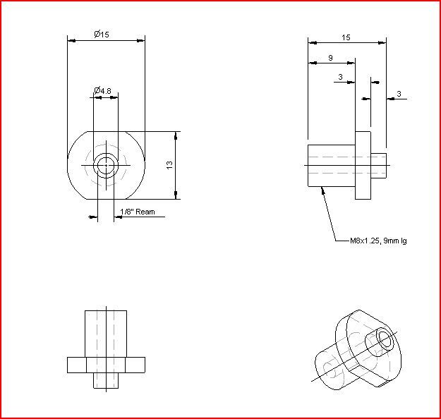

            The revised drawing for the pivot block (fig9) in 4452 seems to have got lost and the incorrect one printed.
            This is what the part should be like
            Also in part two teh smaller cylinders are shown as being tapped M6, these should have been shown as 5BA the same as the larger cylionders.
