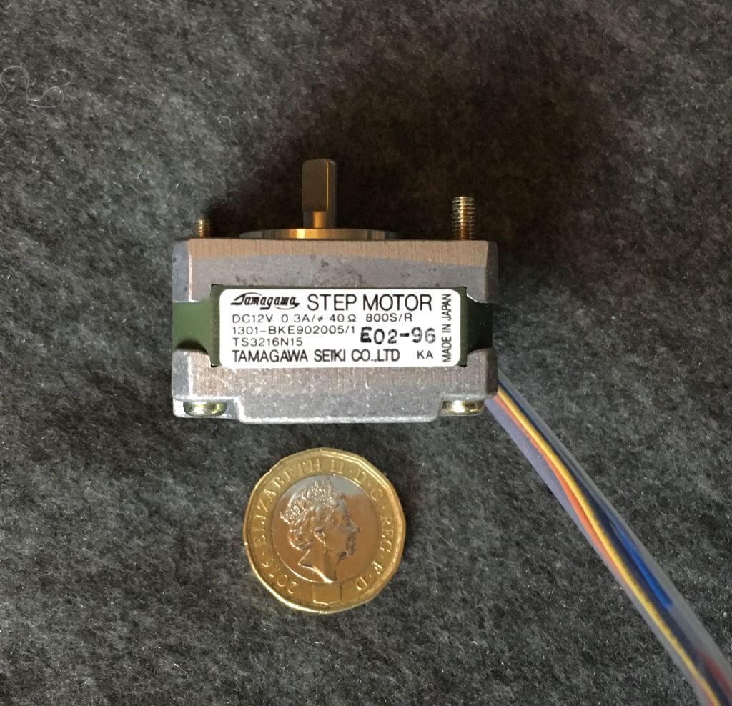

                                  It’s largely irrelevant to Duncan’s question, but I would just mention that it is possible to produce stepper motors with 800 step native mechanical resolution :
                                  A pair of these are destined for use on a microscope stage.
