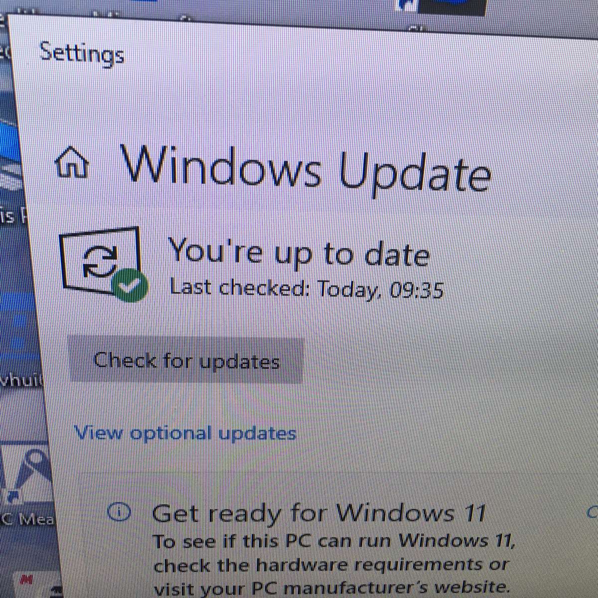

                So Micro$oft … What’s occurring here ?
                My ageing Dell Optiplex has been sleeping for a couple of weeks, with the LAN cable disconnected.
                Woke it up this morning and saw this:
                IMG_0513
                Which I considered incredible in the circumstances !

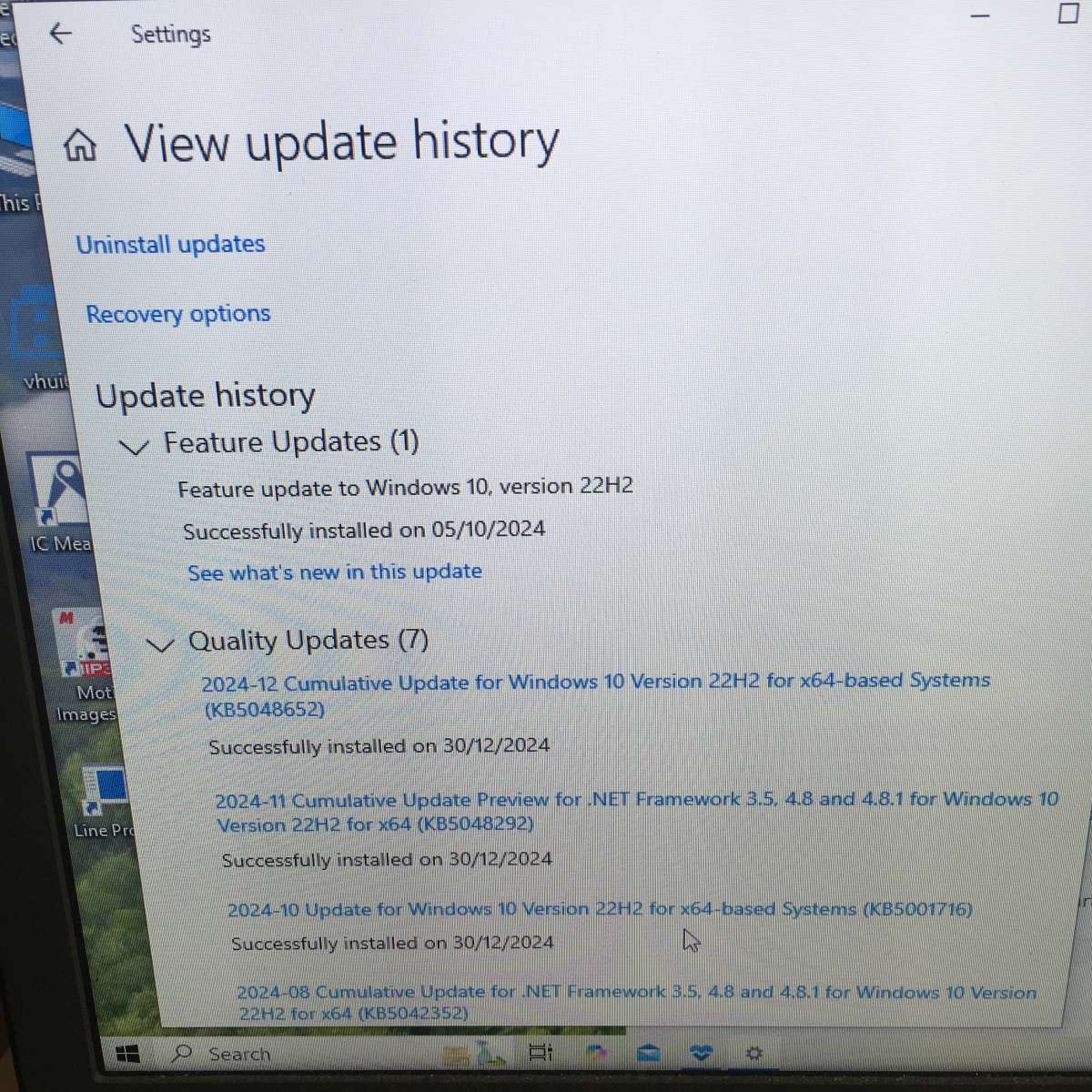

                So I viewed the update history:
                IMG_0515.
                In the light of recent postings, the reports are surely mutually exclusive.
                I will leave the forum pondering that, whilst I reconnect the LAN and potentially brick the machine.

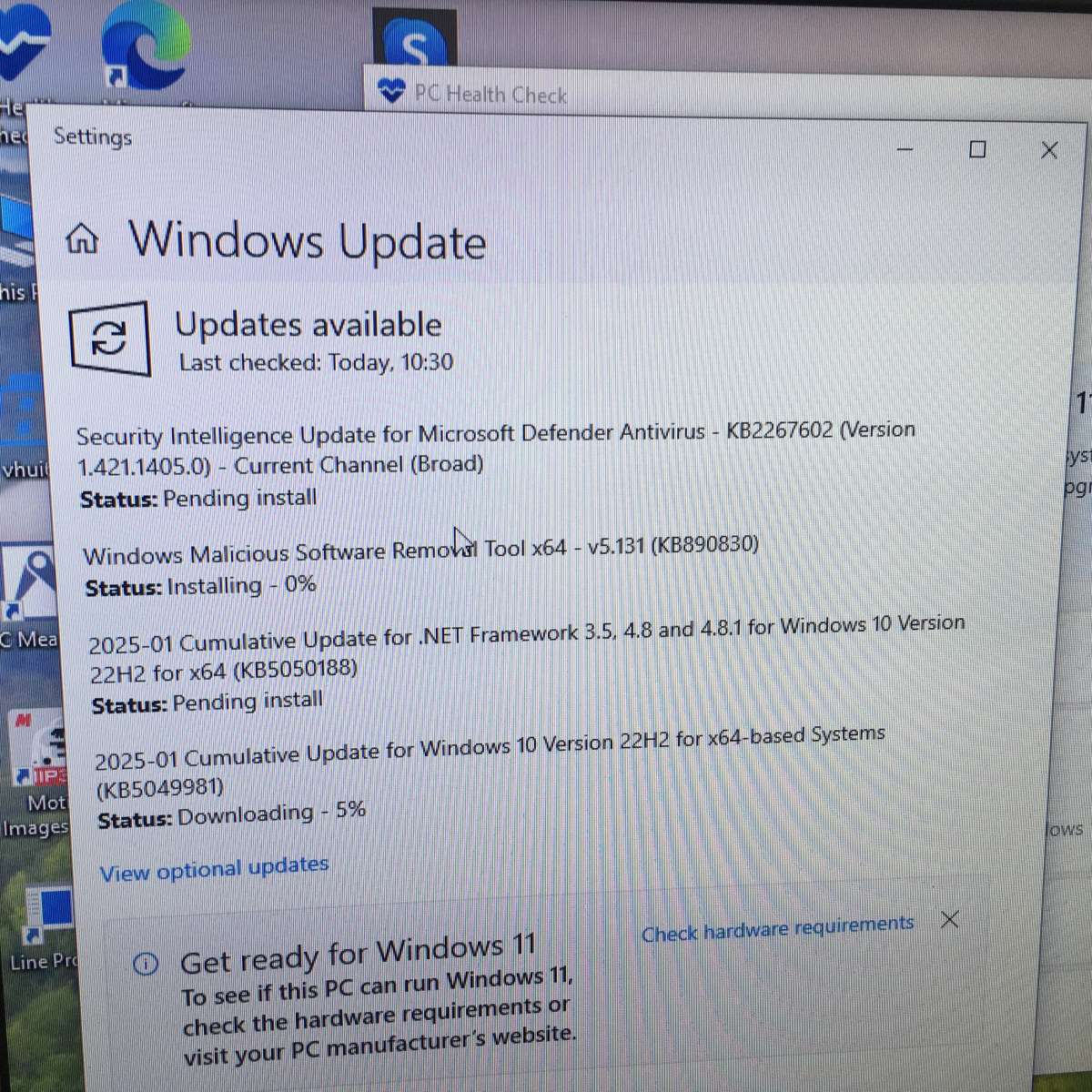

                  As if by magic:
                  IMG_0516
                  Mmm

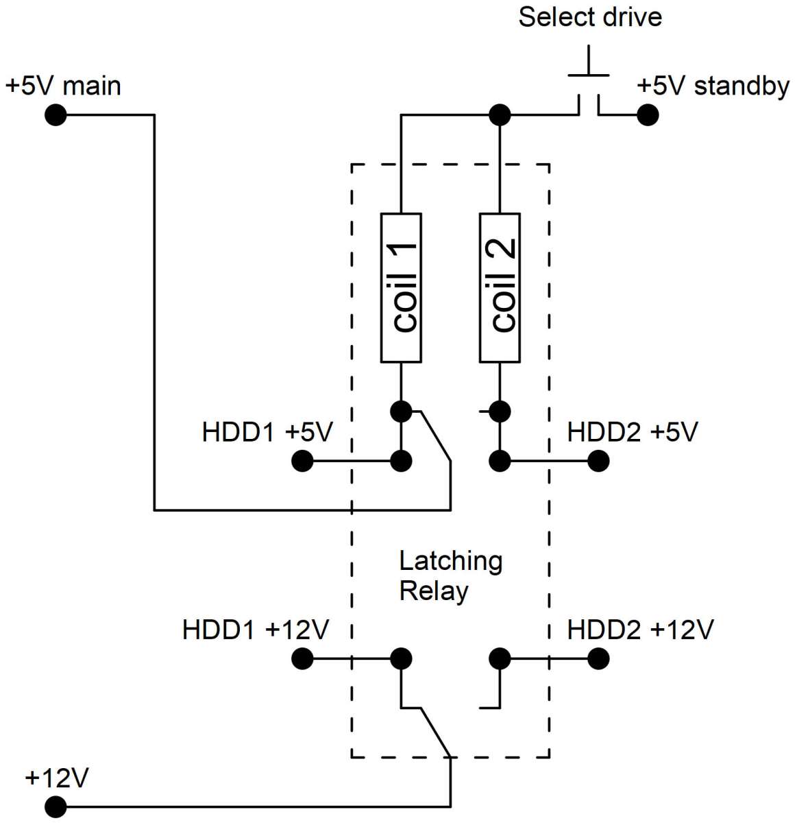

                                                    If using old fashioned SATA HDDs rather than current M2 form factor, here is a safe and convenient drive selector scheme for dual boot (using separate drives). I found it worked OK with SSD as well as rotating rust drives. You select the required boot drive by the changeover switch and push the button briefly. The latching relay is set to the choice. Now power up the PC, and since the +5 lines are now equal, it is impossible to change the selection until the PC has been switched off. Obviously you need to make up the necessary power harness, switches and double pole 5 volt latching relay.
                                                    It works because the power is required on a SATA drive to make it active and recognised by the BIOS. Both sets of data lines can be left permanently connected, only the powered HDD will operate.
                                                    Sorry diagram no quite right. Relay contacts go to SSDs, and a separate changeover switch sets the relay coil.
                                                    DualBootSwitch

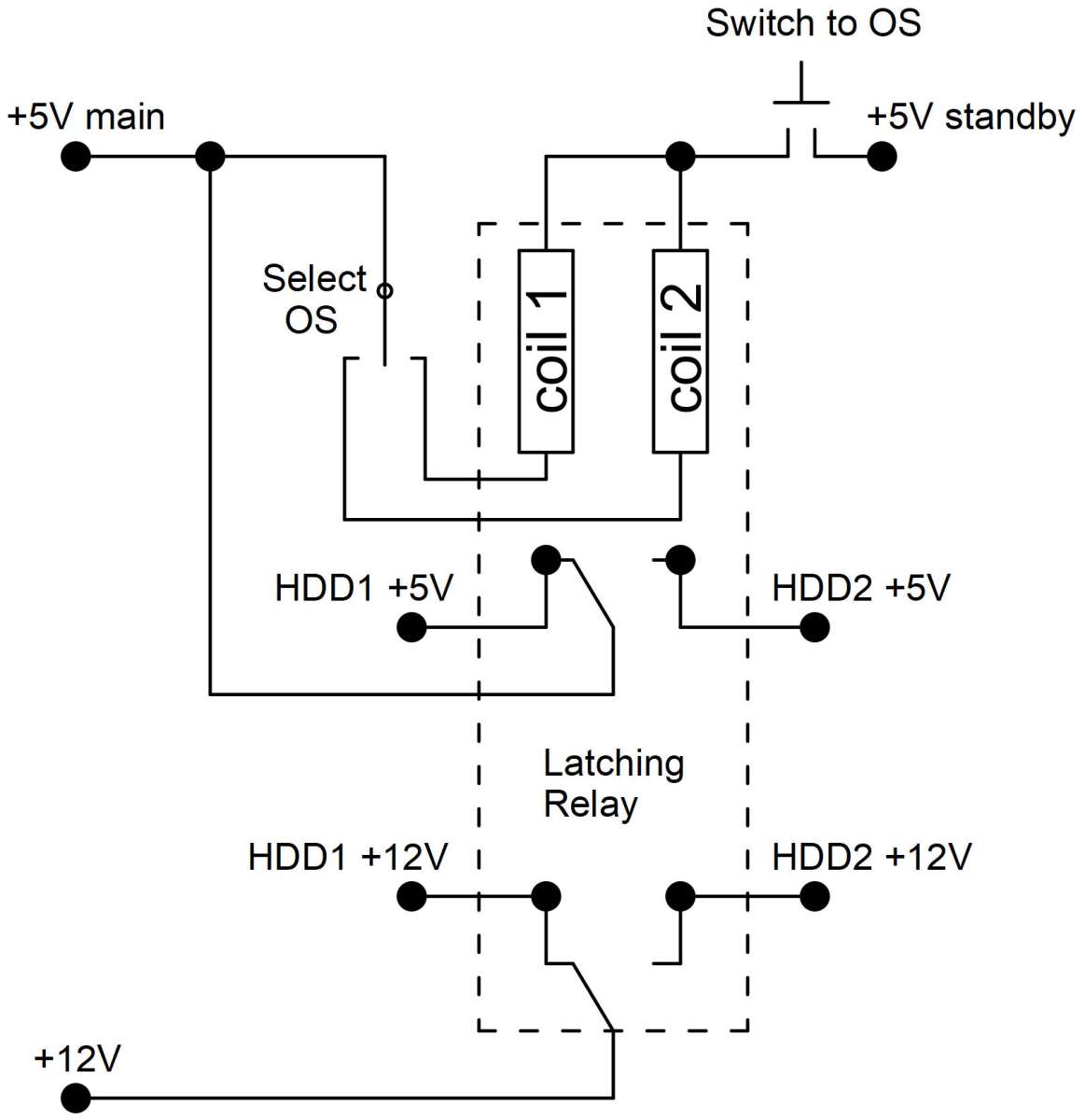

                                                      Sorry diagram was wrong, too late at night! If using two separate old fashioned SATA connection HDDs for dual boot, here is a safe and convenient drive selector scheme for dual boot (the current M2 form factor is not any good). I found it worked OK with SSDs as well as rotating rust drives. You select the required boot drive by a changeover or better a centre off switch, and push the button briefly. The latching relay is set to the choice. Now power up the PC, and since the +5 lines are now equal, it is impossible to change the selection until the PC has been again switched off. Obviously you need to make up the necessary power harness, switches and double pole 5 volt latching relay.
                                                      It works because the power is required on a SATA drive to make it active and recognised by the BIOS. Both sets of data lines can be left permanently connected, only the powered HDD will operate. The un-powered main 5 volt line is as good as ground for the current pulse applied to the relay coil. The latching relay shown has two coils, but an alternative type may have a single coil that is reversed to switch to the other state. This simply needs a two pole switch set up to swap over the coil.
                                                      Belt and braces is a good policy in this sort of design. While a three position biased to centre off will be fairly foolproof, the separate push button  makes mal-operation very unlikely. Clearly, switching the boot drive during operation is unlikely to end well! The scheme can be embellished to choice, for example LEDs to designate the OS in use. A red/green dual LED for this would allow designation of Port or Starboard operating systems.
                                                      DualBootSwitch
