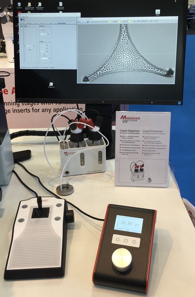

        But why ?
        The whole instrument comprises a standard optical microscope [of the inverted variety] with two Marzhauser stages attached and a digital camera system.
        The action of the Z stage can be considered pretty much in isolation, but; as its resolution is sub wavelength-of-light, it may be easier to consider the XY stage … This has a much coarser resolution, and larger movements, so it might be conceptually more familiar.
        Here's another photo of the 'interface'
        The diatom, imaged on the screen, is about 20 microns across
        The XY control [via the joystick] is 'pixel perfect' on that screen image … You can use the cross-hairs on the screen to select any point, and the stage will traverse to put that point centre-screen.
        This is not 'science fiction' … these are standard tools used in labs all over the world.

                That's an impressive image of the diatom, the details within it must be right at the limits of optical resolution.
                  Diatoms have long been used by microscopists, as a reference 'grid' to test objectives.
                  Klaus Kemp still supplies an 8 form Test Plate for this purpose: **LINK**
                  http://www.diatoms.co.uk/pg.htm
                  … and the best 'light microscope' images I have seen from it are by Osama Oku: **LINK**
                  https://micro.sakura.ne.jp/bod/typeslide.htm
                  Even these are completely blown-away by Scanning Electron Microscope images, of course; due to the difference in wavelength.

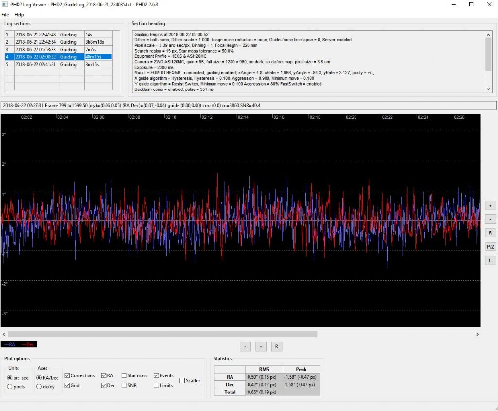

                            No, the GOTO capability is to within about a minute of arc, the basic limit on this is the accuracy of polar alignment. I can do this manually with assistance from a plate-solving routing to better than 1 arc-minute. A multi-star alignment can then make this even more accurate, but in practice once your GOTO is getting large stars within the centre tenth of the display there's no great benefit in refining it further. You can use plate solving and computer control to line up on target to almost any arbitrary degree of accuracy.
                            Tracking is 'guided' using a separate scope taking 1 to 3 second images, in which a 'guide star' is identified. Because even a small star covers several pixels the 'centroid' can be calculated to an accuracy of a fraction of a pixel, so the guidescope can be much smaller and rather faster than the main scope (which might be making 5-10 minute exposures). 2-2 seconds is ideal as it's long enough that distortions caused by poor seeing are evened out, but short enough to prevent excessive drift between frames.
                            Because the pixel scale and focal length of the guidescope/camera combination are know the actual movement between frames can be calculated and a 'root mean square' figure. On a good night this can be a little as 0.7" or even better, on a poor one nearer to 2.0". ) 6-0.7" is about the limit for my mount as it's limited by the resolution of the drive.
                            The guiding software (PHD2) constantly monitors and logs performance, you can view the logs in a viewer. Here are 40 minutes of pretty much perfect guiding. The graph looks terrible, but actually virtually the whole trace is within +/1 1 arc-second. This is with my longer guidescope that has a smaller image scale which I use with a 1200mm scope which needs better guiding than my usual scope.
                            Ideally you want it to be no more than pixel scale of the scope, typically 1.7" per pixel with my usual setup.
                            You can do a lot of optimisiation if you really want, but there are more variables than you can shake a stick at from optical resolution of different scopes to the seeing quality.

                              Thanks for the clarification, Neil … That makes sense.
                              My misunderstanding … I latched onto your phrase 'starts in real time'
