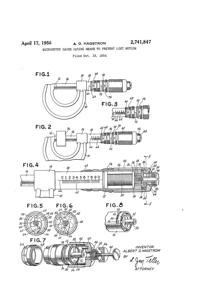

          Looking at the drawing further, I would say that those left hand sections of the coarse and fine thimbles with the narrow band of knurling are not in fact locking rings, but are used to calibrate the numbered dials to 0 when the anvil faces are together. So scratch the idea of trying to see if they are a locking ring that can be rotated. All that wil ldo is throw the reading out of calibration! Stick with the microscopists' experience of gummed oil locking their focussing thingies up and continue soaking with degumming fluid/s of choice. The suggestion of heat might help too. A bit of gentle warming can't hurt. Hair dryers work well.
          #627549
          john halfpenny
            @johnhalfpenny52803
            Do not trust patent drawings. They may show the exact product, but since patent specifications are prepared at a very early stage and typically do not change, the drawings will not reflect developments and production engineering. I have written enough to know.

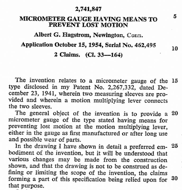

                          For what it’s worth …
                          I am pretty sure this is the second Hagstrom patent relating to the Starrett 221
                          **LINK**
                          https://worldwide.espacenet.com/patent/search?q=pn%3DUS2741847A
                          i.e. the improvement that Starrett asked him to make
                          Edit: and just to emphasise the excellent point made by  john halfpenny:
                          Edited By Michael Gilligan on 04/01/2023 20:19:18

                              That motion amplifying lever mechanism certainly is a fascinating one. I still can't quite get my head around how it works exactly, even after reading the description on the latest patent MG linked to. Sounds like setting it up could be very fiddly for uninitiated so best to continue with the soaking. It does look as though if you remove that screw that holds the spring loaded knob on the very end of the thimble, you could dribble a little Plus Gas or Petrol or whatever down the tiny hole the end of the spring fits into and goes all the way through, and perhaps help the cause.
