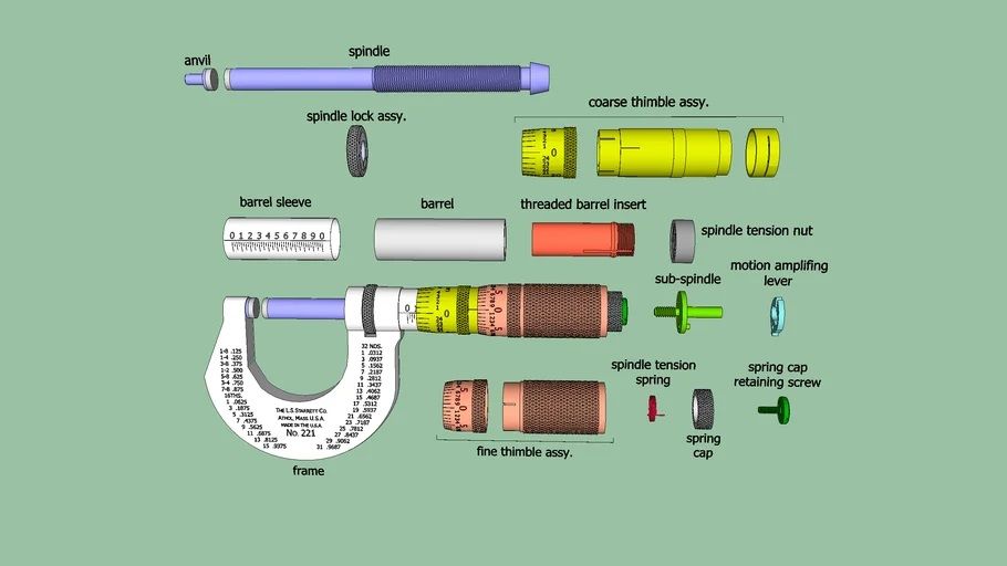

      this little micrometer came into our possession along with some other engineering stuff, it has an unknown history
      It seems quite accurate in comparison to other ones that we have. However part "A" does not move separately from art"B" and there is no torque release (normally you can only tighten a micrometer to a certain tightness, as I'm sure you will all know)
      Not sure what the screw spring assembly does on the end.
      I feel the whole thing is jammed, some release oil has not helped – so before I start to use some real effort to turn "A" with respect to 'B'. Has anyone got any suggestions or knowledge of this micrometer, and how best to proceed – I don't want to make things worse

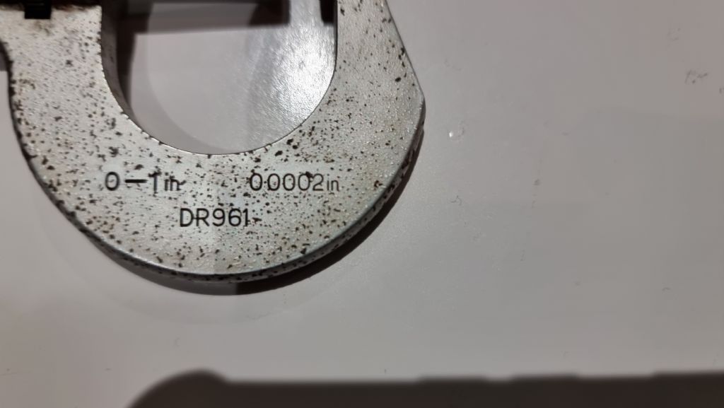

          #627454
          DC31k
            @dc31k
            The 221 stamped on it is the Starrett model number
            Google 'Starrett 221 instructions' and follow some of the links.

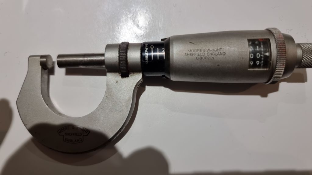

                          When i saw this thread I thought i had one. But it is different & not Starrett. It is a Moore & wright ModelDR961.
                          I think it works the same though. Anyone know.

                            Steve,
                            I think you would find it is a geared system. I have the metric version.

                                            Ah, ok, so it's the actual interface between the one thou main thimble and the tenths of a thou secondary thimble. Which would have to be some kind of friction drive so that when you turn the main knurled area on the tenths thimble, it turns the thou thimble, which must be hard mounted to the spindle in some way.
                                            A drawing of how that is done would be muy helpful. Perhaps MG's suggested patent application drawing? No idea on how to look that up. Ask MG.

                                                  Hopper
                                                    @hopper
                                                    Here you go. I have not had time to study it in depth and figure out exactly how it all works.
                                                    But the first thing that jumps out at me is that the fine thimble is in two pieces and one has a slot in it like it is meant to clamp down on the barrel it rides on. Is it possible the left hand part of the fine thimble with the narrow band of knurling on it is a locking ring of some sort? Maybe try holding the wide knurled right hand half and see if you can "unscrew" the narrow knurled band left hand half.
                                                    Or ditto with the narrow knurled band at the left hand end of the main coarse thimble. IT also is a separate piece.
                                                    Note that the main spindle does not go right through but has a sub-spindle that screws into the end of it, and a "motion amplifying lever" whose functioning I have not figured out. But it means you cant release the main spindle by tapping on the end to release if from the taper until all the fine measurement parts have been removed — somehow!
                                                    EDIT
                                                    And here is a tiny pic of that motion amplifying lever from the Practical Machinist forum. Looks like you must be able to remove the fine thimble to gain access to it. No idea how though!
                                                    Edited By Hopper on 04/01/2023 10:41:50
