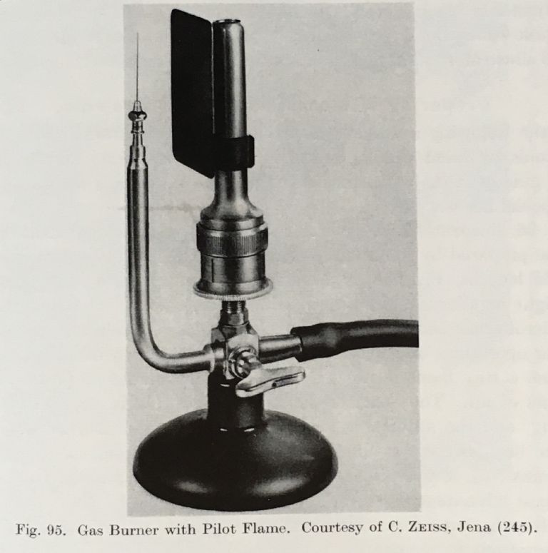

              #313774
                As promised …
                extract from 'Micromanipulators and Micromanipulation' by Hamed El-Badry, 1963
                Micromanipulator tools are usually prepared by the experimenter who uses them and makes them in accordance with specifications considering his own special needs. It is therefore very important that the operator masters the techniques of preparing the tools he needs, especially because such tools have to be frequently replaced because of their delicacy.
                Simple glass microtools may be prepared by hand with the use of a suitable microburner. Accurately reproducible fine micropipets and needles may be prepared mechanically by means of needle and pipet pullers. A great diversity of microtools of unusual shapes may be most precisely and conveniently prepared under microscopic control by means of microforges. These methods, together with the necessary apparatus, will be considered in turn.

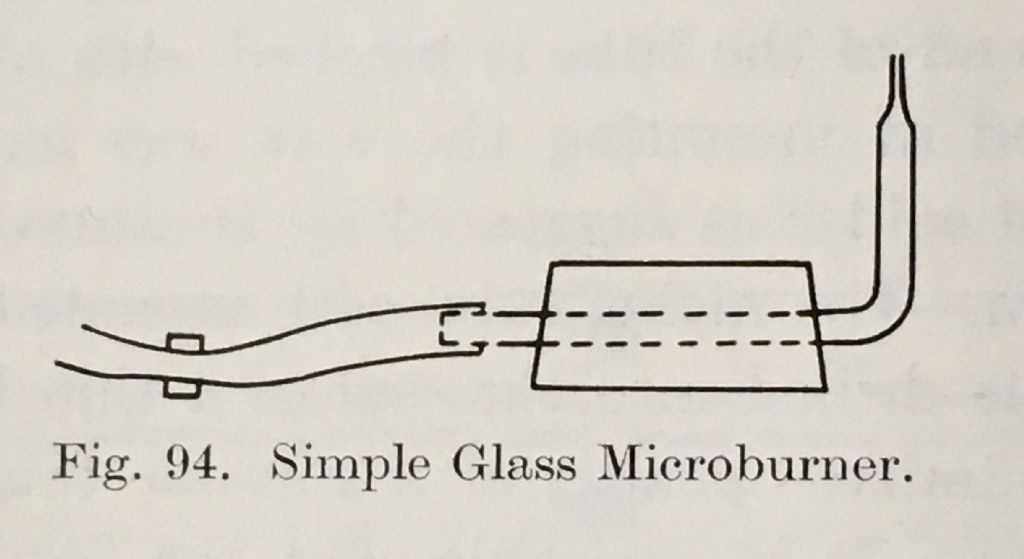

                #313775
                  a) Hand Drawing.
                  Simple glass micropipets and microneedles may be drawn out by hand from a stock of glass capillaries or threads, usually of about 0.8 to 1 mm in outer diameter. This diameter is usually determined by the opening of the tool holder into which the microtool is to be inserted. The capillaries and threads may be drawn out from pieces of soft glass tubing and rod varying from about 4 to 8 mm in outer diameter (3 to 6 mm bore) in the flame of an ordinary Bunsen burner or of a Meker burner if hard glass is used. The large flame of the burner shown in Fig. 95, is also suitable for drawing capillaries from glass tubings. The capillaries produced are cut into the lengths required for preparing the microtools to be made.
                  Further operations for making pipet and needle points are carried out over a pinhead flame supplied by a suitable microburner such as those described below.
                  Microburners.
                  A simple and serviceable microburner is shown in Fig. 94. It can be easily constructed from a length of hard glass tubing of about 5 mm internal diameter. Over a narrow flame, one end of the tubing is drawn out into a capillary of approximately 0.5 to 1 mm bore. The capillary is then cut at a point approximately 7 to 10 mm from the original tubing. The tubing is bent at right angles at a point 4 to 5 cm from the drawn-out portion. The wide end of the original tubing is simply inserted into a large rubber stopper which has been bored diametrically to receive it. The stopper acts as a base for the microburner as shown in the figure. The wide end of the glass tubing is connected to the gas line by means of a soft rubber tubing. The gas supply can be regulated by means of a screw pinch-cock clamped on the rubber tubing so as to give a microflame as small as a pinhead.
                  A similar glass microburner, but with an orifice in the form of a narrow elongated aperture, was used by CHAMBERS (54, 55) for preparing microdissection needles and micropipets. The tip of the burner was made by pinching one end of the glass tubing, softened by heat, with a pair of forceps so as to close it except for the narrowest possible aperture that would retain the flame. The burner was connected with an acetylene generator or, preferably, a small compression tank which could be recharged at a small cost. CHAMBERS recommends the use of acetylene rather than ordinary gas because, with acetylene, a narrow flame can be obtained without
                  clogging. Ordinary gas may be improved, if necessary, by passing it through alcohol or benzene.

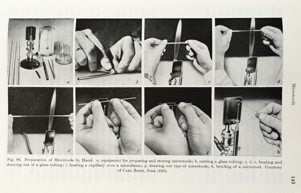

                  #313776
                    A simple metal microburner may be made from a hypodermic needle soldered to a short length of brass tube (228). A useful, commercially available (245) burner is shown in Fig. 95. The main burner yields a large flame suitable for drawing out glass tubing and rod into capillaries and threads. At a distance of about 3 cm from the main tube, the burner is equipped with a narrow pilot flame tube giving a microflame which can be regulated to the desired size. The pilot flame tube has a conical orifice for inserting a hollow needle similar to an injection needle. The microburner is supplied with two needle canulae of different internal diameter.
                    An adjustable black screen attached to the main burner tube serves as a suitable background for observation while working over the microflame.
                    Fig. 96 illustrates the use of this burner in preparing microtools.

                        Looks like my thought that a soft flame would be enough to heat such a fine piece of glass was about right. Suppose its a bit like holding fuse wire over a candle which will make it red hot but the candle would not get a 4" nail red hot.
                        Thanks for the extra pics.
