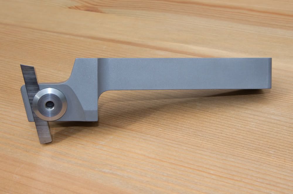

                                #646736
                                Vic
                                  @vic
                                  This is my tool holder from ten years ago. It was very straightforward to machine. The work on the clamping side including the drilling was all done in one sitting.
                                  #646917
                                  Grizzly bear
                                    @grizzlybear
                                    Hi Vic,
                                    That's very nice, a masterpiece no less.
                                    Bear…………
