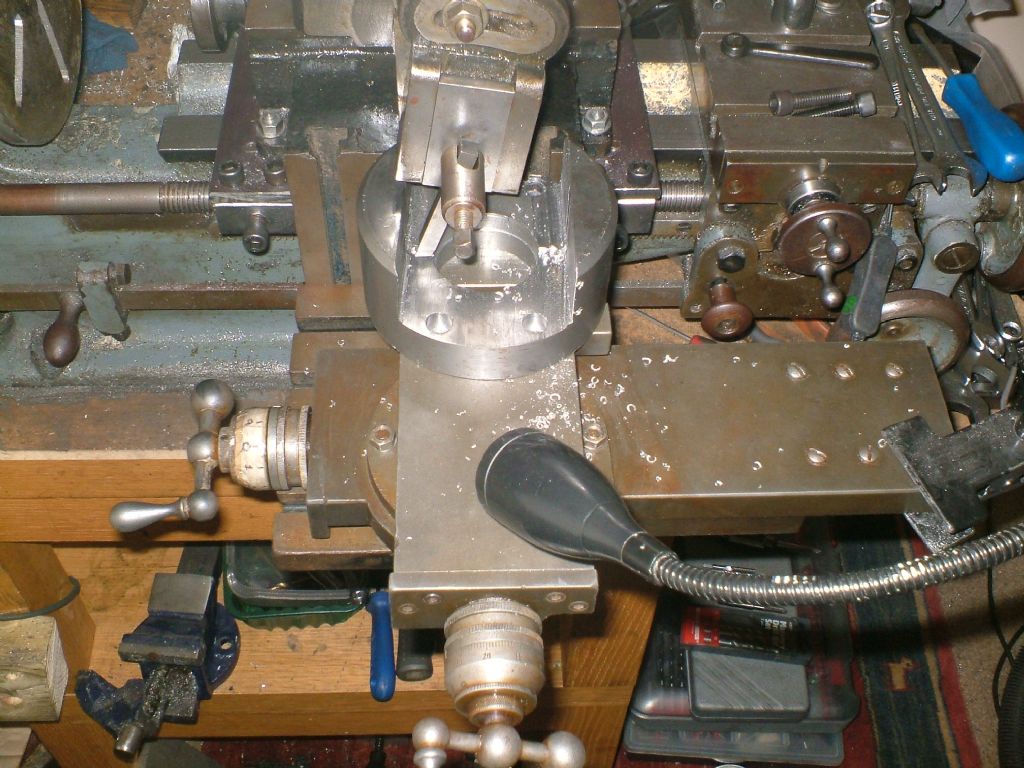

      Ady-your post at 6.00:12. Great computer graphics. What platform are you using ? Never come across one yet that simulates workshop grime so realistically altho I still prefer actual photographs.

        ady
          @ady
          The vertical shapers, which are usually big slotting machines, can also do accurate profiling work.
          Studying some of these “old” machine tools can be a bit of an eye opener once you realise what they can do.

            ady
              @ady
              An update from previous.
              I fixed the spindle keyway…and the bang, although much reduced has moved to the slight play I have in my backgear so the rubber band damping system stays put for the moment until I come up with tight backgear or a proper damping system.
              The other change is a couple of slideways I have put on the Adept table to improve speed and convenience for moving the job around.
              Setting up on a shaper can take up a lot of time on a bigger job, it’s quite fiddly and restricted.
              With these slideways after setting the job square I can now whizz the job around with the shaper running.
              Cuts have to be only slightly lighter than on the fixed table but it’s not a heavy duty high torque unit in any case, and the added convenience of moving the secured workpiece about at will is a huge bonus.
              This also means the unit now has access to two compound angles and works conveniently in three dimensions, so making a tapered jib from solid bar without resecuring the workpiece for example becomes possible.
              …and did I also mention that It’s a lot of fun too…it sure beats milling.
