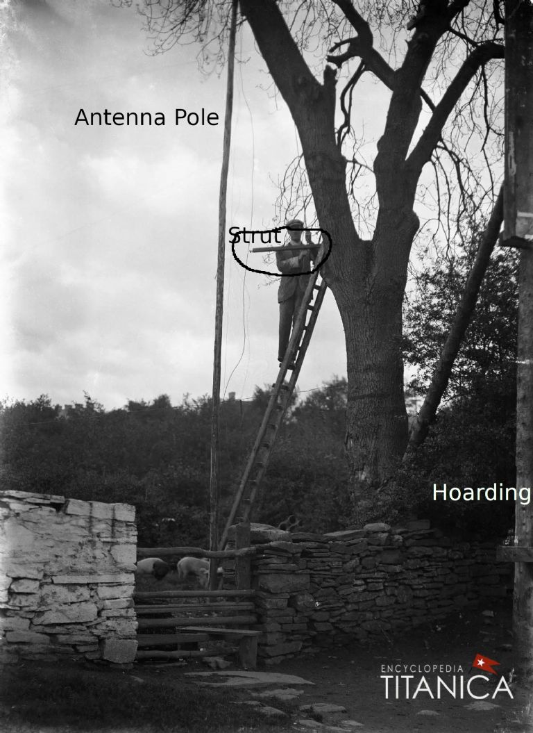

The case for the defence requires Artie to have a substantial antenna, and Julian's photographs contain some tantalising suggestions that he did! It's necessary to zoom in and look for details.
First, here's Artie up a ladder, implying a tree is supporting the antenna:
Artie is adjusting the Antenna, which is supported by a Pole, not the tree. He's nailed a strut to a branch with an insulator on the far-end, and is holding a wire coming from the top of the pole. The purpose of the strut is to carry the wire around the tree. I guess he's either about to attach the antenna wire to the insulator or has just removed it. Look closely, and there are 4 vertical wires going towards the pole top, plus a horizontal wire just below Artie's feet. The aerial isn't in the tree, and it's somewhat elaborate. Work is in progress – the wires aren't supposed to dangle – so the configuration can't be confirmed.
Note the hoarding edge on the right because it appears in the next picture.

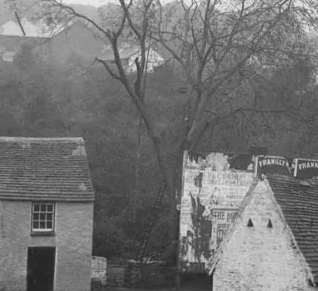

At first sight, the next photo looks like a simple shot of the mill, and I guess that's Artie stood above the mill-wheel:

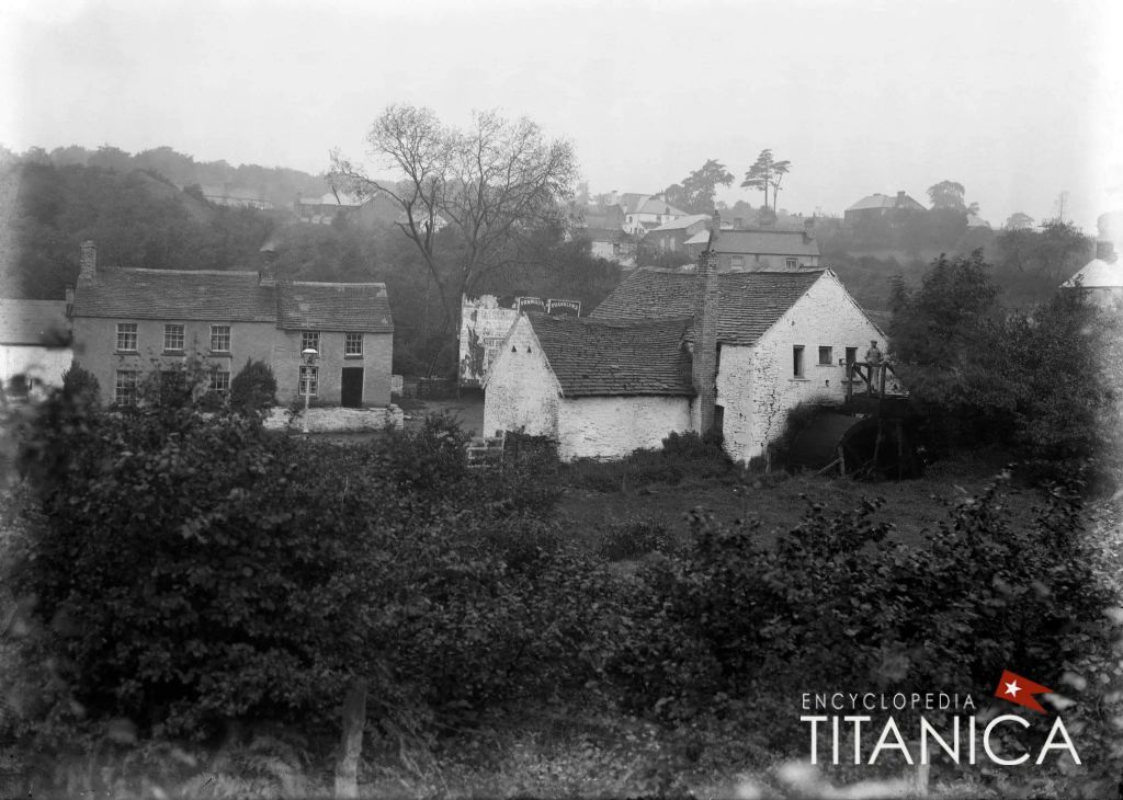

I think this shot is a failed attempt to photograph the antenna, not a picture of the building. The antenna is hard to see because thin wires are lost in the background. However, the hoarding can be seen behind the mill, and zooming in reveals Artie's tree and ladder:
The pole and ladder can be seen, plus a wire that appears to climb high over the roof of the mill:
And there may be a second wire climbing in the opposite direction. Possibly Artie is improving the antenna by lifting the incoming ends to the top of a pole next to the tree, rather than to a strut near the base.
I'd guess the shack is somewhere near the tree, perhaps behind the hoarding or the buildings opposite the mill except there's no sign of a building with a strange roof.
Not conclusive, but I think Artie's antenna was quite big, and as we all know, size matters…

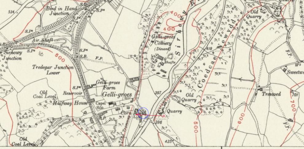

Thanks Phil, though the size of the antenna is disappointingly small! Julian says radio reception is poor at that location, which makes sense in the bottom of a valley. I was hoping to find Artie had used the geography to fit something bigger in.
This is a clip from the 1916 6" map. I've ringed the mill with a blue circle and shown the likely position of the photographer and his line to Artie's tree with a red X and arrow. (Not very obvious – look in the middle bottom area)
Unfortunately the mill is located near the corner of the OS maps, but this clip of the 1916 6" map gives an idea of the ground available, maybe!
Generally the area shows considerable evidence of early coal-mining in decline; shafts, 'Old Coal Levels', railways, a tramway and much disturbed ground. The old tramway leads to the Gelli-groes colliery, marked as disused in the 1879 survey. The field containing the tree is a few hundred feet long, but Artie might also have been able to use the spoil heap on the other side of the tramway. Over the river behind the mill there's a quarry and an area of rough ground, then fields. The site has potential for a large antenna: quite a large area of rising derelict industrial land, where no-one would mind a few tall poles and some wire.
Another bygone, just south of the mill the map marks an LH. This is a Lamp House, or street-lamp. In 1916 this was the only street lamp in the area, and important enough to be recorded as a feature. Be interesting to find out why the lamp was installed at all. My guess is serious crime. When South Wales was booming in the heyday of Welsh coal, and rife with social injustice, it got pretty wild at times.
The 1938 map shows the chance has gone. The old tramway has become the A4048, much of the industry has been tidied up, and there's been a fair amount of development. In 2023 the locals would blow a gasket!

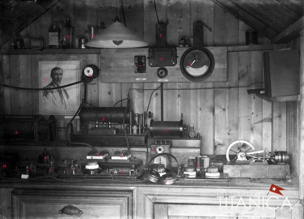

I've had a look at Arties shack and identified some of the stuff, sorry about the tiny red letters!
On the extreme right is a shelf with documentation and probably the station log. There's no clock, so expect Artie owned or borrowed a pocket watch. There's an electric light, so I expect the shack was operated during the night when long distance reception improved.
Below the shelf on the right is a model horizontal steam engine, presumably the prize winner.
Starting from left middle:

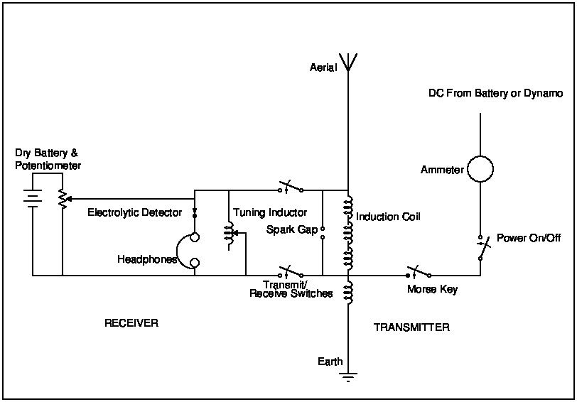

If anyone fancies building a replica, the is apparatus wired up something like this circuit:
Left out: the extra switches in the photo probably do things like connect the dry battery, disconnect the headphones, and short out the receiver. Also, I've shown the tuning inductor as a tapped coil when Artie probably had two coils, one sliding inside the other.
To receive:
To transmit:
There are a few Health and Safety issues:
Impressive I think, and quite a lot of it is home-made.

Do you think that Artie's set as per the pics of early October 1911 for the Daily Sketch was any good?

Do you think that Artie's set as per the pics of early October 1911 for the Daily Sketch was any good? Could it have possibly been only to transmit/receive messages to the other set of Richard Jenkins at Ty Llywed farm much higher up?
Well, not bad for the time. It's not that different from recreations of the Titanic's Radio Room, apparently based on that fitted to RMS Olympic, a sister ship.
The transmitter's induction coil is about the same size, but I think this is a small backup transmitter. The big iron was in an adjacent Silent Room, heavily soundproofed because of the noise made by a power spark. Rather than a pair of brass balls, these had spinning rotary gaps with compressed air to keep them cool and quench the arc. Artie might have had a 100W, compared to a kilowatt or more on a ship.
The Titanic's receiver is considerably better than Artie's: the Titanic had a reliable magnetic detector and tuning.
What makes the biggest difference is the aerial and 'conditions'. Small low aerials are very inefficient, and a poor earth soaks up power. And an efficient radio earth is far more elaborate than that needed for mains electricity safety or lightning protection. The geology makes a big difference and the earth itself is a large copper mesh, hundreds of metres across.
As Artie's receiver had no amplification, his headphones were driven entirely by the energy picked up by the aerial. A small efficient aerial would only work with strong signals, which isn't impossible. Early radio men noticed many anomalies. Although reliable spark range varied from 75 to 300 miles during daytime and 600 miles at night, it wasn't unusual for much longer distances to be covered. Turned out that radio waves sometimes bounce repeatedly between ionised layers up to about 300km high and the ground. Instead of disappearing into outer-space at the horizon, they're bounced back to earth again from a great height, coming back down thousands of miles away at considerable strength, perhaps skipping several times. Skipping is most common at high frequencies, but Artie may have been lucky, or his antenna picked up a short wave harmonic.
