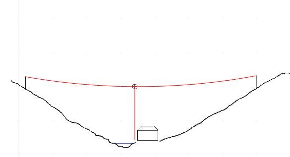

                                            Artie Moore's aerial and its location are important, because a short length of wire strung in a tree wouldn't have collected enough energy to trigger a coherer unless the transmitter was nearby.
                                            The Titanic (and other ships) transmitted on two 'waves': 600metres and 300metres long. 600metre for long range, 300metres over shorter distances. The smallest efficient antenna is a ¼ wave with a good earth, ideally a 150metre tall vertical. (About 500ft high.)
                                            The first requirement then is for a lot of space and a good earth. I think Gelligroes Mill provided both. It's located in a wet valley bottom, and it would have been easy to get permission to put masts up and run wires over adjacent land – agricultural, maybe wild.
                                            A 150 metre tall antenna is serious engineering! But the mountains provide height, albeit with screening. Also, although it increasingly reduces efficiency, it's possible to reduce the size of an antenna by loading it capacitively and/or inductively. So Artie had the opportunity to erect an efficient long wave aerial, something like this T-antenna:
                                            Most of the radiation is off the vertical section, which is connected to a good earth at the bottom. Wet alluvial soil at or near a stream is much better than the top of a rocky mountain. Although the horizontal top of the T is made of wire and might be assumed to be an inductor, it mostly puts a largish capacitance between earth and the top of the vertical section. At the time this was a well-known configuration, usually implemented on a smaller scale on ships by suspending the T between the masts and dropping the vertical to a radio shack behind the bridge: I think the Titanic had a T-antenna, in her case the excellent earth being provided by the sea.
                                            Usually long wave transmitting stations were located on flat ground so the antenna had a clear take-off. But I don't think mountains are quite the brick-wall at long-wave that they are to high frequency signals. Criggion Radio Station was located in a deep Welsh valley between mountains. It transmitted to submerged submarines on Very Long Wave (about 18000metres). I guess the height of the mountains and low cost of land made it cheaper and easier to build the very large antenna needed. Remote mountain valleys are also electrically quiet – no VFD powered lathes for miles!
                                            Grimeton Radio Station in Sweden is operational on special occasions, transmitting on 17400metres with an Alexanderson Generator, no electronics. Most impressive. The antenna is is over 2km long and strung between six 127metre high towers, on flat ground near the coast. It's too small to be efficient…
                                            Even though the Gelligroes Mill area must have awful reception today, I think was a good site for receiving Atlantic ship-shore radio signals in 1912. Not ideal, but much better than most locations. Not many places in England with the same opportunity for an affordable installation.  1912 was the first year that triode valves were used to amplify radio signals by anyone, making it very unlikely that Artie Moore had that technology. To hear the Titanic his receiver needed a really good antenna, and it's possible Gelligroes Mill provided what was needed for him to erect one without costing a fortune.

                                                Dave, (SillyOld Duffer) makes some very interesting points about the aerial, but I have lots of problems with this.
                                                Firstly, I suppose is local knowledge of the geography and poor radio and ordinary television reception as Ynysddu and Gelligroes are in the 'dip' of The Valley, although 400 feet up the surrounding mountains/hills are a further 300 feet up.
                                                Secondly, the 1911 Daily Sketch glass plate negatives the photos of which show only a rudimentary aerial affair for Gelligroes Mill – or more specifically to Artie's wooden shed containing his wireless telegraphy set.
                                                Thirdly, there was another possibility, and that was Richard Jenkins who 2 and a half miles away lived pretty much on top of the mountain at Ty Llywed farm with another wireless telegraphy set, and he did have a large proper aerial as can be seen in one of the glass plate negative photographs.
                                                Fourthly, I cannot see at all how Artie could have strung a copper cable at all further up The Sirhowy Valley here. The Moggridge Estate owned most of the land around here and then the Penllwyn Estate. He would have had to have crossed the old Penllwyn Tramway (now the B4251 road) and what was then the local road on one side, and on the other side the LNWR railway.
                                                I've tried to fathom a way of easily showing these pics, but my computer skills are somewhat lacking transferring pics these days, so probably the easiest way for those interested is to direct you to the following link:-
