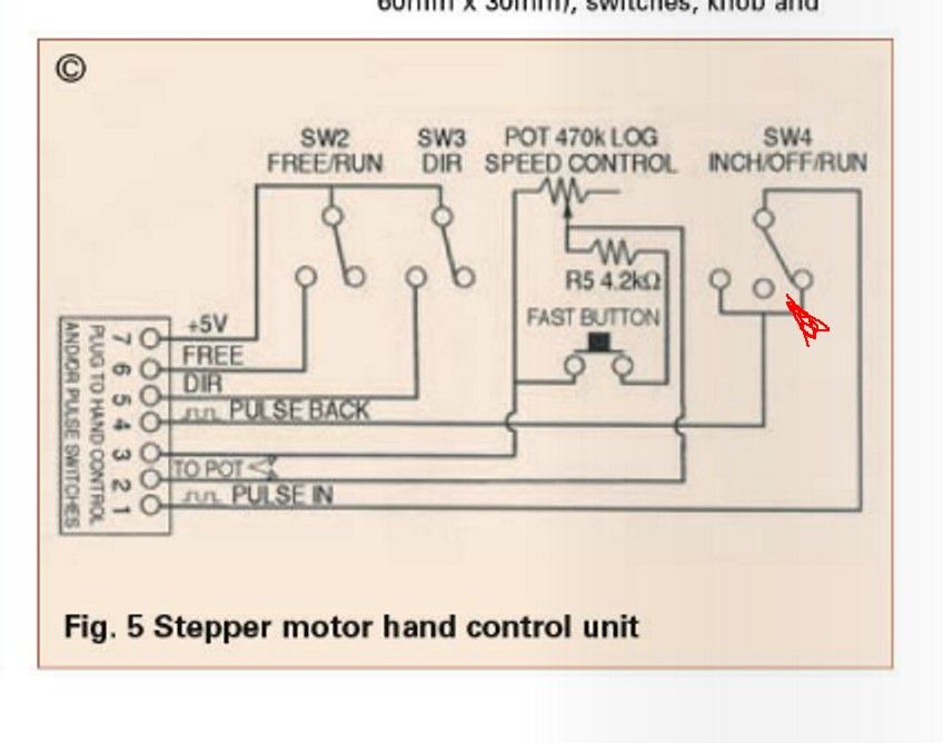

        Hi All,
        I constructed the stepper motor electronic project as shown in MEW issues 118-119 and redesigned the attachment to fit the Warco type WM14/16 milling machine.
        This conversion has work great for the last 5 years, i am at the moment doing a strip down clean,adjust and adding an Ardunio wifi dro upgrade to the mill.
        One modification i would like is to incorporate end stop switches. I am not an electronics expert so i am not sure how to achive this, if it is possible.
        Is there someone who could advise
        Thanks

            I used microswitches and relay for end of travel and stop switches on my mill table drive. Seemed better to rely on hardware for something that has got to work or it gets expensive. Arduino takes care of speed and ramps. Might not be applicable to your situation but send me a pm if interested

                Fit microswitches at each end, series the normally closed contacts of both , and feed the stepper pulse through these contacts to the stepper driver. When the uswitch is activated, the contact opens and the pulses no longer reach the stepper driver, so the stepper halts. Then you need to fit a momentary ( push-to-make) switch across both microswitch contacts, so that when you press it, it allows the stepper pulses through again, so that you can back the axis off of the activated microswitch. Once the microswitch is no longer activated you release said push-button and carry on with normal operation.
                Doing it in the software would alleviate the need for the pushbutton, and you would then just connect the microswitch contacts to a processor input port and when the software sees the contact activate, it stops generating stepper pulses, basically halts the axis 'feed'. Then the software would disallow further auto-feed motion, till the axis is backed of the switch position, and the switch contact becomes inactive again.

                        Can i first say that the Ardunio DRO upgrade is a totally independent DIY upgrade/project and has no association with the power cross feed. I have just stripped the mill to add this DRO so now would be a good time to do any more upgrades.
                        I would just like to limit add switches at the ends of the travel for safety. I do quite a lot of long passes and get distracted easily.
                        My problem is where in the MEW circuit can i add the switches without harming the controler etc. Do I just cut power to the controller or is there a better circuit option.

                          I have looked into Mikes stop system and that is just what i would like to add.
                          And if my power cross feed was an conventional electric motor it would be fairly straight forward.
                          Having a controller with stepper motor attached I am not competent with electronics to decide the best way to break into the circuit to achieve a safe solution, i.e a gentle circuit stop with damaging any electronics.

                            I think the simplest solution would be to wire two stop microswitches in series and use them in series across a break in the wire I have indicated in the handset.
                            Although this means at least one more wire in the handset cable, this will stop the travel in 'run' mode but allow you to inch the feed (in either direction).
                            Alternatively just break the pulse wire inside the unit, but then you will need to manually move the feed back from the stops.
                            A better but more complex solution would interact with the direction switching so you could reverse out. One way would a relay operated by the direction wire to choose between two microswitches so the stop only works in the appropriate direction.

                              Thats what I’ve lookin for, stopping the travel the change direction on the handset and press inch until switch is overriden.
                              Although i can build a project i could have looked at that circuit for a year and still not seen the soultion.
                              The MEW stepper cross feed has worked great over the years but this addition will just give me piece of mind during a long slow cut.
